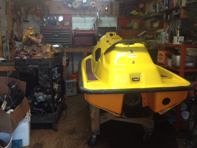

Gonna be real cold here for a while so I moved it indoors where I can have a heater at my feat. Now this is a tool shed full!
No this is at work and it needs thinning. Setting up the new place will make some much needed room in there.

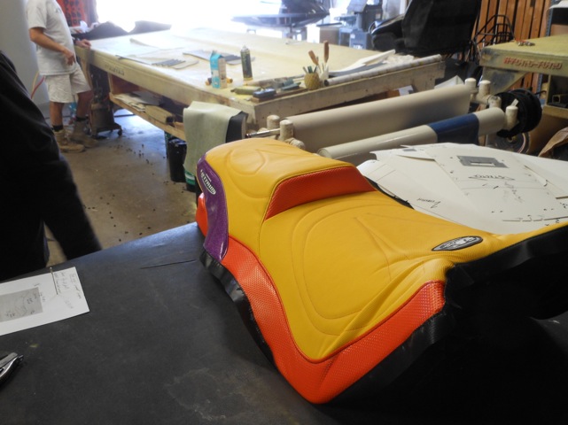

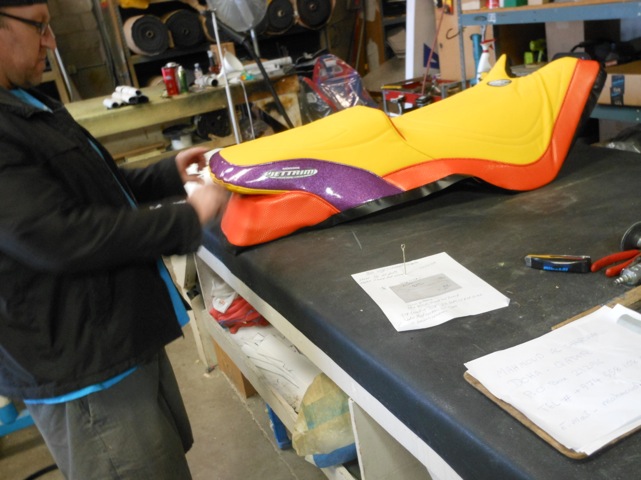

The mats are made by Jettrim. They are making me a new set that will have the rear piece as well. I'm really excited to see the seat they made for it, hopefully tomorrow they will send a pic of it finished.

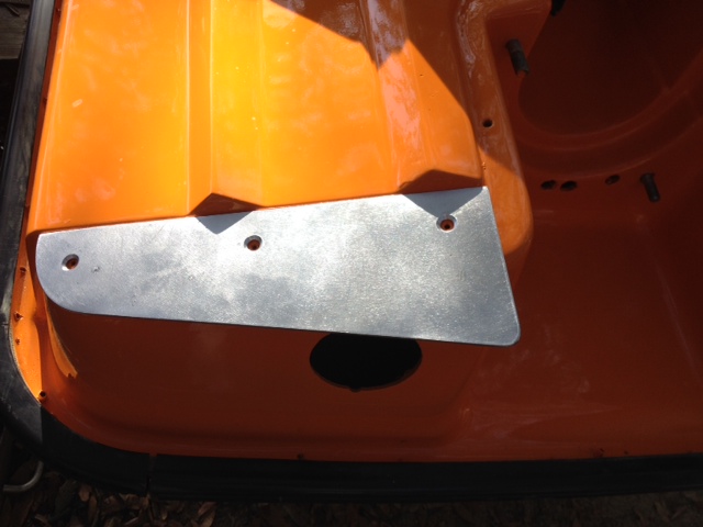

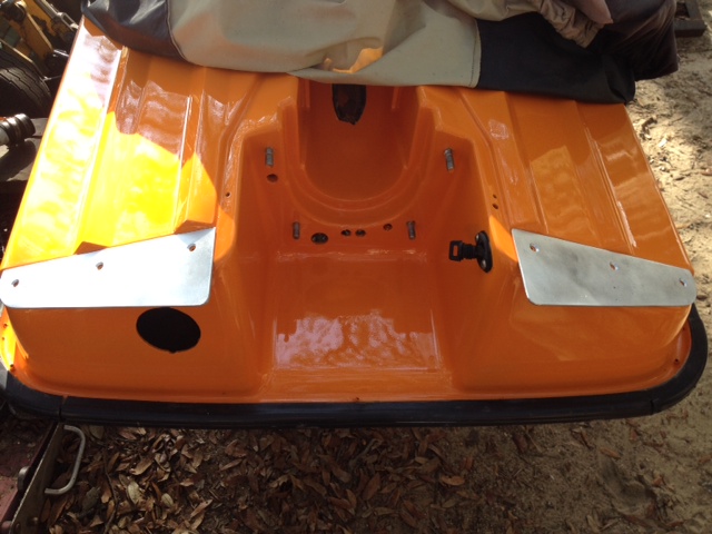

Check out these custom trim tabs a guy in Cali made me. They are thin and tough. I painted them with the candy camo and sealed them with The Right Stuff.

They are black with a orange outline I think. They're mat colors are pretty limited. I just can't keep yellow clean. I can use other X4 seats for my test and tuning so my dirty hands don't soil that dreamy thing.
