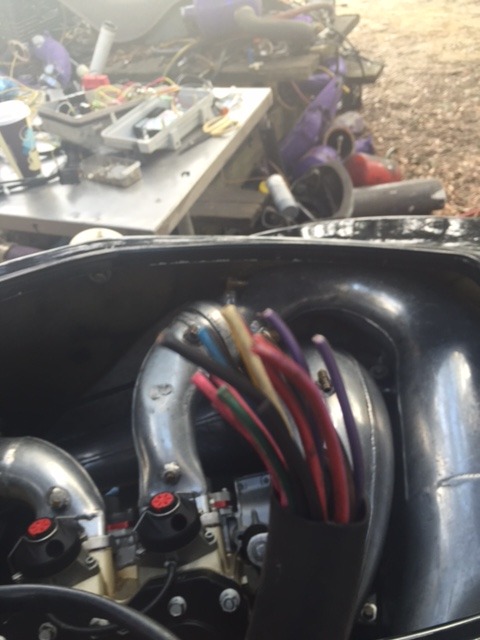

It was a busy day at work today and I could not get a moment to really flow with it. I did make some advances on the electrical. I'm going to use my one spot for the 96 XP grey box and I'm using the old rave solenoid mount to attach the coil and starter solenoid to. Here is what is heading toward the grey box and gauges.

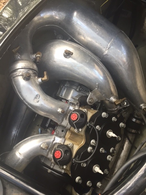

Here is a clean look at the pipes pinned down

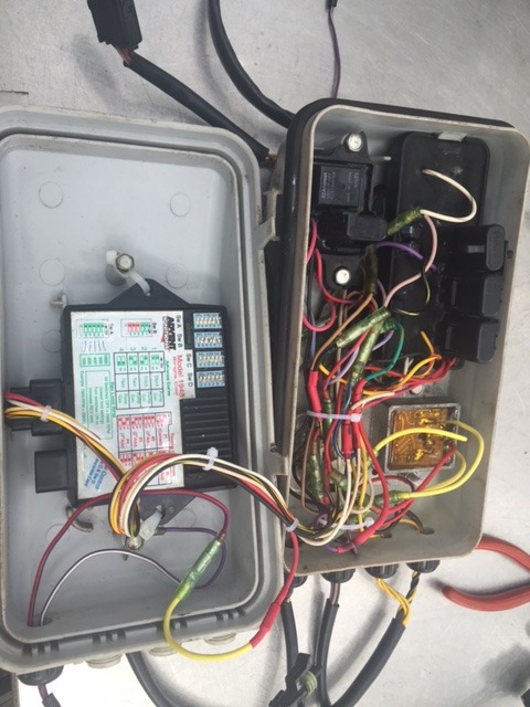

A look inside the grey box. I replaced the six wires that go to the mag cover with a longer one from a 96GSX so it reaches better.

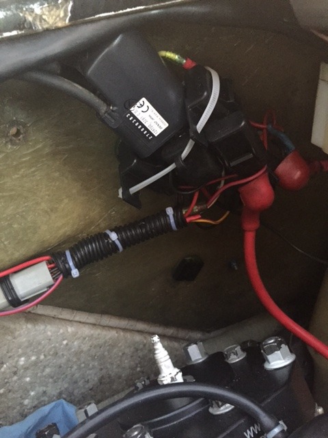

Here is my "black box". Everything is greased and sealed. I have not routed the wires yet. There are three fused 12v power leads instead of the two normally found in a rear Ebox because one will feed the Advent ignition.

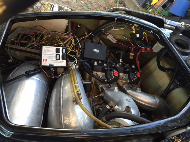

OK so I don't think my original wiring would have worked. I wired the new Advent in but things are not working. I was able to program a key to the MPEM but when I put the key on I get 4 beeps (after the initial two). This means the CDI cannot communicate with the MPEM which makes perfect sense because I took the CDI out of the system. I was trying to treat it like the MSD Enhanser and replace the CDI with the Advent. I think that's where I went wrong. The Advent normally wires into the newer black flat MPEMs and they have the CDI built in.
At least I didn't fry anything this time lol. When I get back to it next time with an hour or more it should be "braaaaap!!"
If I can't get the 96 MPEM to work with the Advent then I can go another direction or two. I can put a dual coil cup on the flywheel and run a 99XPL MPEM with a Micro Touch ignition box that will allow me to adjust the timing curve. I could also keep the single coil cup and run a 97.5 GSX MPEM and use a 97 MT rev limiter that will let me retard the timing a little at WOT. Or I could just man up and buy the MSD Enhanser 4255 that is adjustable and would run the boat on it's own ($380).

It lives! (Braap!)
Now I just need to play with timing, make little adjustments, look for leaks, etc. The front cylinder was hotter then the rear at idle so I need to shorten the linkage between the carbs a little. It sounded good but racy and volatile. I guess it sounds like it looks.... like a giant pissed off wasp.
