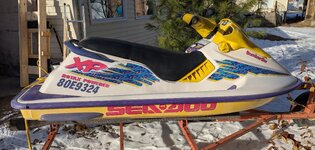

Why does my seemingly original 95 XP, except for the seat cover, have a 657X under the hood?
Is there any chance this was a factory setup or simply a motor swap by a previous owner?

Someone did a motor swap. Where are you from? That looks familiar, I mean they did make more then one 95XP but I’ve seen one listed with a black seat in my area.
I'm in southern Ontario..just picked up today on FB Marketplace today about 60km from me. It's likely the same one you've seen..it had been posted for several months.
Nice kid, just needed to get it gone..a great off season deal!!
What do you mean 'they did make more than one 95XP'?
When I was saying I think I seen this one, I meant it could be a different one since they made more than one.
Although they did make more than 1 95XP, they made the one here like you have that comes with a 717 and they also made a 95.5 XP with a 787, the one with the half pink bottom hull, yellow upper hull.
Right, the XP800 as it called..I've seen that too.
Well 717 or 657x, I suppose it makes no difference..she pretty and when I'm done I've a nice fleet to play with!!
Thanks again for the help..
Nice ski. 95’s are the year to have IMO. Someone must have done an engine swap along the way. Nothing wrong with the 657X, just a little underpowered when compared to the 717. Fair warning, vintage two strokes are addicting!

According to the specs the 717 and 657x are quite close in HP rating...85hp vs 80hp. So not that different..
I guess I'll find out when I get it back in the water in the spring!!
Now that XP800...that will have to be my next find!!! ;) Good on you...
Acceleration is really the main difference between the 657 and 717, otherwise they’re fairly close in power. They’re both a ton of fun though.

If the 657x and impeller is good you will be very happy with it. I’ve driven my brother in laws 94XP with the 657x and I have a 95XP with the 717. I couldn't even notice a difference. They are both a ton of fun

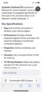

Anyway, I have an Evinrude E-tec outboard..a pretty high tech unit that uses this special X100 synthetic oil.
It's expensive, but I use it for all my 2strokes..outboards, sleds, chainsaws. It's pretty amazing stuff..I'm sure these old classic Seadoos will enjoy it too!!

I will try not to preach about oil Lol but after doing a quick google search I see that it’s rated TC-W3. Seadoo actually puts a sticker on all these old 2 strokes saying not to use TCW-3. It will work, will it have as long of a life, no. Oddly, I bet you pay more for that XD-100 than you would for the API-TC
I don't know..I've used it a long time and never had an issue!! Check this out for interest...

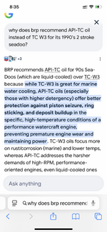

TCW3 will be fine in a non-RAVE engine. I’ll probably catch some hate for that, but there’s been a 94 SPI in the family since the day it left the dealer floor and it’s used nothing but Quicksilver TCW3 oil it’s entire 31 years of life. Still runs just fine.
Do NOT use TCW3 in a 787 or 951 RAVE motor unless you want to tear down and clean/rebuild the rave valves every other ride.

Because 90s oil was a completely different oil than today’s oil. API TC service classifications aren’t even in use anymore, and the current JASO FC standard is a higher standard than API TC ever was. If the oil meets JASO FC certification, it is by default a low ash oil and is 100% fine for use in a non-RAVE engine.

Can you run TCW-3, yes but you should not. It is a lower spec oil that is used mainly to protect the marine environment. For a lower output engine it is fine like outboards and other watercraft and even a 587 should be fine.
It has been known to cause inner crank seals to leak.
APT-TC oil is easy to get and you can find it at a good price so why not run what is known to work with no issues.
When you get into the 657, 720, 787 and 951 engines you really need the API-TC oils as these engines pue out more power per cc than any other watercraft of the day.

Polaris also specified TCW-3 oil when they first came out with their watercraft but after huge warranty claims for seized pistons they also switched to requiring only API-TC oil just like Seadoo. So Polaris found out too.
