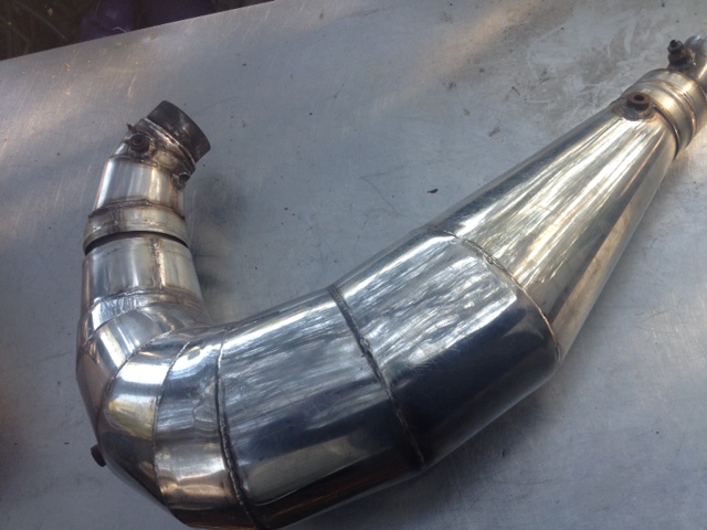

Yeah it's a good group here. I pulled out the pipe today that I'm going to use. This pipe was made by Tim Tynan and called a TNT pipe. He made and still makes high end two stroke pipes but he only made a few for the 787. I have heard as few as 6 and I have two. This one pictured pressure tests. What I mean by that is that it is really a pipe within a pipe. The part we are looking at is a water jacket. When there are no leaks anywhere in either skin then it will hold air and can be verified with a pop off tester.
This pipe is the per-curser to the Neptune pipe that I like so much. Those are pretty rare themselves with only around 250 having been made(I have 9 haha). So this ultra rare prototype has been a "holy grail" part to me like the carbon fiber X4 hull itself. This pic is with no couplers or fittings

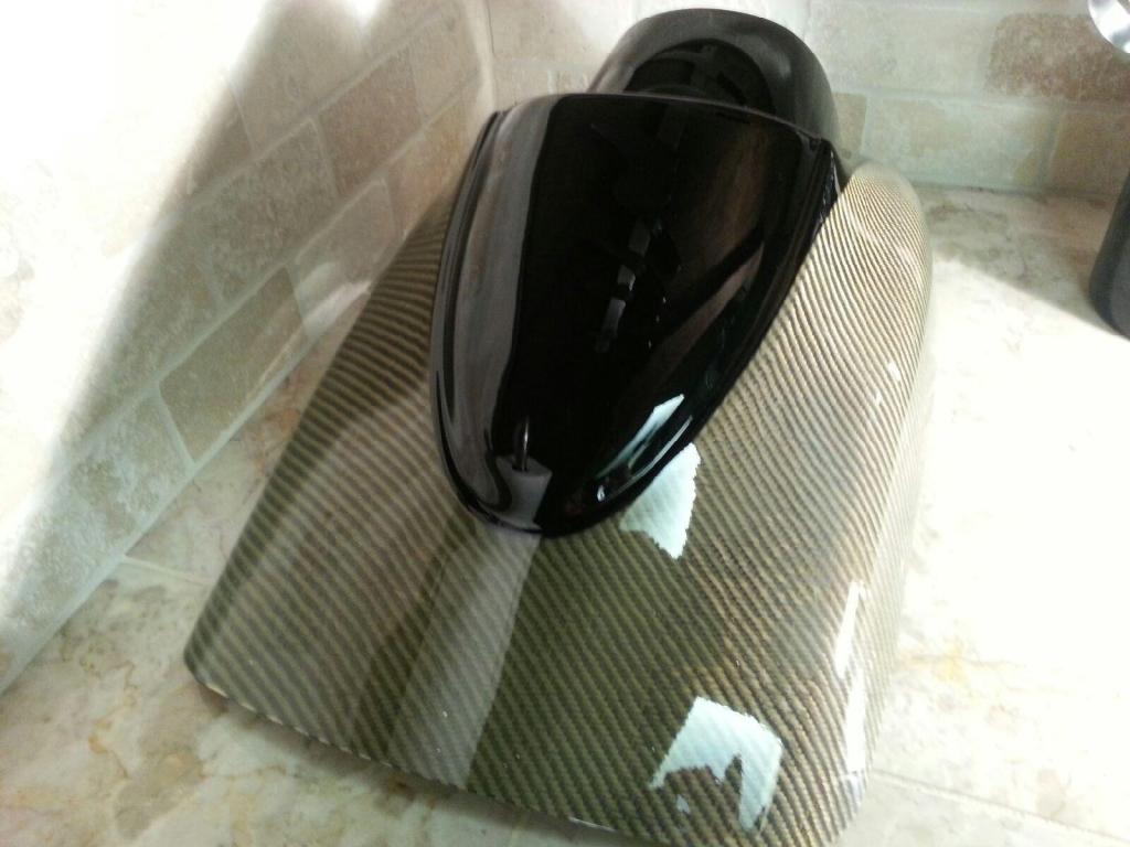

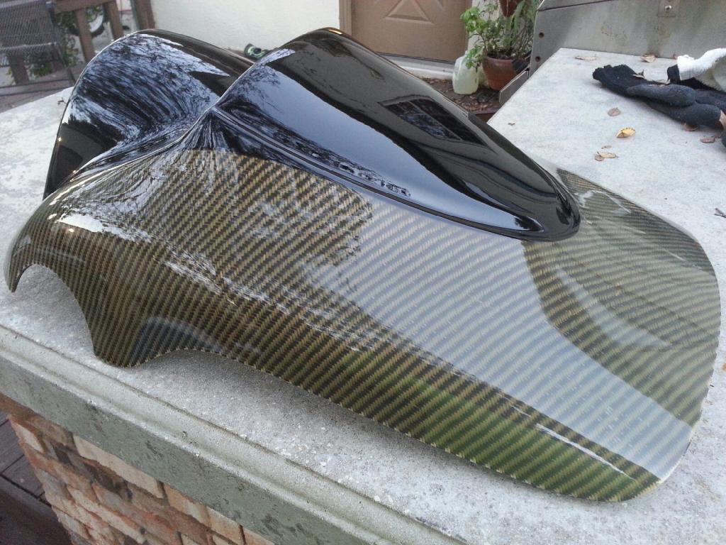

Now this I'm very excited about! Pics just came in tonight of my finished hood. I think you'll agree it's nothing short of greatness. Some members will remember this when Krispy found it and it was painted and cracked up. He has made a carbon fiber visor from the 96XP one I sent him so I can drill and attach if/when I want but I would have to drill holes and it looks pretty darn good as is.
He has made a mold of these parts so he can custom make them for folks in the future. Not sure about prices yet but the matching water box is $300 so that gives us an idea. I'll let you know more when I find out.
That is some top notch work. I have been thinking about having one of my single gauge hoods hydro dipped in carbon fiber I may have to do that now.
Thanks bud. Yeah I know I just keep starring at it.
He was all bummed that he could not get 100% of the bad crack out. it's in the carbon itself there on the lower left side
I would honestly have to make a custom cover just for the hood for when the ski is not in use.
Any detailed pics of the crack repair? I would love to hear how it was fixed.
Looking great!
He ground it down to the carbon and then added several layers of clear again. He said the underside was the easy part, have not seen it yet but don't really care how it looks under there. This guy is a craftsman who cares about his rep so it probably looks great.
I want the carbon hood one! Btw I have one of those TNT pipes in HX. Feels like a couple more HP more than FP.. heavy though!
I thought for a second I had one of those hand made TNT pipes but mine has less welds in the lower section. I would assume that makes it a neptune?
Yes the TNT has the rings welded together like a two stroke pipe under development. These pipes can beat a Spec 2. Here is a pic of a Neptune
