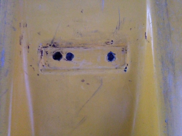

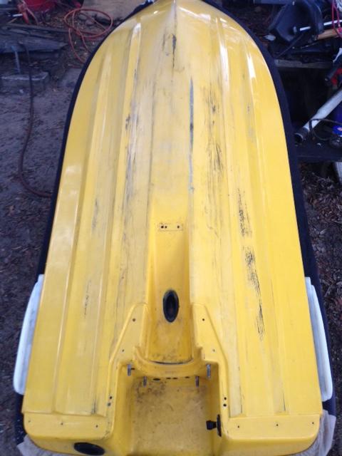

Well I know it's been seen a lot on here but this is the first time I've flipped one to work on myself. I can't say the bad news has slowed down. Keeping with the three hole theme, this was under the silicone where the grate mounts.
Here you can see areas where the gel coat has rubbed through and is exposing the weave.

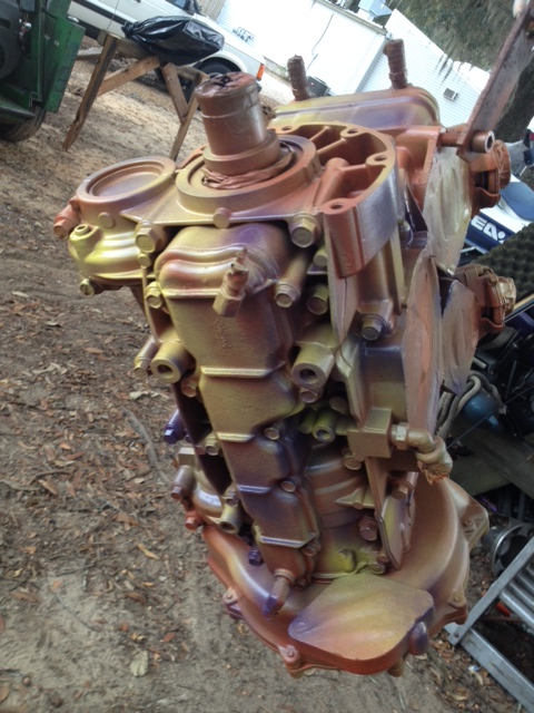

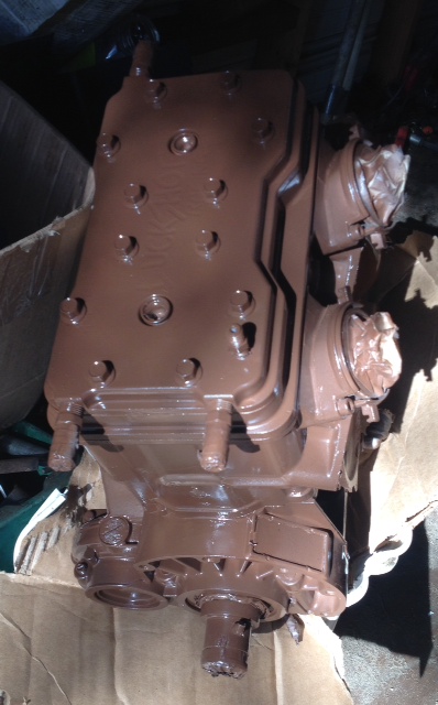

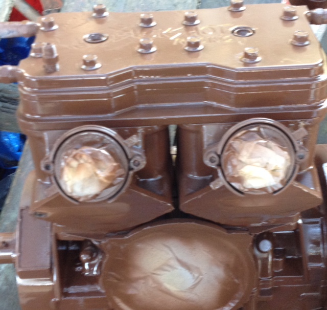

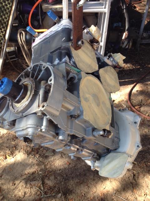

I hope you don't consider this more damage but I dipped the engine in leather gloss brown. My squish was too thin at .041 so I had to pull the top end back off and put my fattest base gasket in there. It brought the squish up to the early 50's. I consider that a minimum but I'm going with it. I'm calling this one "The Chocolate Engine" and hoping it doesn't end up "The POS", lol.
I called the local fiberglass repair guy that I know fixes a lot of boats around here. He is going to come by and take a look tomorrow and tell me what he can do for me. I told him I'm more interested in the bottom being even then matching the gel coat's color.

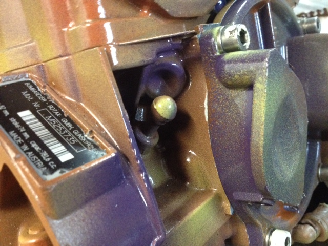

I'd like to splash the engine with yellow orange and purple. Perhaps I will treat the brown as another primer and start with black or purple as a base color. Get one last look at the chocolate dropping...

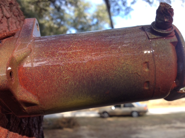

It will make the ski faster if you paint the motor a candy color. VHT makes some nice hi temp stuff I even found a close match to the blue powder coat on my rxx pipes

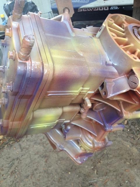

OK here is your "candy color"
For the man that cannot decide which color....
I dropped the ski off at the fiberglass shop today and got things going at Jettrim
Yeah Racer hit me with "Rainbow Bright" the last time I did it haha. It darkened up with the clear coat though and is looking real cool, no remorse this time.

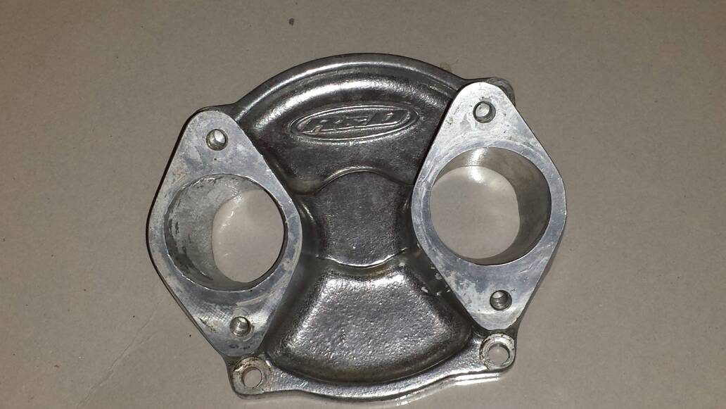

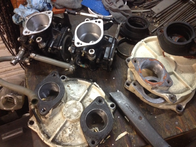

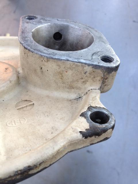

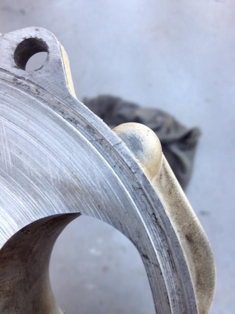

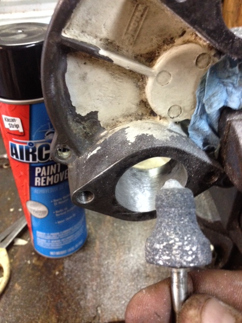

Started at the carbration today and while cleaning up the intake manifold that is port matched to the Novi 42mm carbs I noticed it was cracked
I'm glad I caught that but now I have to make one. I spent a lot of time grinding and filing today and finally got both holes from 40mm to an even 42mm so there is no ridge anywhere between the carb hole and the port. Of coarse I will need to trim the new gaskets when I get that far.
I went and got some of that Aircraft Paint Remover that you guys talk about and it works great. Tomorrow I will drill, tap, and plug the oil injection holes with set screws in thread locker and silicone. I want to polish up the ports a little so they are smoother

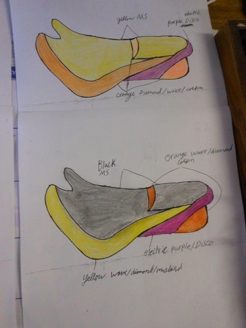

Now here is the fun part.... I've been enjoying great service from Jettrim. They have taken a lot of time to come up with some cool ideas for my seat. Full disclosure, Jess(Minnetonka's brother 99spxxx) has the only other air induction seat I know of out there and he added a hump to his. I'm making mine different but had to throw him a shout out. Same to Dagre147 who traded me the seat so I could send it in. This is only two of six possibilities he sent over today. Material samples in the ski's color scheme are on the way to me so I can hold it up next to the boat and make the best choice. What a first class outfit!

[MENTION=73220]1of500[/MENTION] just picked up a novi mani, see if he will part with it

That R&D manifold may have worked but I have hours in modifying the stock one to match these carbs perfectly. Another hour or two and it will be perfect and pretty. Thank you though!! I have tons of manifolds myself also but most of the am ones have been bored over 42mm or are set up for spigot mount. I wanted the stock bolt pattern for these also cause a lot of the am ones will rotate the carbs in the wrong direction for linkage and fuel hookups.

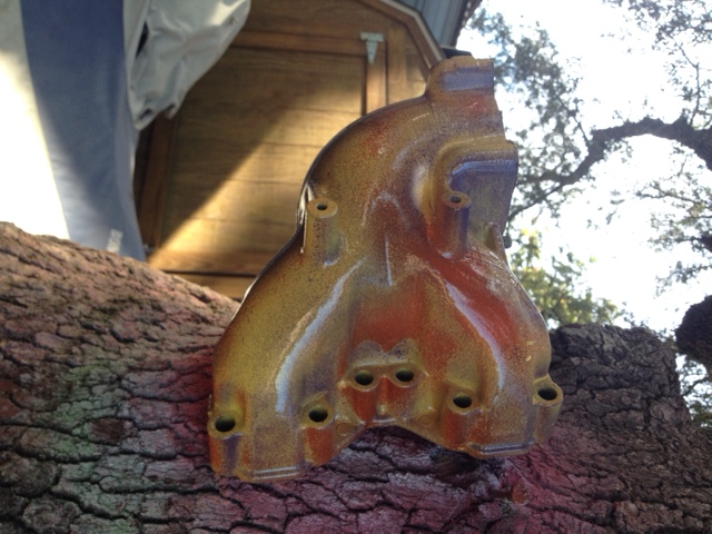

I finished the manifold today.

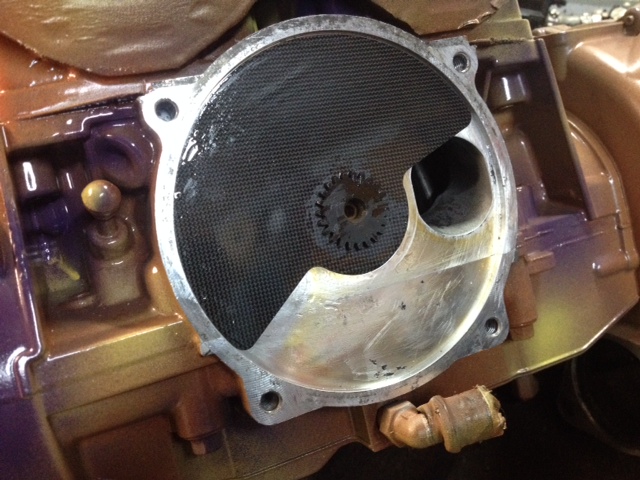

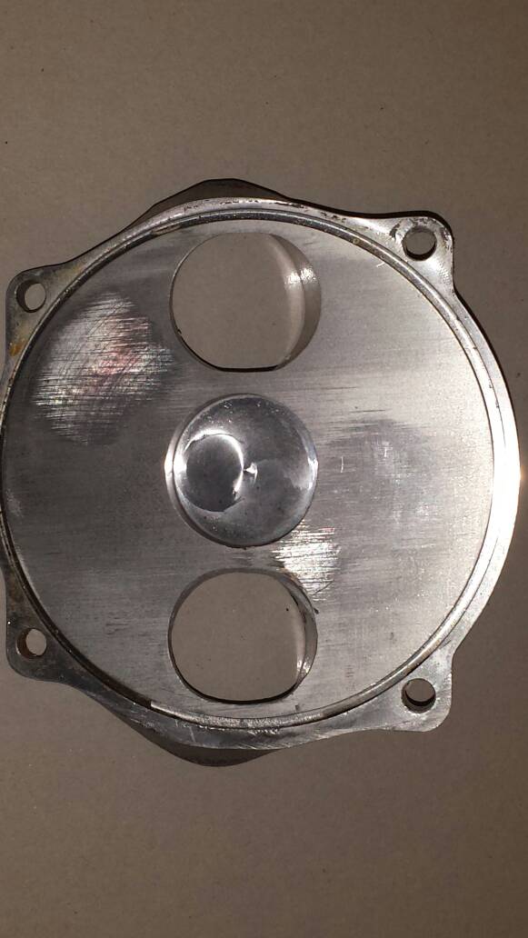

Sticking with the carbon fiber theme, I picked out a rotary valve that most closely matched the original. It was marked 163

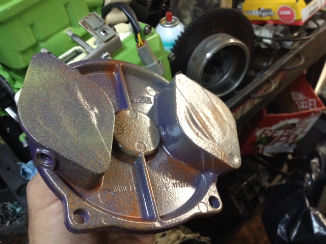

Starter and mani glitz
I'm sorry Matt but whatever you're smoking... send some my way! Lolol
