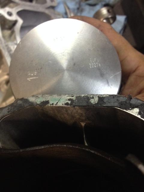

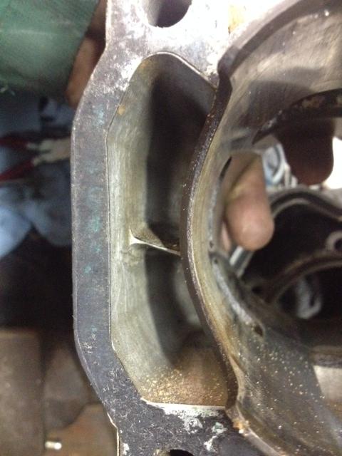

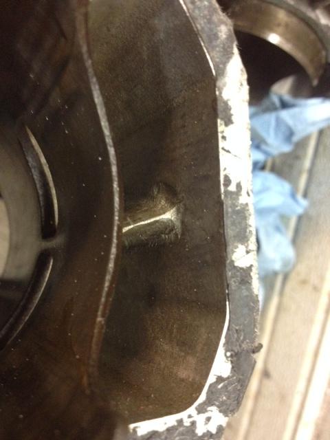

I broke out a pair of cylinders I took off an old race ski. They need a lot of cleaning up but I want to use them because someone has done a little porting and polishing on them. I thought the pistons were too sloppy in the holes so I broke out my 81.91 pistons to get the clearance right. Then I realized that they were Wiseco pistons and they need more room because they're forged. They are lighter as well so that stays with the theme.

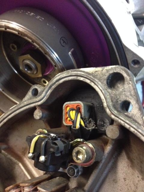

I left the new RAD aluminum flywheel new and went with this purple Jetinetics. I have a brand new pickup bracket with the post 97 wings on it for insurance(got towed home about 10 miles by a Yamaha once from the famous and dreaded broken bracket). I have a lightweight pto for the back end coming from Jess(@99spxxx). It won't be the first or last Westside Powersports

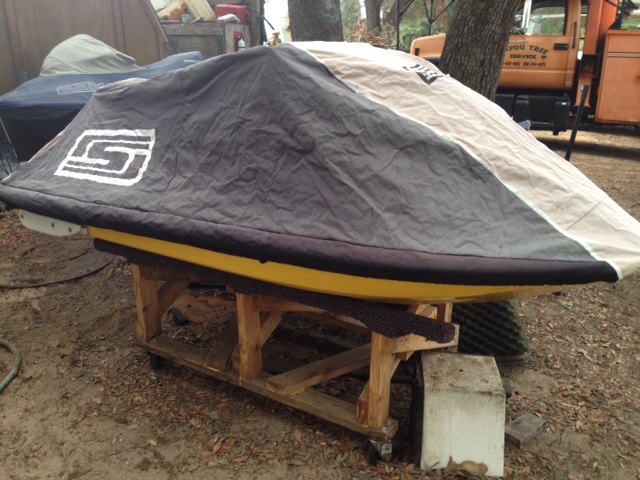

I got in a Slippery brand cover that slipped through on Ebay. These are super heavy duty and they work on my X4's with aftermarket steering systems since the OEM ones won't.

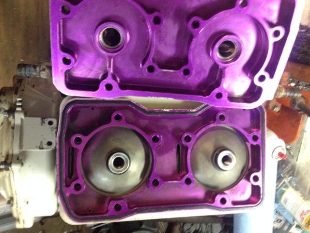

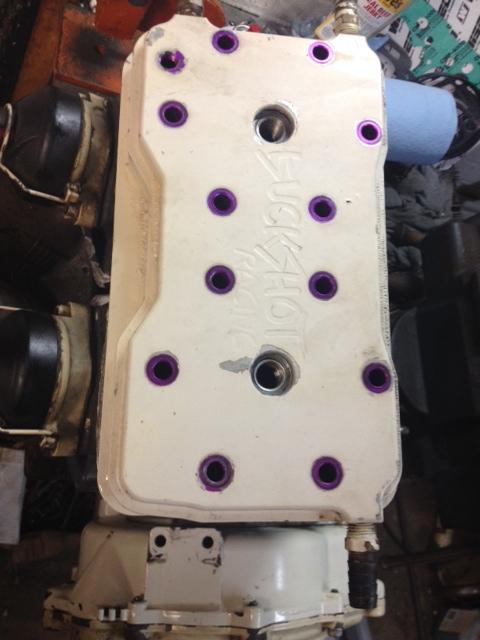

I put my Buckshot head on today that someone had previously painted. I would have never painted over that pretty billet purple ut since the last guy did it frees me up to do it again without guilt.

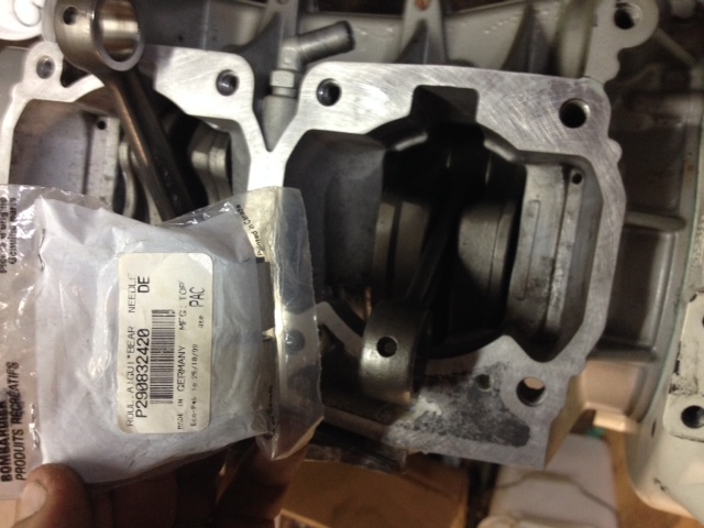

I used the OEM non caged wrist pin bearings of coarse
Loving the build Matt! I want to bead blast that engine to rid the corrosion so you can lay down a nice monochromatic color. Then send that head out and have it de-ano'd and re-ano'd make it look like 1996 under that seat again. I would love to see a period correct performance build that looks showroom fresh inside and out.
And for powder coating the vintage speed parts--please don't. That just ruins the look in my opinion. For what you will spend to have them powdered it would cost the same to have them de-ano'd and re-ano'd and they would look so much better. Even if that was a different color.
Thanks guys. I wouldn't rule out the bead blasting. Maybe not on this round but I do have a cabinet new in the box. I found a spot where someone had filled in part of the head with epoxy. It looks sound and should hold the water pressure fine but I'll stick with the paint with a clear conscious.

Yesterday I took a cleaner pair of ported cylinders to the local machinist with my new Wiseco pistons.They are 1.5 over which is too far really but I'm just thinking about power. That will make a 782 810CC! (I think). I scored another rebuilt crank and counter balancer on Ebay so I'll put together a second engine. That way I can choose and swap or whatever.

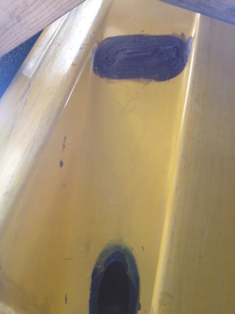

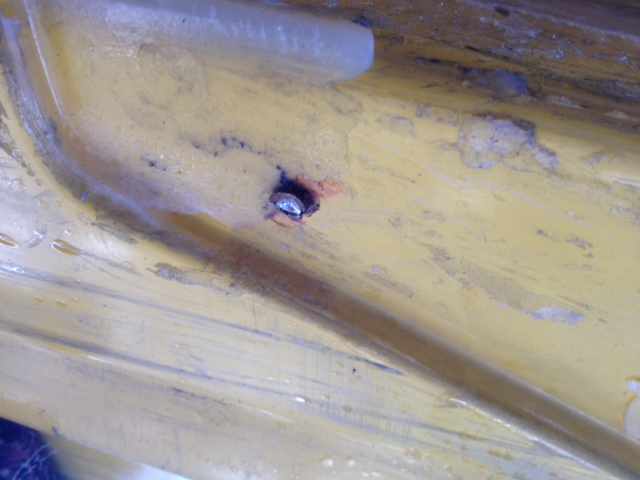

I wish they had not of removed the ride plate. There are extra holes in a couple places where a bolt stripped or broke and they decided to "fix" it that way. They also ate into the surface that the pump mounts to. I don't know what the meaning of that work was but it seems there is plenty of meat left to seal a pump on it after I get it sealed to the hull again.
This bolt was drilled to get the plate off, there are two others broken flush
And there is no way that there is good news for me under this "grate must have gotten ripped off" silicone job.
It looks like more work than I was expecting, get everything cleaned up and see what you are working with. The broken bolts should be removed, I have had good luck with drilling out the center of broken bolts and collapsing the remaining perimeter and removing with a pick. It is time consuming but worth it, thanks for keeping us in the loop.

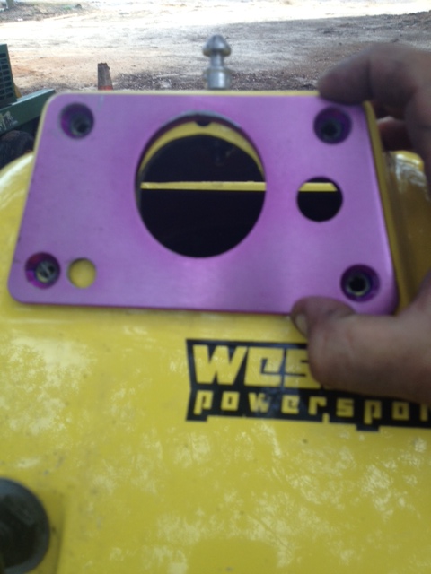

Well I sold the hood off it and the "T" tank is broken so I took the UMI off it and put it for sale. Luckily the plate from the R&D steering stem shares the same bolt holes, I just have to enlarge the center hole a bit toward the top.

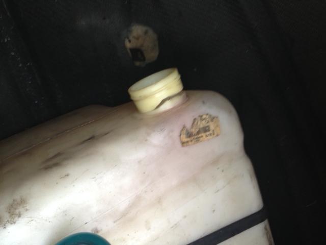

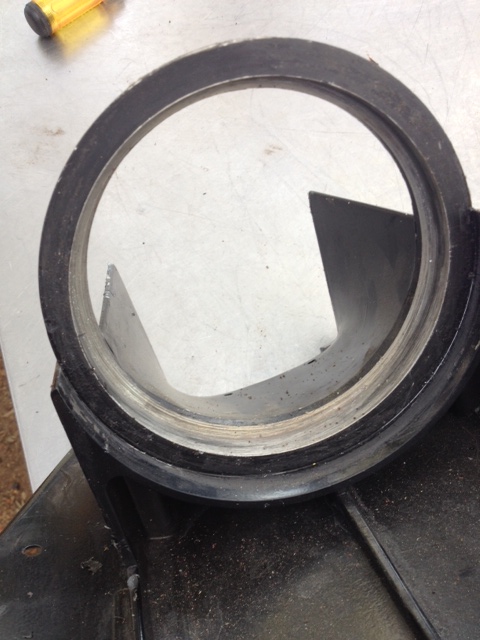

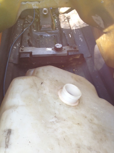

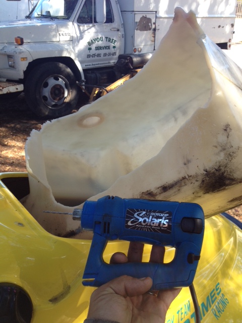

Still some more "custom" problems. I go to pull the tank out today and It's not coming out......not in one piece at least. I pulled the Aluminum strap with the front mount on it and it was just not gonna happen. They must have stuck the T tank in there before they fused the top and bottom together.
My trusty Roto-Zip made short work of it but now I want to find as large a tank that will fit through an X4 hood.

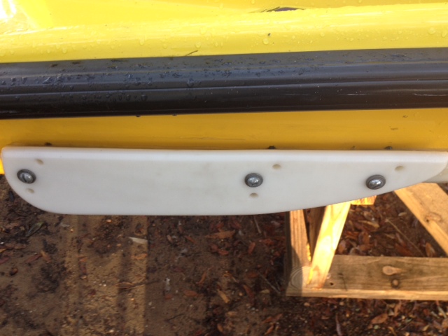

Looks like they missed with the first sponson attempt. You can see three holes with silicone in them above this sponson.
And as long as we are talking about three extra holes.....
