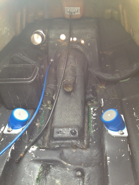

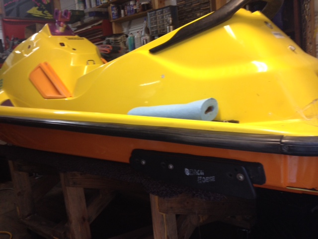

Got my sponsons installed today. I went with Beach House. The sponsons that came with it were white or I would have reused them. I hope I'm not creating handling issues. I can always cut and file them down. I like the wide backing plates they have that allow me to hide and seal in the extra holes. I filled the holes first with two-part epoxy.

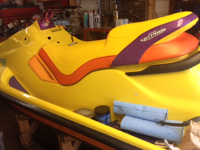

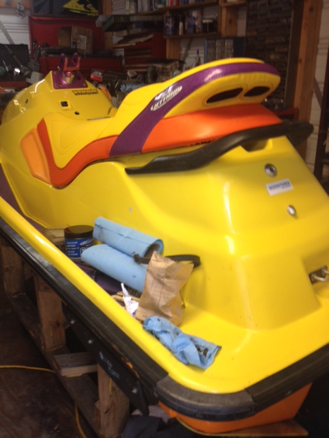

Now a couple with the seat

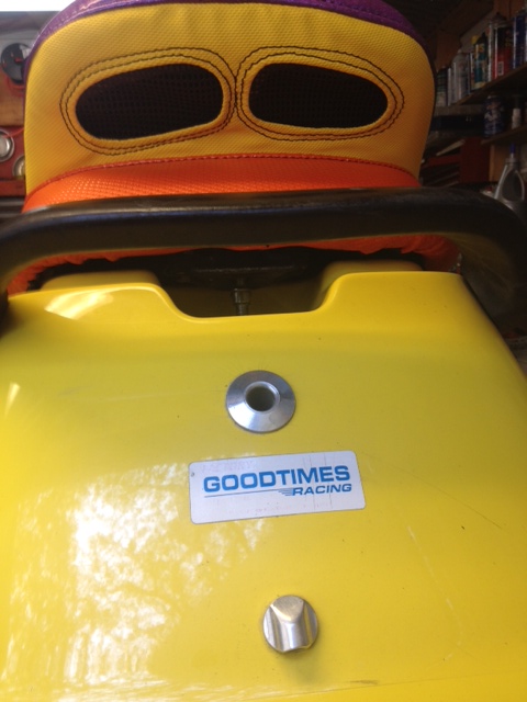

Vents close up

Daaaaamn! That's sweet :) I thought you were going to use that black seat. Man, this one matches your build so well!!
I have half a dozen other aftermarket X4 seats so I can pick out the right one for the situation. This one is my "Sunday's best".

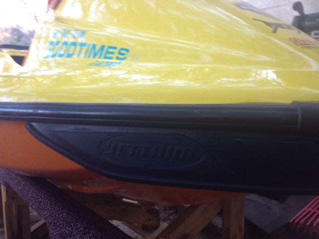

I got the Jettrim splash guard on today. The nose cone was loose when I got it so now everything is nice and tight.

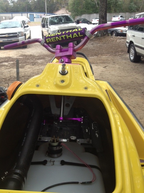

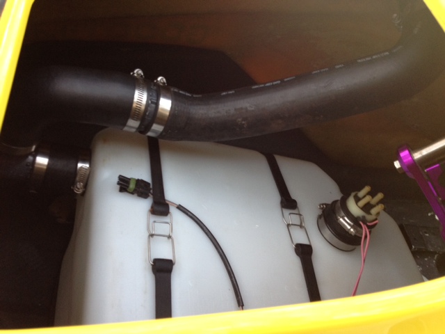

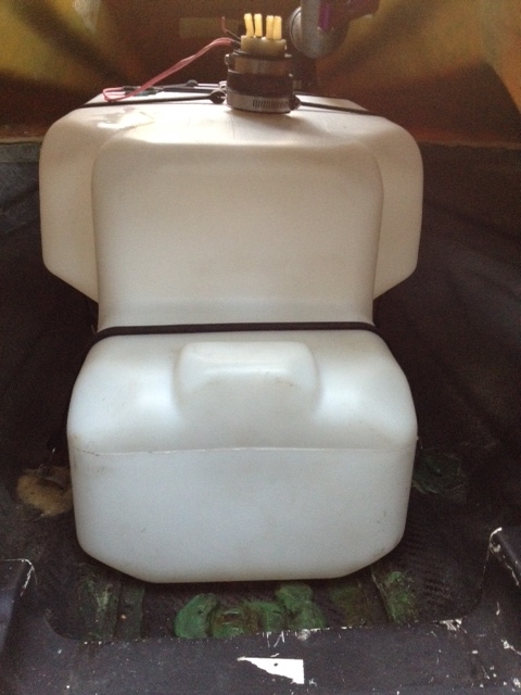

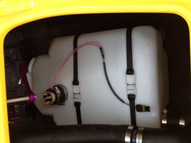

Then I got the new T tank from Westside Powersports installed correctly with a working pickup. I replaced a missing strap mount and secured it with epoxy.
I'm very happy with it. I will be able to dump my "dump jugs" of pre-mix in with no flow restriction. I gave up on having a storage bucket though.
How much smaller does the storage box have to be when you use this kind of tank? I have one, just haven't put it in yet...
Gsx tank is totaly different and will not work. The stoarge bin needs to be cut down quite a bit. About 8-10 inches off

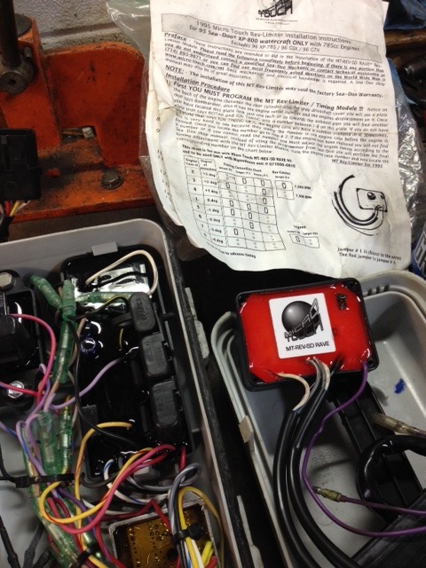

I got the bars and the steering cable on today. I had to open the VTS hole up a little for the stock unit to fit. Tomorrow is supposed to be rainy so I brought the wiring inside to work on. I'm gonna run the 95 XP800 electrics but with a Micro Touch rev limiter/timing control.
I am in need of one of those for my 95 I have a 96 that came with the factory pipe I bought if you would be willing to trade?
He has an mpem for a 95 last I saw. I have 2 mpems for 95 but the Mt Rev limiter I have is 96
