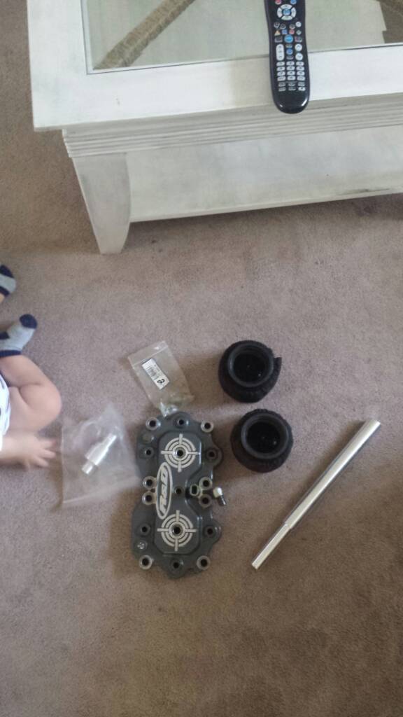

Got some goodies in. R&D head with FAs, proper needles and seats etc. And Ace's bearing removal tool. Also got my wet suit off of eBay in, but ill spare you the tightness since I posted it on another thread.
Only picked up the head and components bc it was a good deal, I want to make this a reliable runner before adding snazzy stuff.

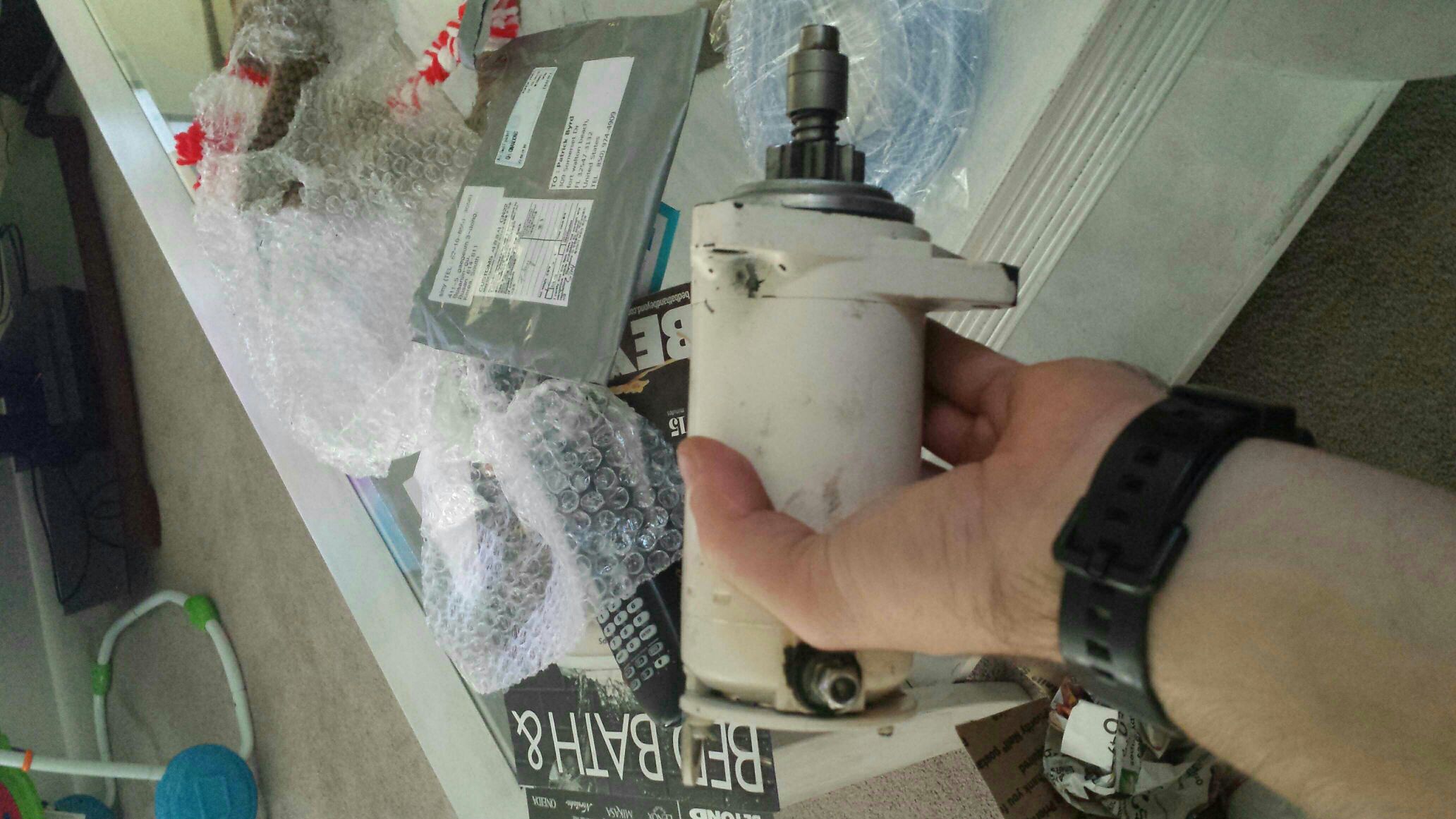

Also picked this up for dirt cheap. I'm pulling out all the stops trying to figure out this no spark. Already replaced all battery cables and solenoid.
Reason I am trying starter is bc the other day I got a little over anxious and tightened the positive nut a little too much and the whole post is now a little loose
Sent from my SCH-I545 using Tapatalk
Yeah I figured to do that I'd have to take it off and if I take it off I might as well have a spare just in case I jacked something up. Just removed and Bench tested it, no Bueno...I must've fried it in my bumbling about when I first plugged it up to a battery
