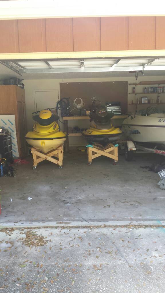

Ongoing process lol. Don't have the time I once did, but it's getting there. The 97 runs when I add fuel directly, gotta figure out why it's not pulling fuel

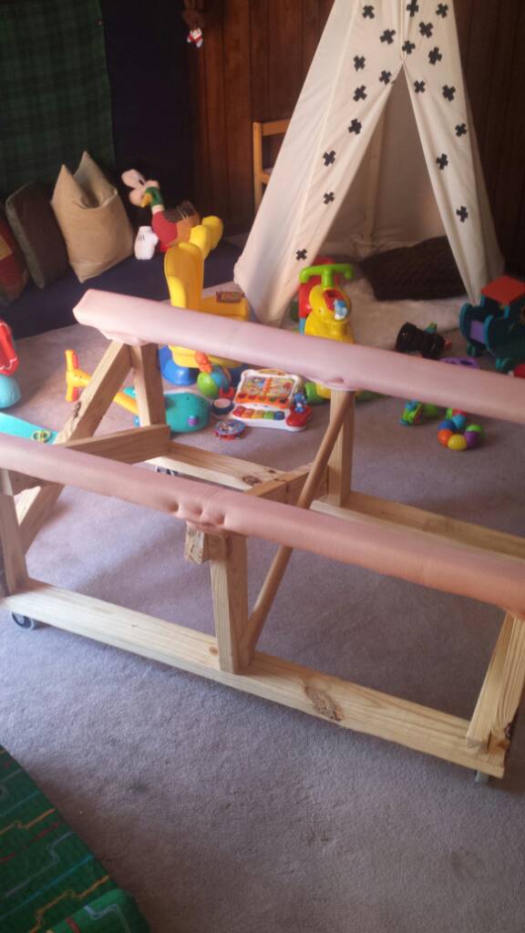

Tossed together another cart this morning out of some wood I had laying around. Trying to get both skis on carts and get the trailer out the garage to free up some space and also start work on fixing the trailer. Didn't have any carpet so gonna use foam for a quick fix.
My wife would beat me if I dragged that into my living room!

Love the stand I really need to build one how is the one you built do you think the wood would hold a 96 gtx?
Yes, they can hold a 4 stroke. Google twinturbomustang pwc bombproof stand. There is a pic of your cut list I think you need 6 or 7 2x4's, screws, 1/4 lag bolts and 4 4" casters. Total cost it's around $45 less carpet for the bunks.
