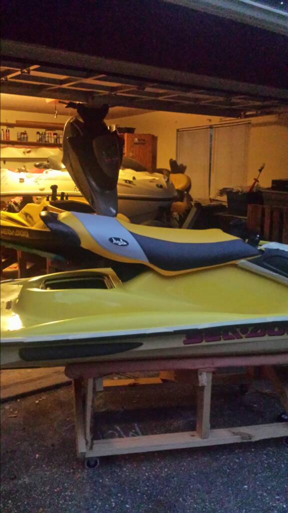

....It's ALIVE. the new carbs were spotless and sold my old carbs to cover most the cost. Seems to have fixed my problem, a lot of smoke from fogging oil and added some oil down each carb as added precaution. Idled really low but that's an easy fix. A year and 3 months after purchase and she's running boys lol
Figured out the seat and hit the top hull with a quick buff while I was out there. still has bad fading where the decals were and has water lines in the foot wells but not in the mood to wet sand right now.
Gotta get a T-fitting for the premix rv bath and she's done.
Put it completely back together, new battery installed and charged...hadn't started it since before I deployed so figured I'd let her purr for a second...
Clunk. Either a bad ground or this brand new agm battery isn't good. Only turns over with plugs out. Doubt that battery is bad so now I gotta find the weak link....ugh why can't anything go as planned
For some reason the 97's seem especially susceptible to this condition. It is typically bad cables or dirty connections.
He was saying if your crank seals are bad it can cause the rotary oil to leak into the crankcase and hydro-lock the engine so it will not crank over.
