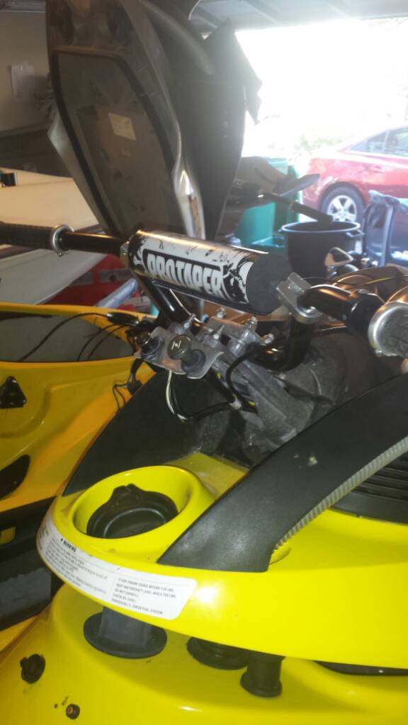

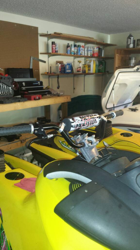

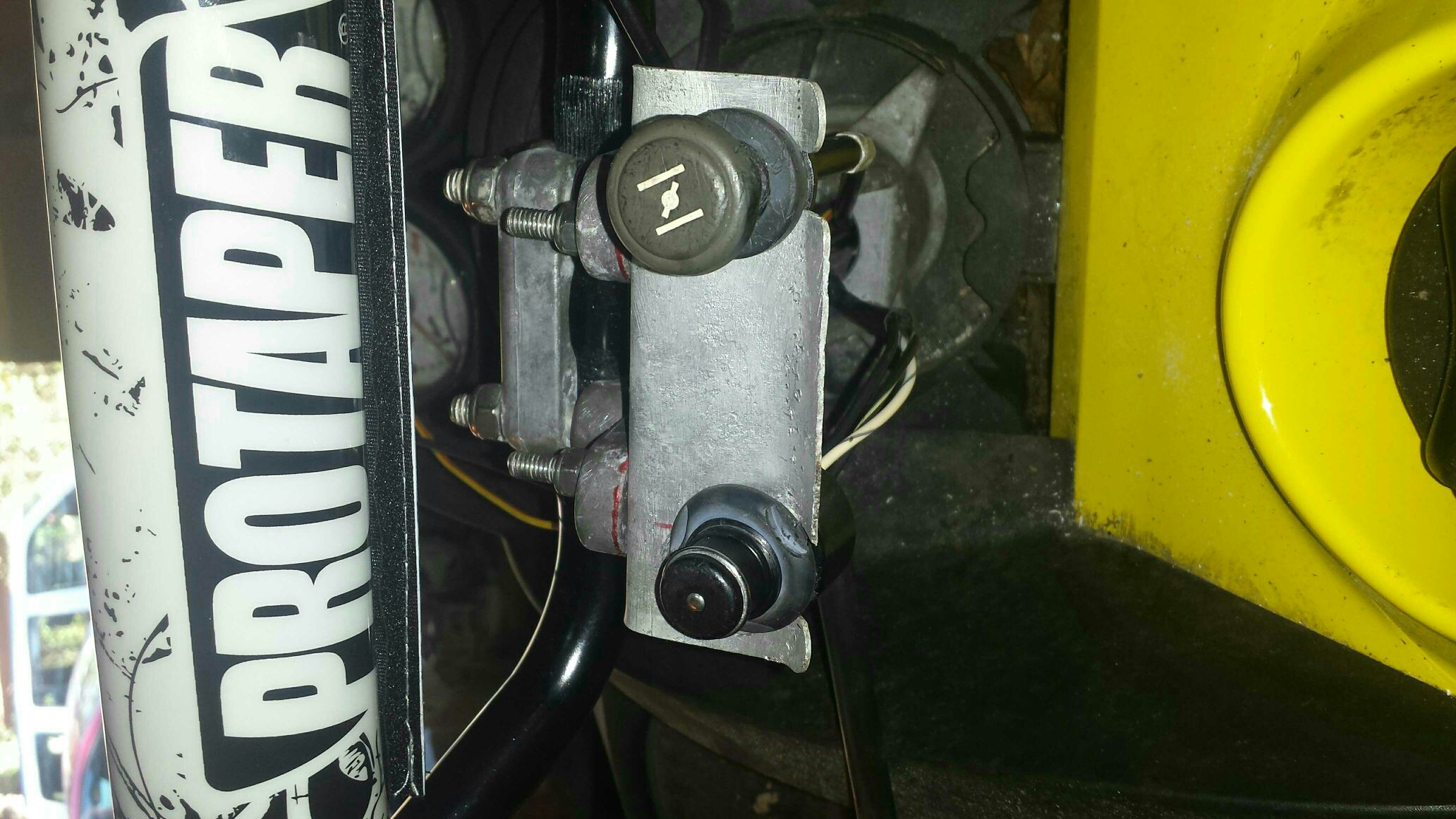

So I 'fabricated' up a plate for my dess and choke since I picked up some moto-x bars. I used a motor mount shim and bent it at an angle with my vise to attach to the old bar pad mount. Widened one of the slots on the shim with some metal shears for the dess. And then angled the bottom for extra slip protection. It's not pretty but it works!
Before I Widened the slot for dess post:
Installed:
