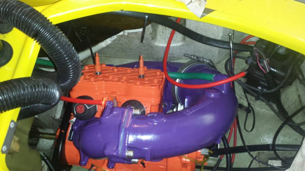

It's a color explosion! I'm trying to cram as much color in there as possible because I couldn't decide on which to stick with. I'll prob. Paint the air box as well. Engine is aligned, still waiting on a couple things to ship in to try and pin point where I'm losing spark....I suspect solenoid I hope.
I've been chasing electrical gremlins trying to get her to show me something for a while now. Switched out all the pos/neg cables from battery to starter.. greased all contacts I could think of..cleaned all contacts. I'm getting lights on the dash but nothing else. Don't want to go anymore forward with install because need the room to fiddle around.
