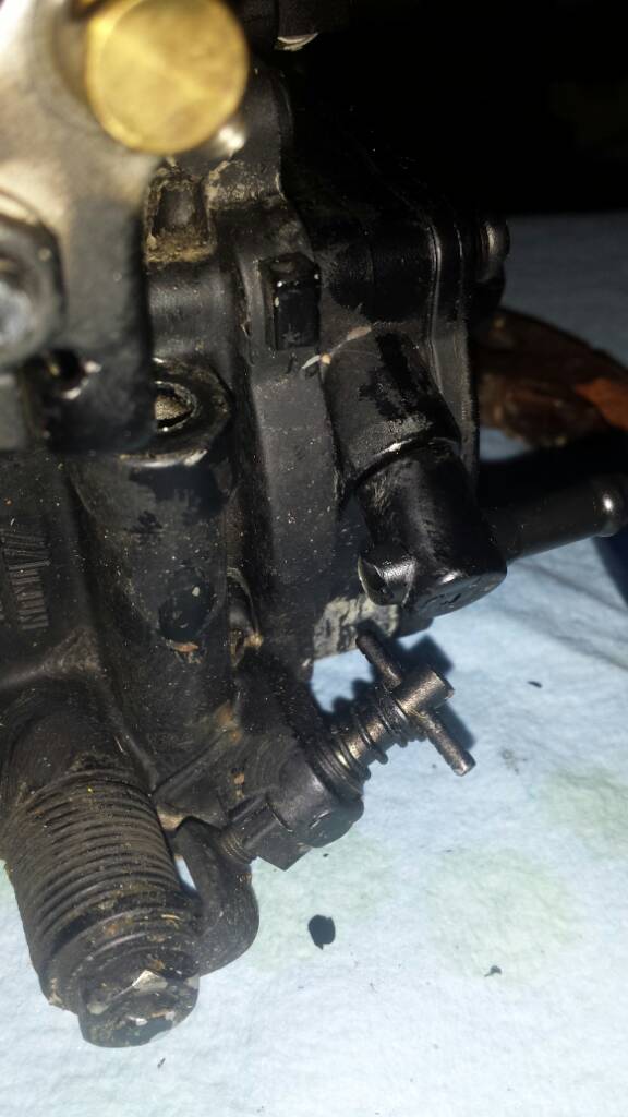

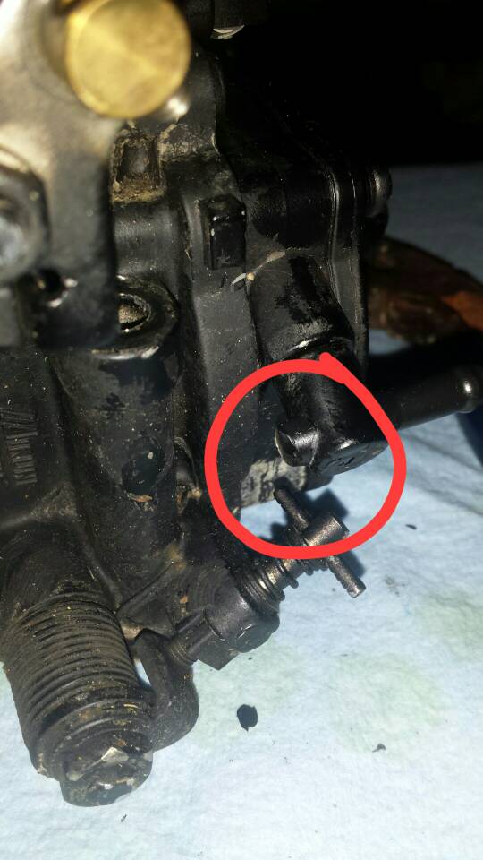

Broke the plastic nipple off.
Why mikuni would design it with a plastic nipple idk....I thought it was brass so I was tugging too hard (that's what she said)

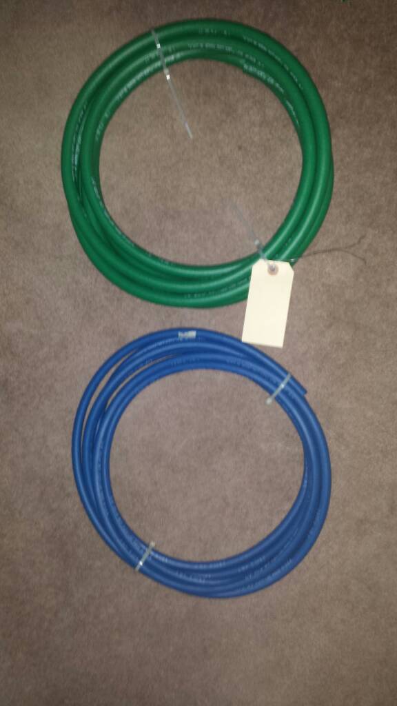

Also my silicone coolant line came in.... not the colors I was expecting. Garden hose green doesn't exactly pop....

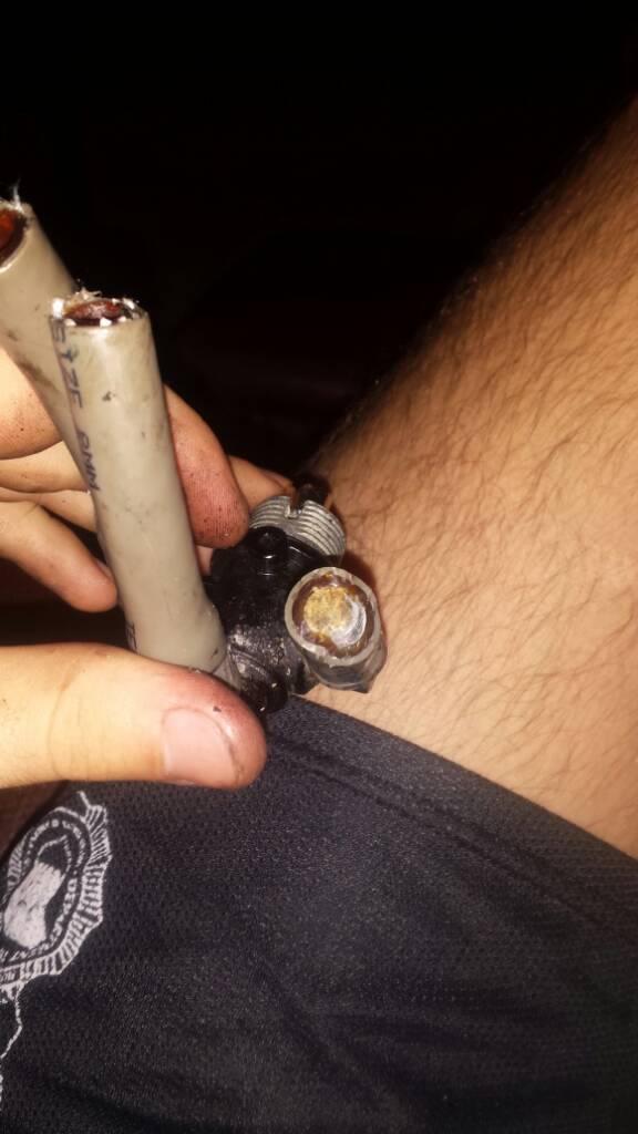

that's a return line if my memory serves correct. You may not need to replace the a-pump lines but you should at least pull them off the carbs and check the fitting to be sure the check valve isn't stuck. You should be able to swap out the plate. I doubt you can find just the nipple . Get a razor blade and slit the lines instead of trying to yank them off

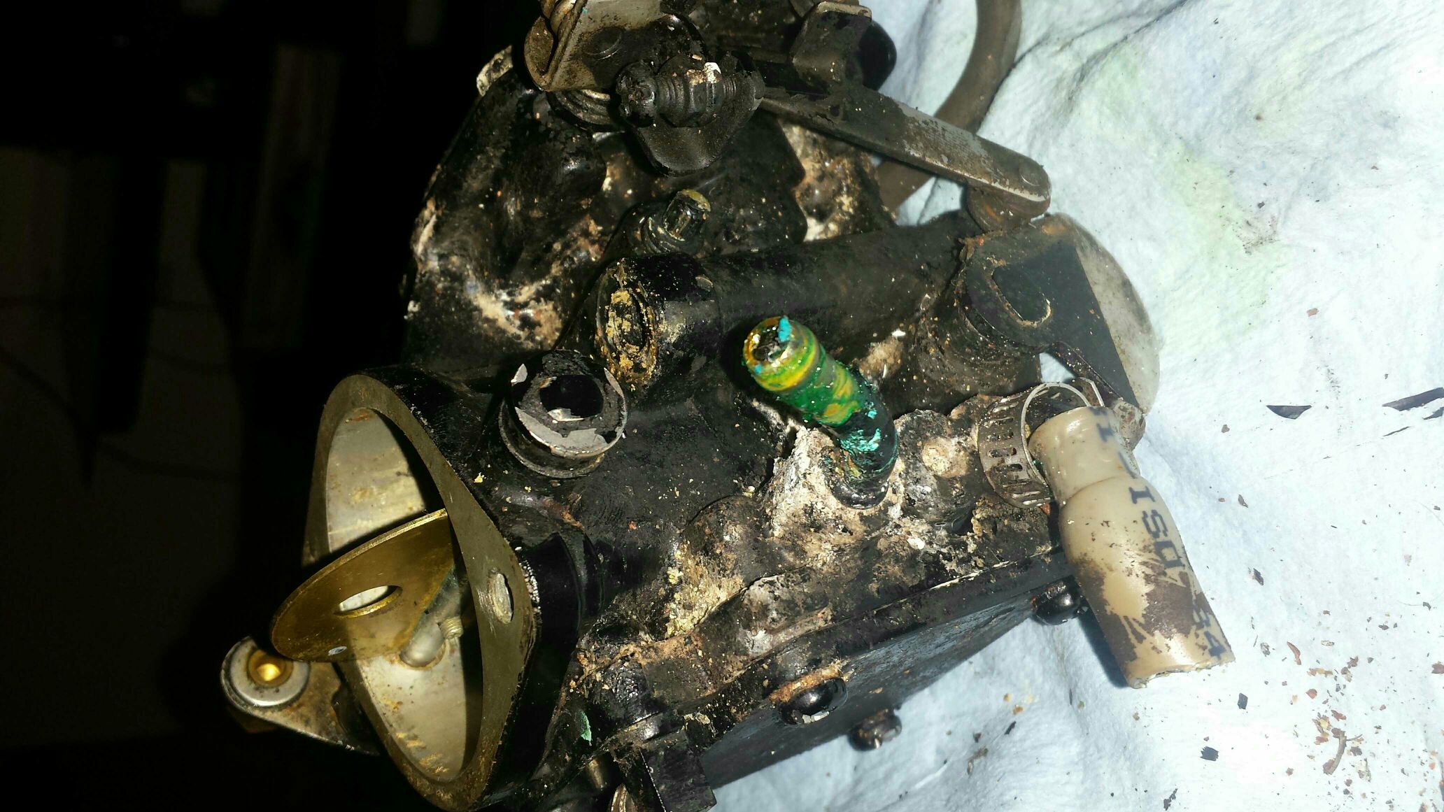

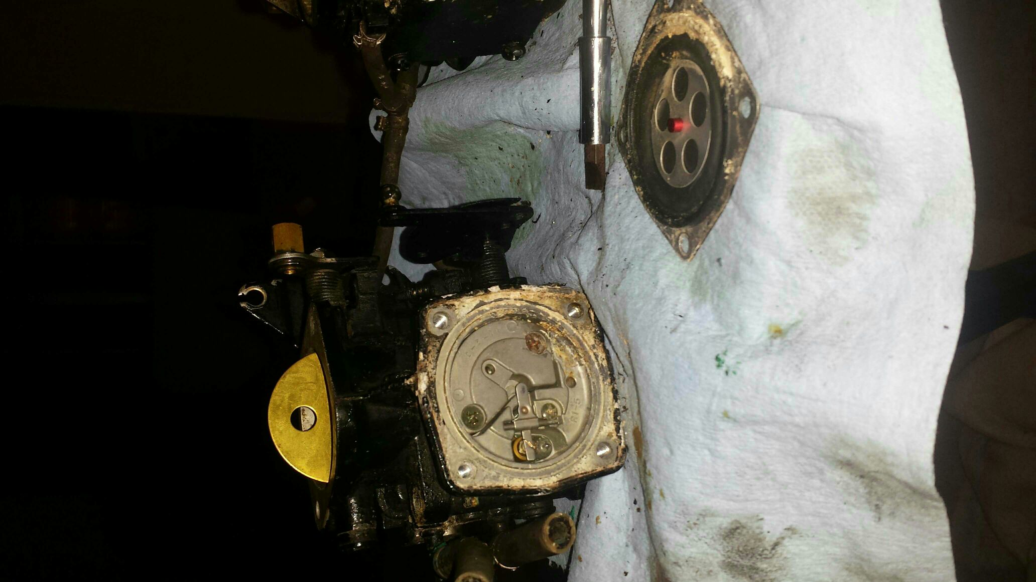

Meanwhile, 951 carbs were relatively spotless. 787... not so much. Further advancing the thought that the ski was dunked and put away wet. Tempo wasn't kind either.
Meh those carbs can be cleaned. They have a little rotary brush kit at harbor freight you can buy to clean those up. Racer did it in his 96xp resto with those and he polished an absolute turd sparkly clean

Some hose in one of those packages is the wrong size :( its 1/4" OD instead of ID
