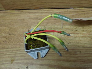

I feel 17 volts is too much, and that's going to affect the CDI ignition system in strange ways causing it to malfunction. I've noticed the Tympanium regulator rectifiers tend to get loose connections internally when they age and as a result they begin to malfunction when subjected to engine vibration.
As a quick and easy test to isolate the possibility of a regulator over-voltage issue temporarily disconnect the regulator red wire as already mentioned above.
I really wouldn't want to see more than 14.4v and preferably 13.8v is about perfect, IMO.
This is what you're looking for
i will try the red wire tomorrow,,,, more exactly what does that do?

Yes try what racer is talking about. Dont be scared of taking the front Ebox out ,All the wires match up color for color inside the connectors. Very simple test
so does disconnecting the red wire stop the flow of power to the battery? thus just running the machine off of the battery voltage and not over charging the system?

Disconnect the red wire as racer said. Rectifier solved my biggest issue last year on my ski. The voltage test is just a tool to give you an idea rectifier may be an issue. Not a definite yes or no. As my voltage tested within specs before changing rectifier last year. Went in circles only to find out it was still bad even though it was charging within specs.

with the voltage jumping up and down like that and then going up to 17v the regulator/rectifier is likely at least part of the issue. usually the rectifier going bad will limit upper rpms, not act like a rev limiter at lower rpms and then clear out, but i guess anything's possible, those things can be weird when they go kaput.
I will be testing it with the red wire disconnected Later today. I am definitely think I need to replace the rectifier regulator, especially when the shop manual says if voltage exceeds 15 v replace regulator. I think I had bad contact with the voltmeter and that's why it was jumping so much, but when it was on it was way to high.

Ok so this afternoon I disconnected the red wire. I fired the engine up cold from yesterday, it started right up and ran totally normal!?!?! I was happy because I thought that I had discovered the issue, battery voltage was just staying right around 12v nicely and it was running fine with no "bouncing". So I hooked the wire back up to see if I could get it to replicate the problem. I could not get it to do it again! Also the battery voltage was staying right about 14.2, which is fine. I let it sit for a while because it seemed to want to sit before it would "bounce" again, even after sitting it just ran totally fine with no bouncing. This was all on the trailer. So now it is as if the rectifier has fixed itself and the problem is gone????? Also when revving up the engine it stays at a good voltage. Can the rectifiers be intermittent when they are going out? Is that possible? I do remember this machine doing the "bouncing" before when I was working on the carbs and I thought it was because I had wrong pop-off, which I fixed. It didn't do it again once I had the carbs corrected, but now the bouncing came back, and is now seemingly gone again? Also, since last December 2014 when I put in a new battery, that original battery went dead and was deemed defective, but could it have been fried from the intermittent over voltage? So at this point I think its time for another water test.
Yes. They fail is a few different manners. They are a very common issue. I would simply replace it. I suggest an OEM as most aftermarket models are not built as well.
Ok I'm probably going to order one today.... looking at this thread http://www.seadooforum.com/showthre...termittently&highlight=intermittent+rectifier I see they talk about it looking a little burnt.... the very last picture has the the little reddish bleed spots around the solder, mine is looking very similar, is that the burnt up/defective region?

I had one do exactly that. Run great, then do what yours does, then run great again. Replacing it is the right move.
Change rectifier. It ran great with red wire disconnected. OEM rectifier are best. I have some but doubt it would reach you by weekend.
