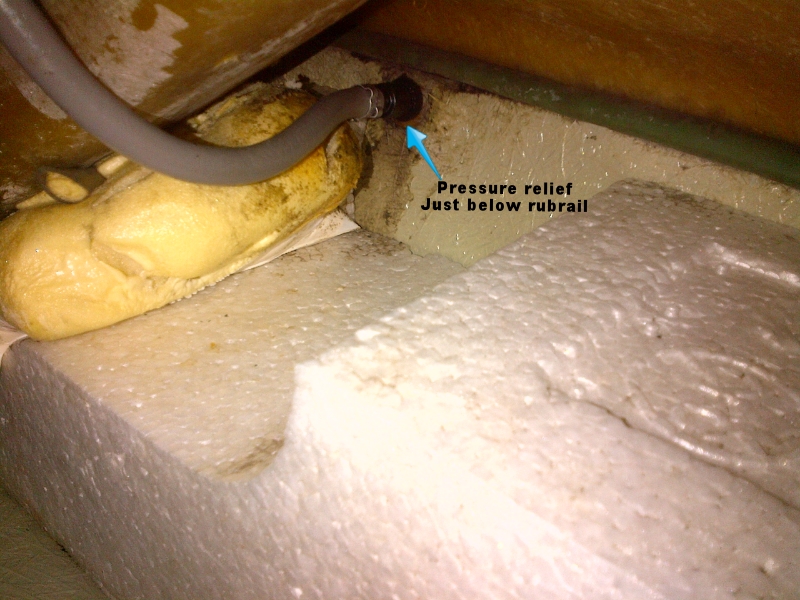

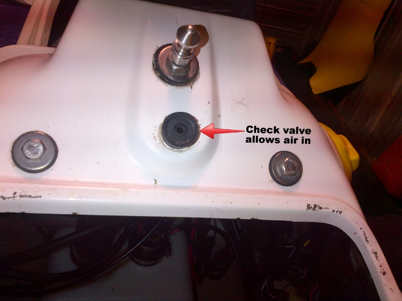

You fuel tank has a check valve and a pressure relief valve. check valve is to allow air in as the fuel level goes down in the tank, relief valve is to allow air out in case there is some pressure built up in the tank. To much pressure will flood the motor, to much vacuum from the check valve not working will make it hard for the carbs to draw in fuel. Both valves T into the one vent line on the fuel baffle.

Blairwill4 From what I saw after researching the valves. There is a fuel line that comes out of your tank and has a t - connection. From there the two lines split and at the end going out the hull is each valve. They both are seen from the outside of the hull just underneath the rub rail.
:agree:
The T connection goes on the Vent nipple of the fuel baffle. This is for an X4 hull, the GS has the check valve inside the hull by the steering mechanism.
