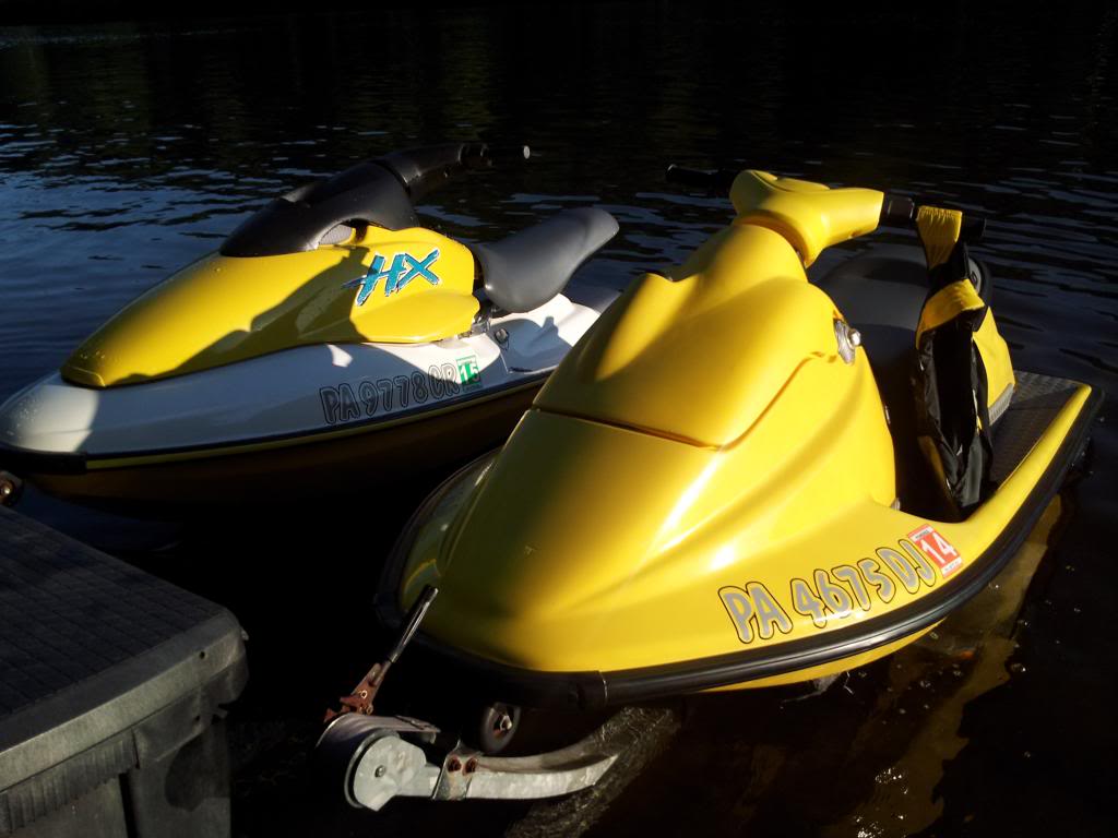

Welp guys, for the first time since I have owned the ski, she is in running order!!!
[video=youtube;z2tGUoHEW6s]http://www.youtube.com/watch?v=z2tGUoHEW6s[/video]
As some of you guys know, I bought the ski and it had been sitting a few years, who knows if it was winterized, pulled a compression test but it wouldnt run, but with 150 compression I was sure I could get it going. Did all the maintanence on it....
Pump Oil
Wear Ring
Neoprene seal
Oil Filter
New oil and oil lines
New fuel lines
Cleaned the carbs
Cleaned the hull
Spark Plugs and trimmed wires
I had an oil leak from the oil return line underneath the muffler, so a couple days I had to pull that all apart and fix the leak, but now she is fixed and running like a champ. I didnt rebuild the carbs, just cleaned them, and they were a train wreck but it seems to be running good so far! Adjusted the idle to my finely calibrated seadoo ear, lol, there is no tach on this model so I just set it at about what my 97 sounds like on the trailer, and adjusted the oil pump!
Note: When you are trying to start a ski, make sure the little ground wire from the rear ebox is connected to your battery or you wont get any spark
I swear I scratched my head for a good 10 minutes wondering why it wouldnt start, I had forgot you had to do this, my 97 XP doesnt have that ground. I guess the next step is getting some reg decals from the Doc and doing a water test!!! Still some summer left to ride!
Oh yeah, I know she looks a little smokey, I drained the old gas and put in 3 new gallons premixed at 40:1 while I bled the oil pump. It is 1000x easier that way, when the ski is running just open the oil pump arm full throttle and it will bleed to the carbs in about 10-15 seconds!!! Last time I spent 30 minutes doing it with the starter alone on my 97
