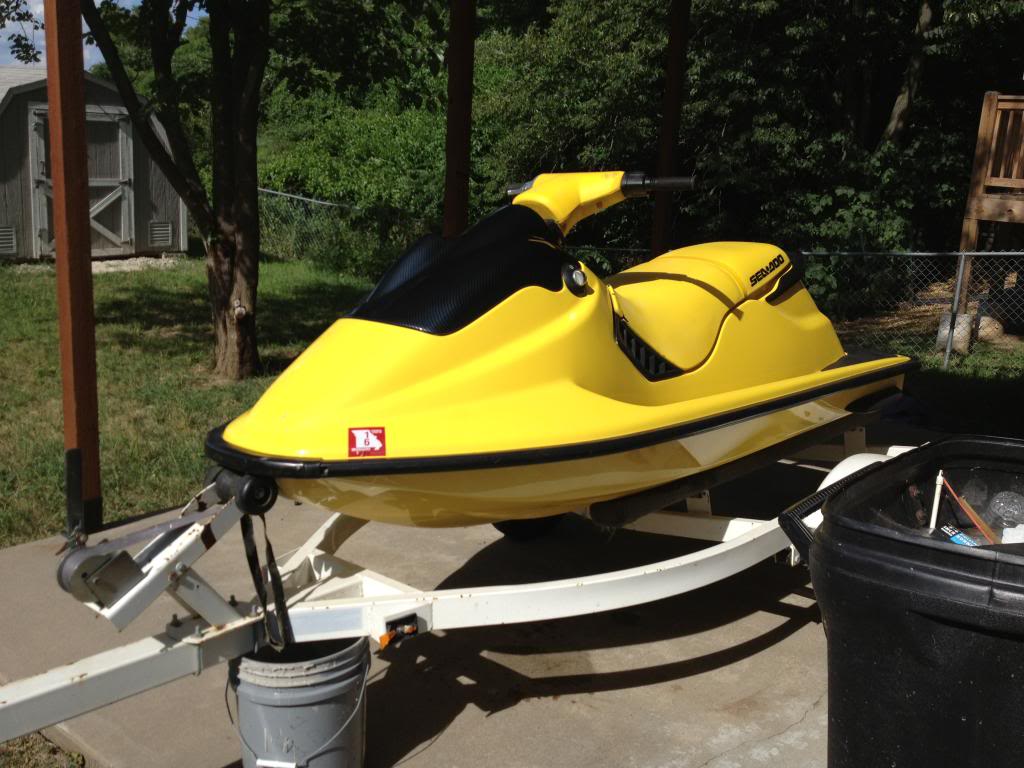

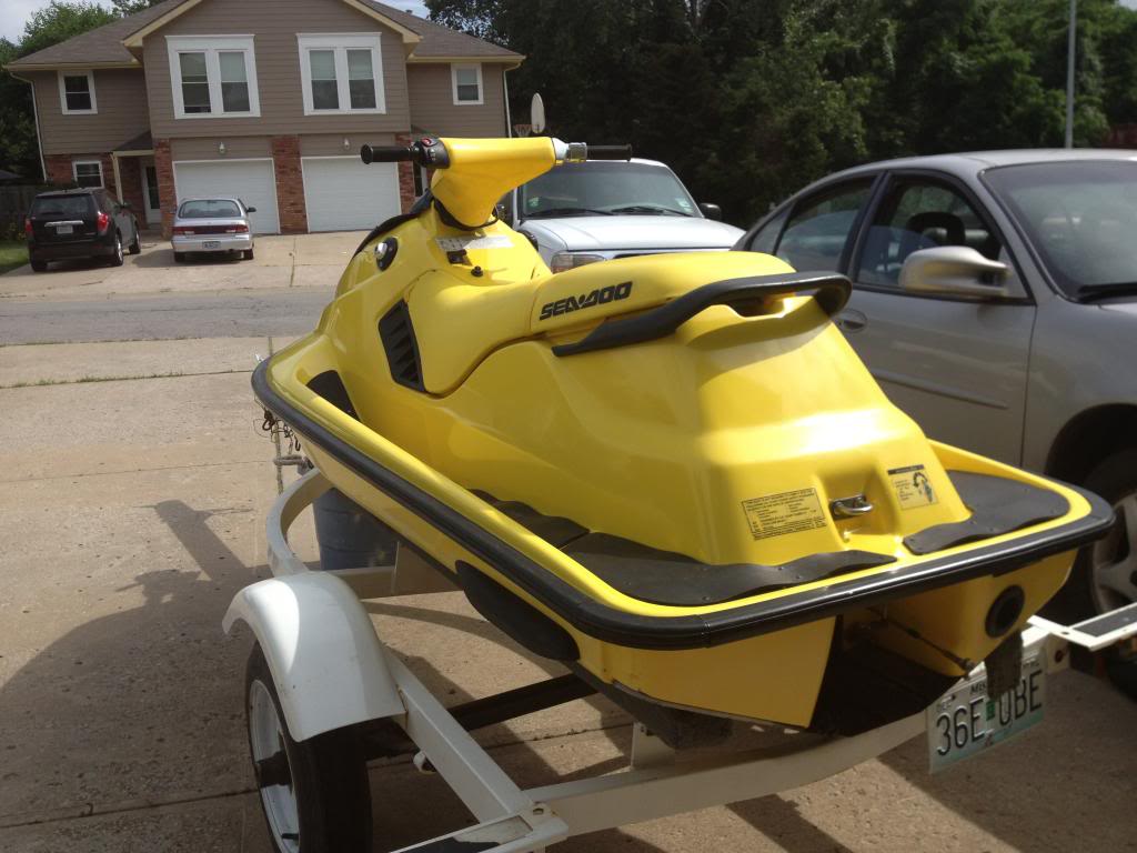

Haha it's nice you think the ski is clean, but the far away shots don't show all if the scratches it had on it, and there are a lot if them...especially on the underside of the hull, the foot rails and by the front registration numbers

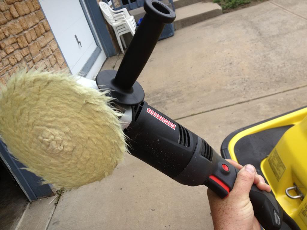

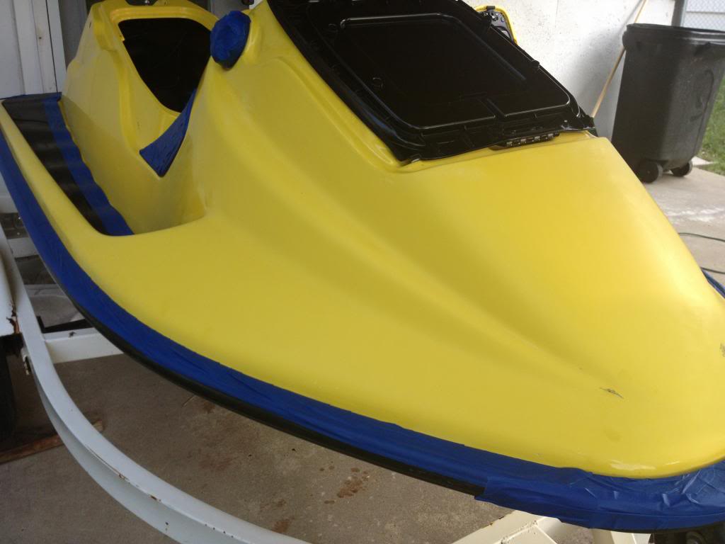

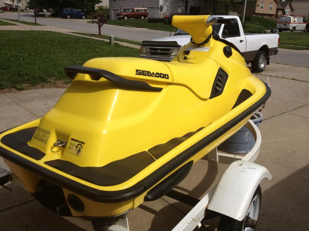

Welp, finally got up the courage to do some wet sanding, i was extremely pleased at the results of it and it really wasnt too scary once I started and got going. I really had a ton of scratches on this thing, it was like it spent its entire life tied up to a dock on a busy lake. I started with 500 grit wetsandpaper, then moved up to 1000 and then 1200.
Finished it up with this process of waxes/compounds. It was stuff I had lying around the garage as I didnt really want to go buy anything. I think it turned out great for myself, but it probably isnt [MENTION=51350]Jetskigoodies[/MENTION] quality of work as there are still a few faint scratches but 1000x better than before, especially this being my first time ever wetsanding anything. I only did the the top half as I am going to leave the bottom until winter because it needs a little gel cote work and I just want to do it all at once...
After wetsanding...
From left to right is the order I went to finish up...
Here is what I used to apply it
After Pics

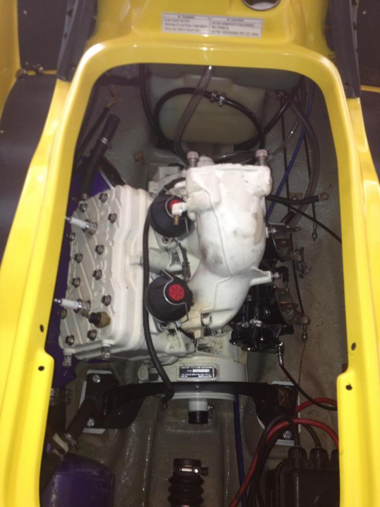

Here are a few more pics, I guess I could probably install the engine now, it is ready to go pretty much. But I recently have put in a new working VTS, replaced the start/stop button. Brand new fuel lines and selector, new oil lines and filter inclluding cleaning out the oil and fuel tanks...
Im going to take the easy way out and not paint the eninge or the exhaust....just too much work plus im not a professional painter by any strech of the imagination

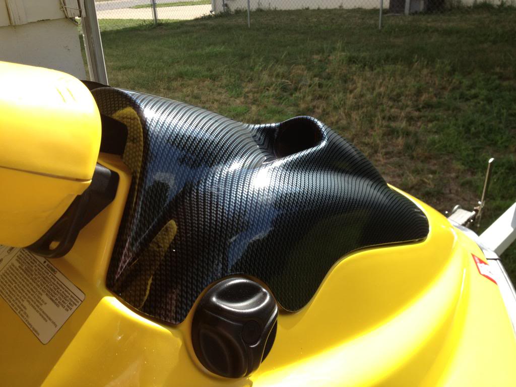

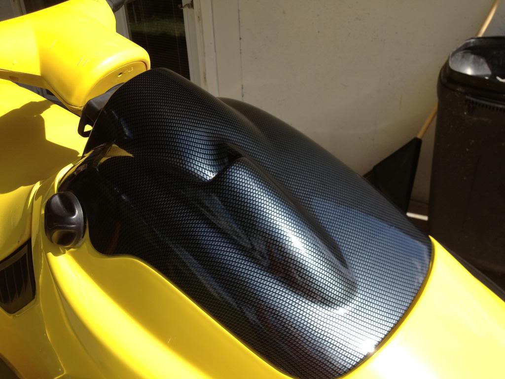

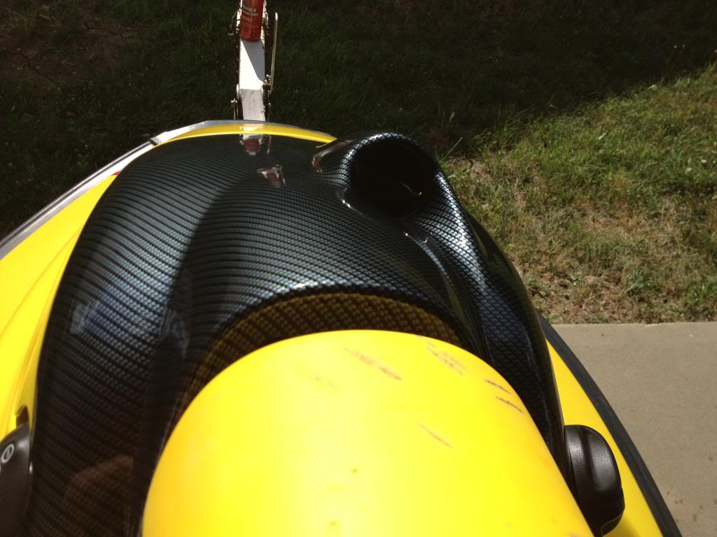

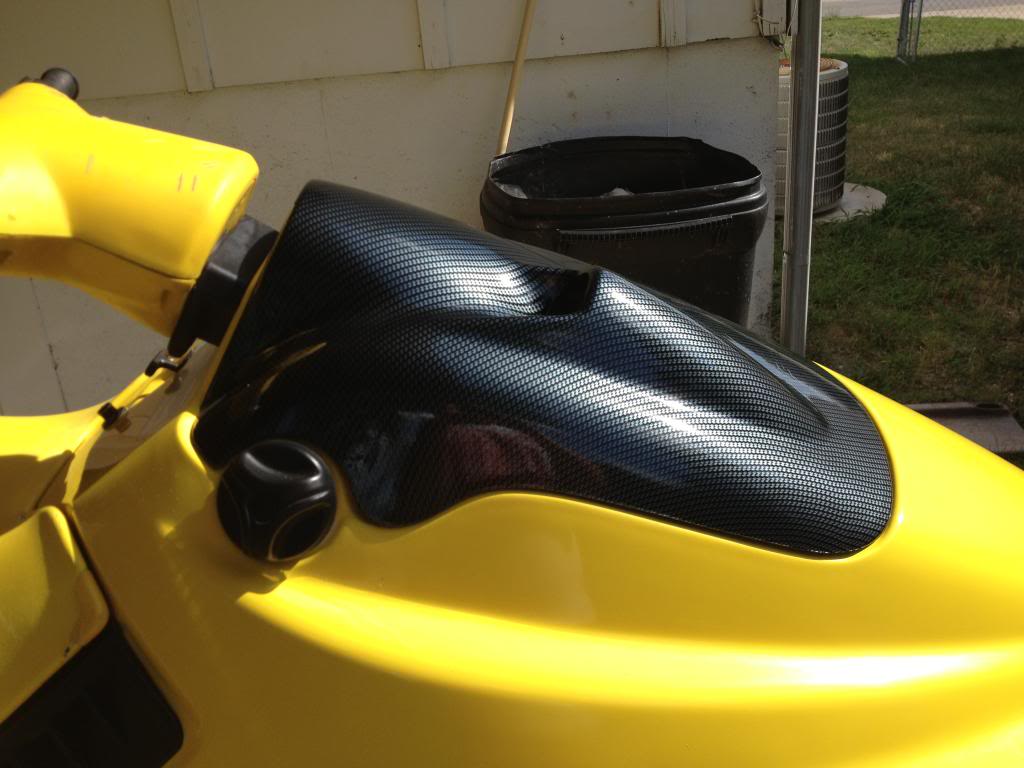

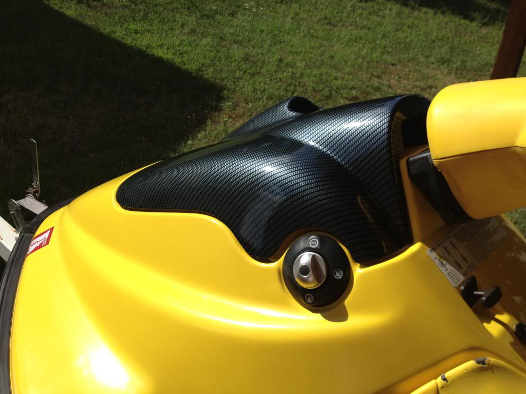

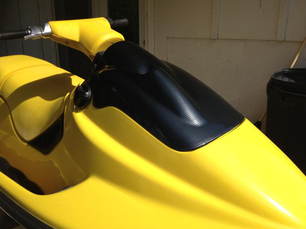

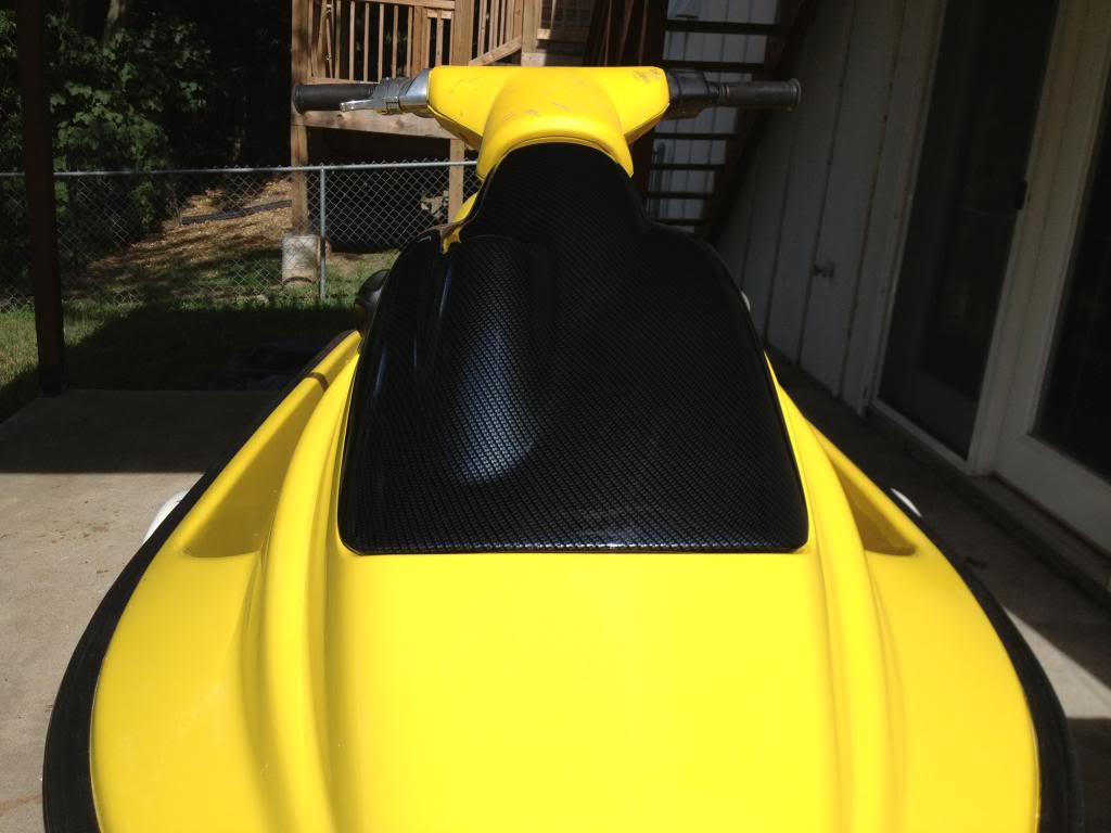

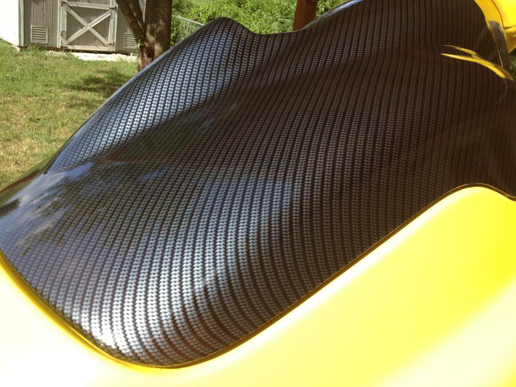

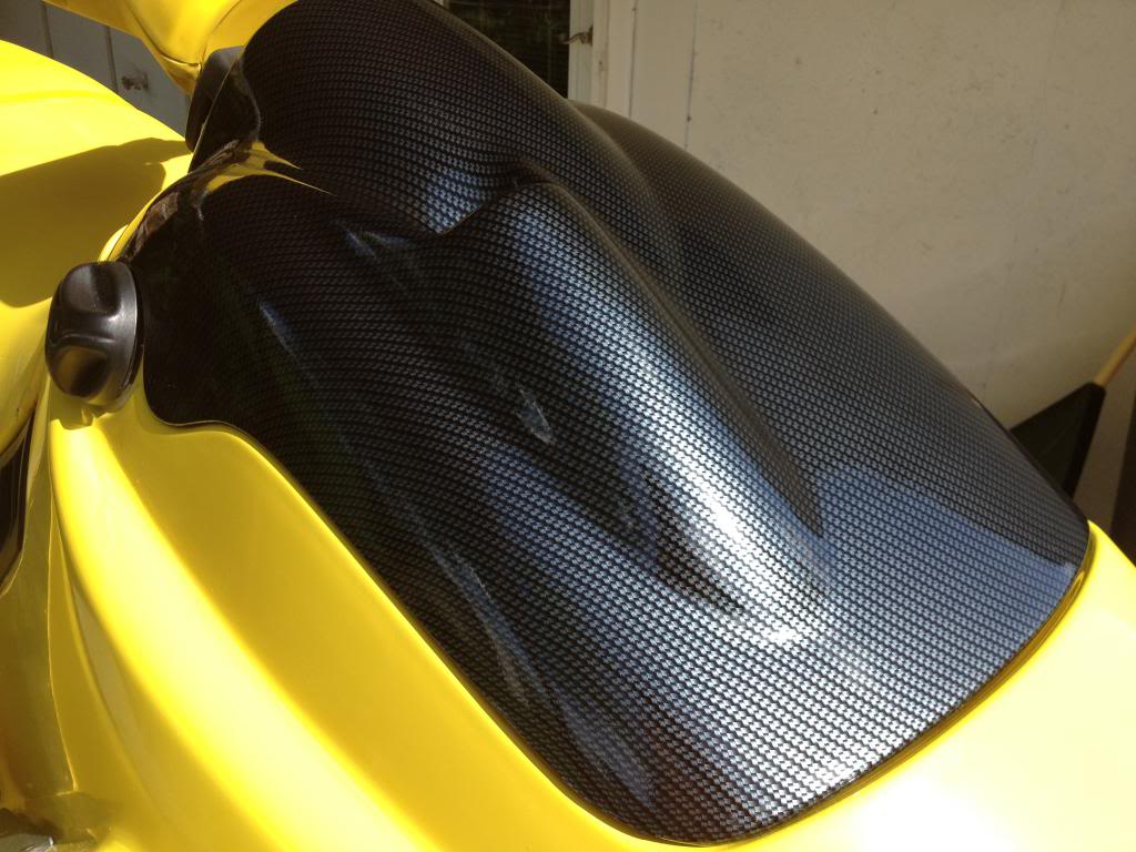

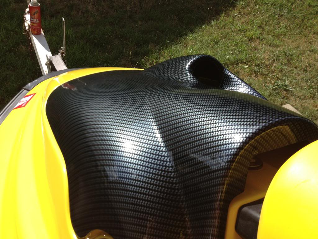

well guys, the time has finally arrived. I got the hood back today......and it looks friggin amazing. Here are some of the tons of pics i got on it today, it is just loosely placed in this pic. THe ski is almost ready to go, im trying to chase down and oil leak, and then put the driveshaft in and start it up and see what happens. EEEkkkk, the hood looks so good, now i gotta eventually do the handlebar pad mod and a new seat cover, i may even get the rear handlebar pad dipped as well. For those of you interested, the process that was done here is called Hydrographics, they do it to guns all the time. They dip the object in a liquid film that attaches to the object, let it dry and then he clear coated it so it is basically as sturdy as car paint. Im super stoked the way it came out!!
Someone found a guy who would hydro dip!!!!!! If anyone is interested, hydro dipping is not outside the realm of the average joe. I just dipped some ar-15 parts for someone. Not my favorite choice of colors or patterns (skulls over neon pink) but it wasnt my choice. The biggest issue is having the equipment to spray the paint and clear under / over the dip.
Its a fun product I encourage everyone to give it a shot.

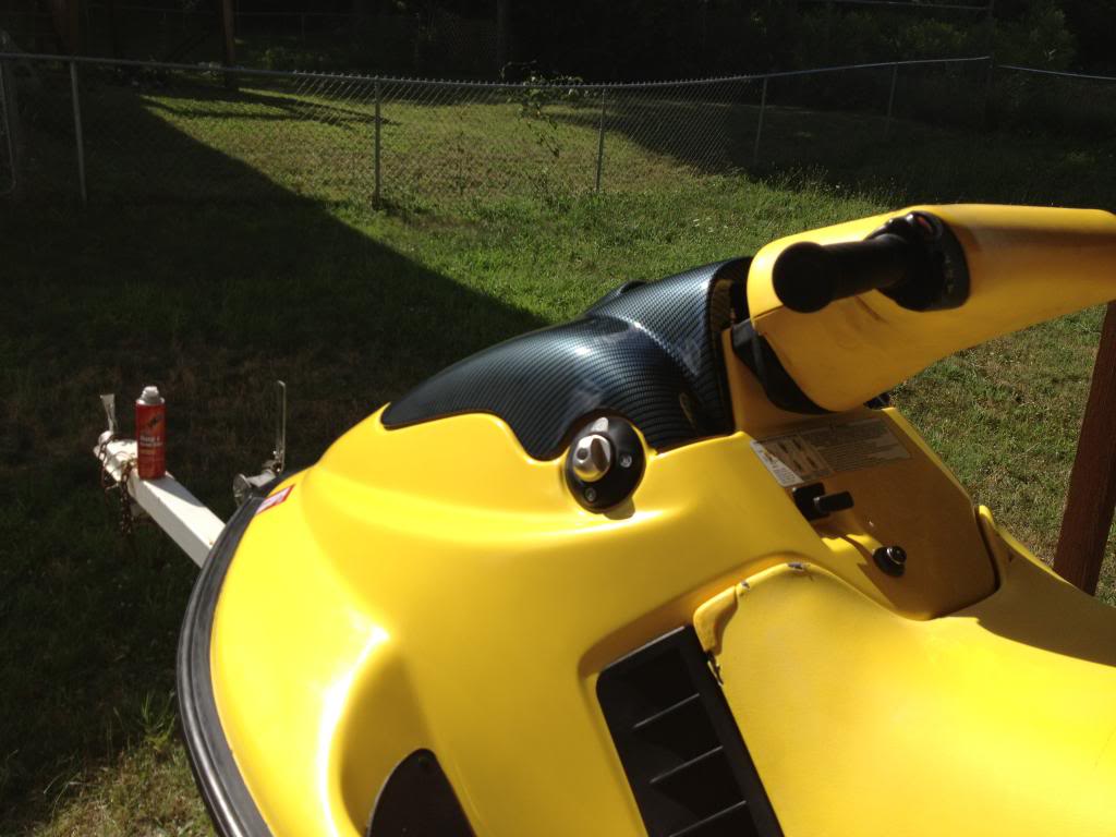

So who knows how to wire up a single gauge hood? I am wanting to use the multifuntion gauge in the hood, and maybe a few other guages on like the dash by the dess key. But all of the other connectors for the other gauges have to stay in the hood because they are all connected together it looks like. Am I missing something here??? [MENTION=51824]Matt Braley[/MENTION] [MENTION=51350]Jetskigoodies[/MENTION] [MENTION=41828]Minnetonka4me[/MENTION] [MENTION=57920]racerxxx[/MENTION] ...im sure you all know better than me. Calling the gurus before i put it all together...
Thats beautiful what did that cost?
Well I got the hood for free from a ski I stripped it off, and the whole process cost me $150 including the dip and the clear coat. He said it would be $120 if I wanted a matte finish...
As far as i know im the first one that tried it on a seadoo hood...
Seadoosource has a chart on gauge similarities. The wire colors usually stay the same over the years and identify function. You will need a pin tool if you do not have one. That hood looks great. I love that rare trigger throttle and block off plate also.
I have the multi-gauge in my hood and I put all the wires up in there. You will need to do some wiring to get it right if you want gauges by the DESS post. Since the elephant ear hoods have two holes for the wires to pass through you have to drill an extra hole in the single gauge hood, but since mine was an original yellow one I made all the wires pass through the one hole and I have a spool of large shrink tubing that I put around the wires. I do have 2 plugs that I tied up in the hull that went to the other gauges, IIRC. You need the pin extractor to remove the pins from the plugs to do it either way. I'll have to check in the AM to see if I can figure out how I did it, one of the few projects I forgot to take pics of.
The hood looks saweeet BTW! That gloss looks better than the matte finish.
Man that thing looks AWESOME !! I See why you guys get rid of the elephant ear triple guage hood it looks so much cleaner when you put the single gauge on there, I am not a big fan of the mirrors on the hood of a XP
I just noticed the title of this thread (getting old) Seadoo Rehab ! I purchased this entire ski just bcuz the hood is mint and mine is faded and cracked on my GSI
