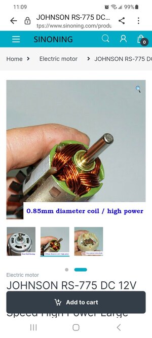

So far only a Johnson 3W0322 RS-775 motor has connect armature with 0.85 diameter wire. The one in the link has 0.40 diameter wire.

This picture and the next on shows what the correct armature and brush holder looks like. Oem has the same thing.
