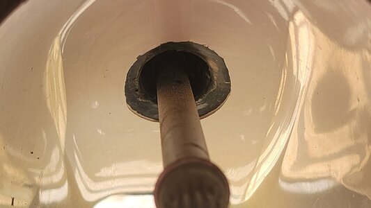

Well I bit the bullet and ordered replacement cables. I did find that the left cable had split and bent. Not sure if that's because it bound or if that's why it bound. I'm really impressed with the SBT replacement cables. They seem to be OEM quality. Everything went together fine but I really don't care for the routing. The cables seem longer than they need to be and as a result they seem to have extra bends in them to take up the slack. The left cable zigzags between the motors which seems to add extra bends that are at sharper angles than I would like. I rerouted the left cable to run along the front of the gas tank then around the port side of the port motor. This reduces the number of bends. It is routed close to the motor mounts so I made a sleeve of heavy-walled fuel hose over it so it can't chafe. I got the cables adjusted and everything seems to work correctly now.
I did have an issue with the starboard reverse bucket not locking correctly in the forward position. The little aluminum bracket was fairly well worn at the catch point. Also the "spring" was somewhat collapsed so it was the bracket was floppy. I could easily pull the bucket off the catch. The roll pin was a nightmare to get out and I could not remove the rest of the locking mechanism from the bucket because the "nut" was seized and just spinning. There is no way to get in there and hold it. Therefore when trying to drive the pin out it was hitting that mechanism. I was able to finally get it out with minimal damage. I couldn't source a replacement latch so I carefully filed the engagement point back to a reasonable shape. I opened up the spring to increase pressure and reassembled everything. Luckily it worked correctly after that though I did have to mash the spring a bit because it was too tight. All the mounting points for the shift mechanism were wallered out so I drilled them and installed stainless riv-nuts with a bit of epoxy for extra holding power. The previous owner or their shop more likely had installed rivets in those locations instead of screws.
Hopefully I can find time to take it out on a local lake to test it before I take it back up north. My fingers are crossed.
Another question I have now is that I found a loose hose coming off the top of the oil tank. It is the side that has a check valve. I have found some pictures online that look like that check valve is just left hanging out with nothing attached. Is this just a vent? Mine has a hose attached to it that runs over the top of the electrical box and is stuffed under the starboard engine. It doesn't look factory. I will attach a picture. It's the hose on the right. Can anyone confirm whether this is OK?

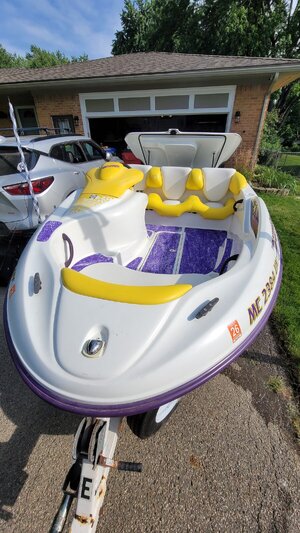

So I was able to get the boat back out on the water after replacing the shift cables. I took it to a local lake which was actually more like a pond. All I really wanted to do was check if it would get up on plane. Finally a success!! My boys and I did a quick lap around the small lake then took the boat back out.
Fast forward, we took it back up north to our place on Hamlin Lake. The launch we use on the lake is in the upper lake which tends to be fairly weedy. I tried to be very careful to get out away from the ramp without sucking in too many weeks. It seems I was unsuccessful. I faced major cavitation immediately and couldn't get on plane. I was fairly annoyed but still really hoping this was a weed issue and nothing mechanical. I putzed back to our dock where I tied it up and left it overnight. I was really busy and couldn't mess with it that afternoon.
The next day I gave my son the task of clearing weeds from the intake grates. If you haven't tried this on a speedster, it is WAY more of a pain than doing so on a typical PWC. Anyways, we took it out and with a little effort it was able to get up on plane and start ripping. This was all over the 4th of July weekend so the lake got pretty busy. I took the boat out a couple more times and it seemed to do very well. What a blast this thing is to drive, especially when it gets choppy. That is, as long as you aren't sitting in the bow of the boat.
After all the headaches, it seems that the reverse buckets were likely causing a good chunk of my problems. Certainly the other items contributed, but there was likely no benefit from changing the carbon seals a second time.
I'm really happy to finally have this boat moving. It's been a long time coming. Hopefully I can spend some more time on the lake with it this summer. Thank you to everyone who has contributed along this challenging repair. I really appreciate the experienced feedback and good ideas. This has definitely been a learning experience!!
