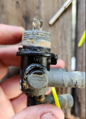

Wow, where had that ski been? That looks like a good candidate for a new fuel selector valveToday I removed and cleaned the petcock flanges. The boogered up one was completely blocked couldn't blow through it at all. Reemed it with a small wire dremmel brush then dumped smacked it on some wood till all the crud pieces fell out, sprayed internals with some deep creep, and I could blow through all passages when in the correct positions.
Initially couldn't blow through reserve and when I blew through the on port a chunk of something hit me in the safety glasses.
After cleaning it all out, on off, can't blow through any port. On reserve can blow in reserve and out the out. Same with on. Cleaned it up a bit more with a wire wheel, sprayed it with some deep creep, reinstalled.

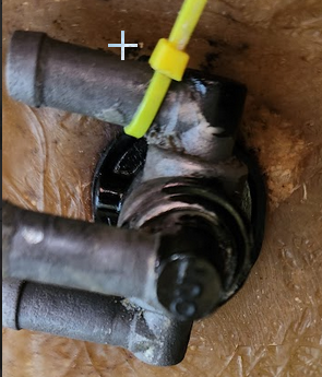

Initial state:
Reinstalled (yellow tie wrap reserve):
A simple pressure / vaccuum test could verify if they were sucking air. Which I will now do to verify no sucking.Because they typically don't "clean up" very well. The rubber inside deteriorates, comes apart and ends up in the carb fuel filters or start sucking air causing the engine to run lean. They are a 20 year old wear item. Don't let a $50 part cost you an engine.
Sounds good, you are correct, juts don't want to see something simple cause you grief.A simple pressure / vaccuum test could verify if they were sucking air. Which I will now do to verify no sucking.
The out line from the petcock goes to the fuel filter, then down to the carbs. So any debris would be caught by the fuel filter and never reach the carbs.

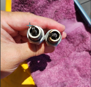

You can test those caps, Set yo it meter above 5000 Ohms and probe on each end. They don’t have to be exact but say 300 roughly each wayDid another sea trial today. Yesterday I added more oil to the mixture because the plugs looked ehhh.
No more water coming from cooling lines, and no more continuous beep; however, when I tried to get up on plane the jetski did start bogging down and misfiring, which led me to look at the plug caps/cables. My wires were pretty recessed so I cut about an inch off each one and reattached the caps and secured with the double wratcheting nylon ties.
While at the boat ramp I had no fluids in the hull at all; however by the time I towed it home, I had fuel / oil mixture in the bilge. I noticed it because of the color and smell.
I suspect misfire & then fuel return line is loose again allowing fuel to seep out of it.
These are the mag (left) and PTO (right) plug readings after bog out today:
I was starting to feel confident it was good to go after putting around at the dock. I guess not.
