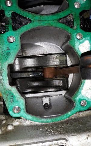

Thanks for the advice everyone! The crank moves very smooth and no gritty noise or anything.
No excess oil like a seal problem or anything else I can see.
Seems very solid and to me looks really clean... anyone else have opinions?
I was told the bottom was rebuilt, but the top wasn't, but it had the cageless bearings (ugh!) so that makes me wonder if any work was really done?
Can't imagine someone putting back those cageless bearings, but I guess anythings possible.
I covered everything and counted 34 per each side so I'm fairly confident I can leave this bottom end alone for (hopefully) a few years.

I flush the bottom end with diesel, work everything, roll the crank, rod bearings, dump it out and give a good listen. Push/Pull on the rod bearings then I flush again and blow out gently with compressed air and wipe what I can. It's gonna make noise because you don't have any oil in the bearings but you shouldn't feel any bumps and the rod bearings need to spin smoothly... no catches or roughness. Doesn't have to be perfect but nothing "glaring". A good bearing is a good bearing, age doesn't matter that much. Bearings are designed for 1000's of hours of use. So you're gonna doubt yourself and maybe wonder but don't spend the money without good sound reasons.
