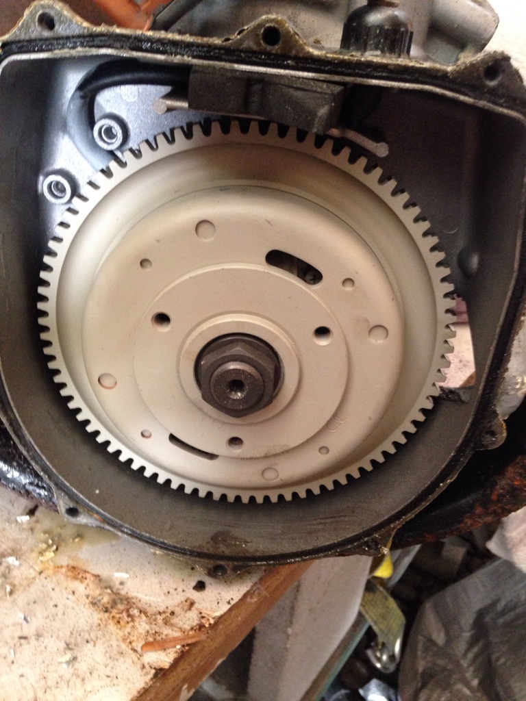

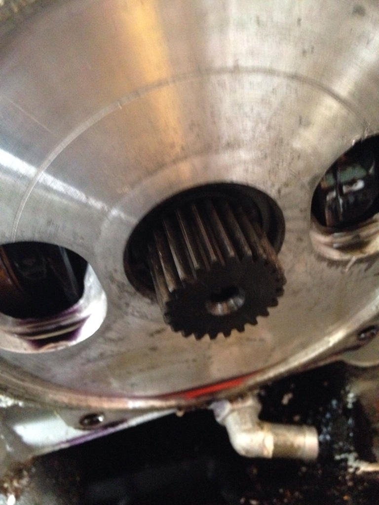

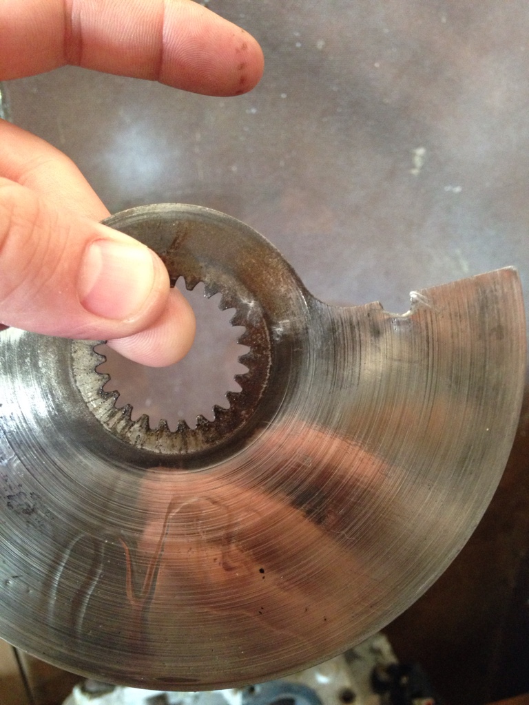

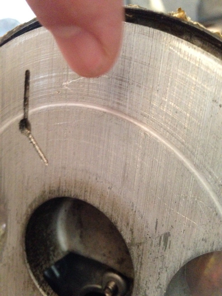

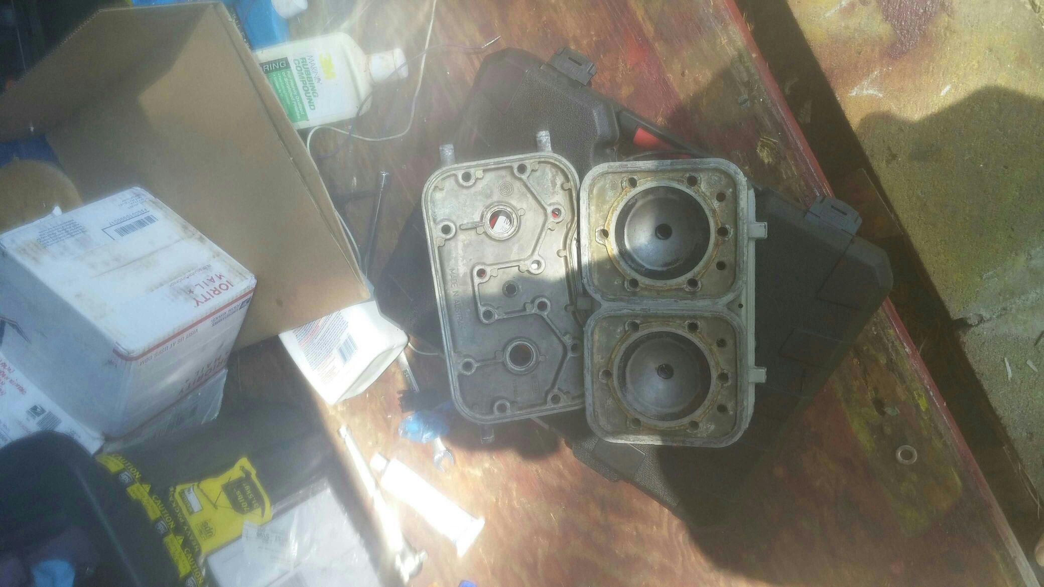

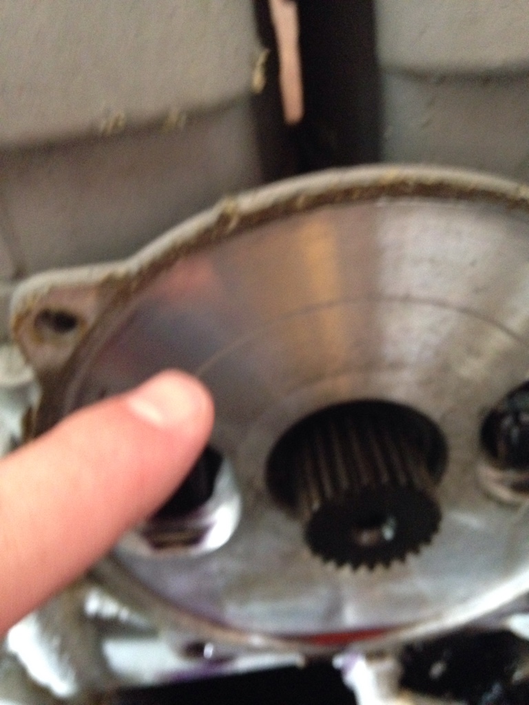

[MENTION=73220]1of500[/MENTION] pulled the motor on this salty dog last nite and haven't split the cases yet, however, got the exhaust mani off and peaked into the sides, and the sides of both Pistons look good, the top of the PTO piston and rings look good, the inner side of the head looks good, but I couldn't get the mag piston down far enough, which leads me to believe there's an issue under the mag side piston in the lower end, and that the broken/cracked side piece of jug was just fallout from whatever happened in the lower end.. Like if there was already a tiny bit of corrosion there and the disturbance from the lower end EFFED it up. Either way, looking to split it this week and also pulling the motor out of the HX due to a potential crank seal leak
