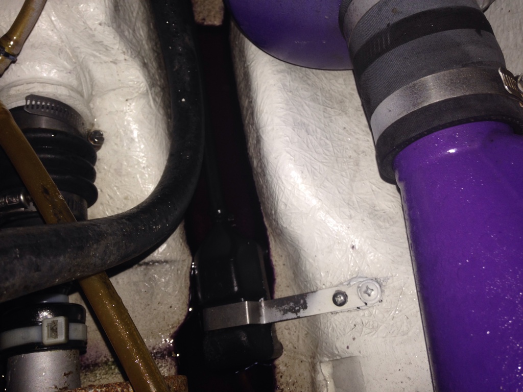

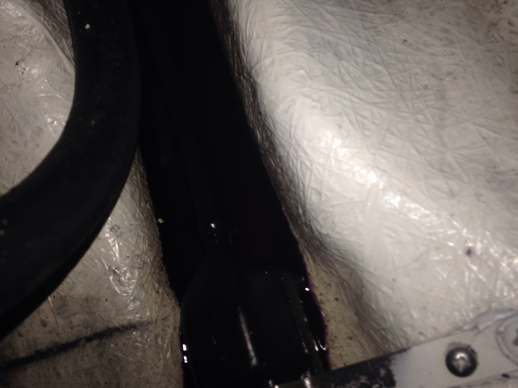

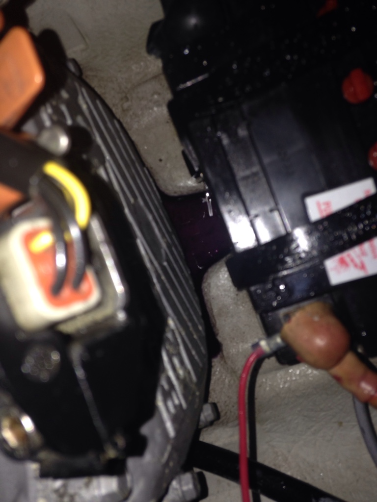

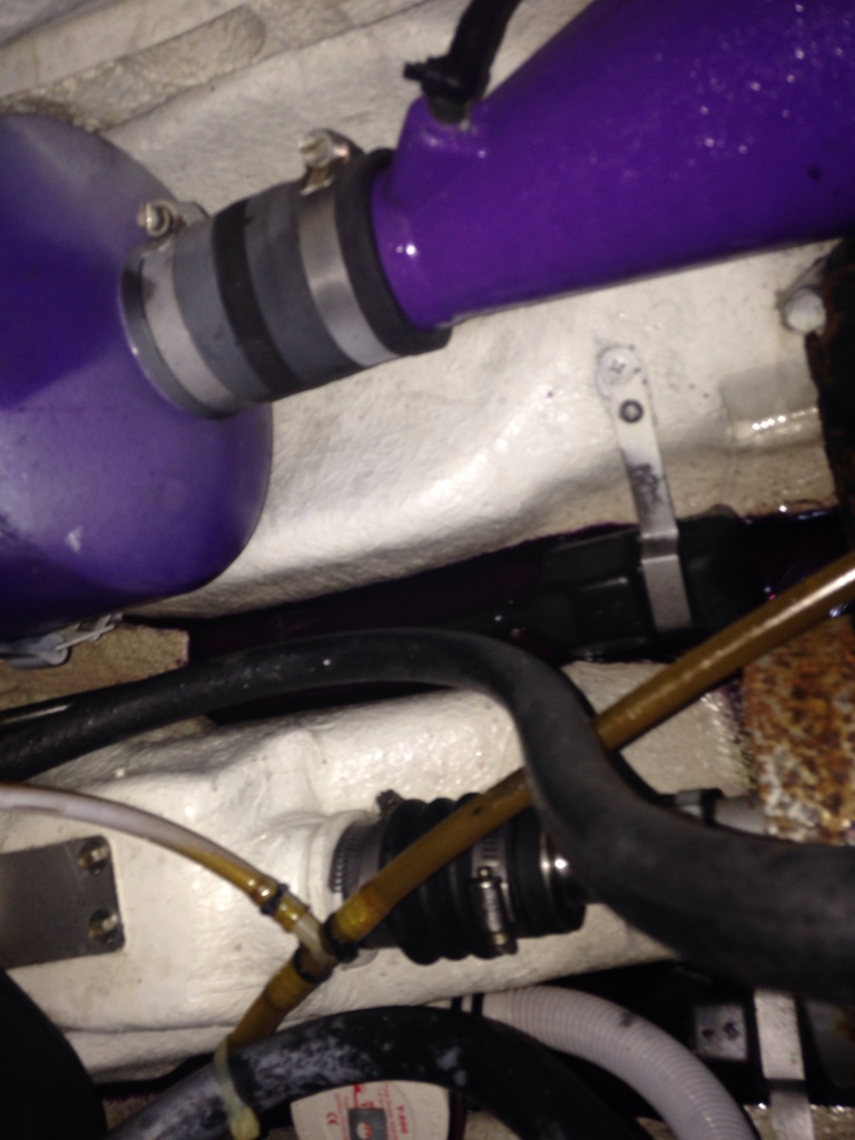

So I went to go pull the head off tonight and walahh... Hull full of my beautiful purple oil[emoji35] .. Checked feed and return lines that I kept with the tank for the rotary valve.. So.. Does this point to blown crank seals? Didn't leak from when the motor blew Sunday at around 1pm till after I closed it up at around 4pm on Sunday.. Thoughts?

Get those Phillips head screws out of there and put some rivets in

Oh what? In those bailer clips? That came like that, I never touched that..

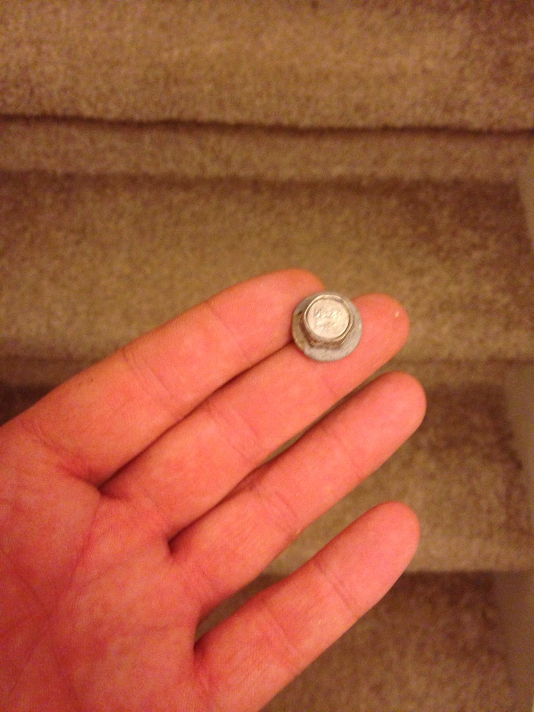

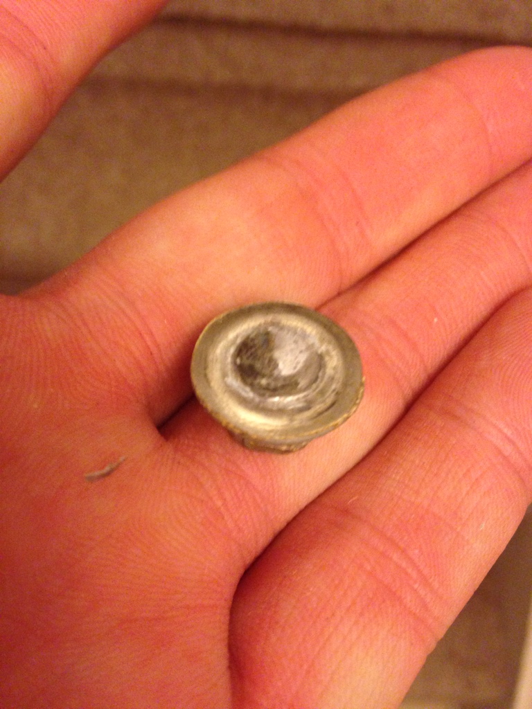

So, I got ALL of the head bolts out EXCEPT ONE. It broke flush with the head.. What are my options?

And, at this point I'm just curious to get into this top end, so BESIDES shipping the whole thing out, or before I do that, what would one of you guys do to get this ONE head bolt out? Would an easy out work? Should I drill it out? I haven't taken all the other bolts out yet, I just got them loose.. Do these bolts thread in down lower so this head will just pop off since the bolt head is broken off, or is it threaded into the head?
