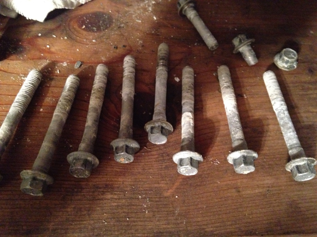

So out of curiosity, no ones chimed in, I'll be drilling the three broken bolts (no heads on them) out tonight I hope, but even after I do that, where does this head split, [MENTION=51824]Matt Braley[/MENTION] , is it at that top area I pointed to, or the bottom? All the heads I saw for sale on eBay had those two tabs ON THEM while it was off, so I'm assuming the bottom one?

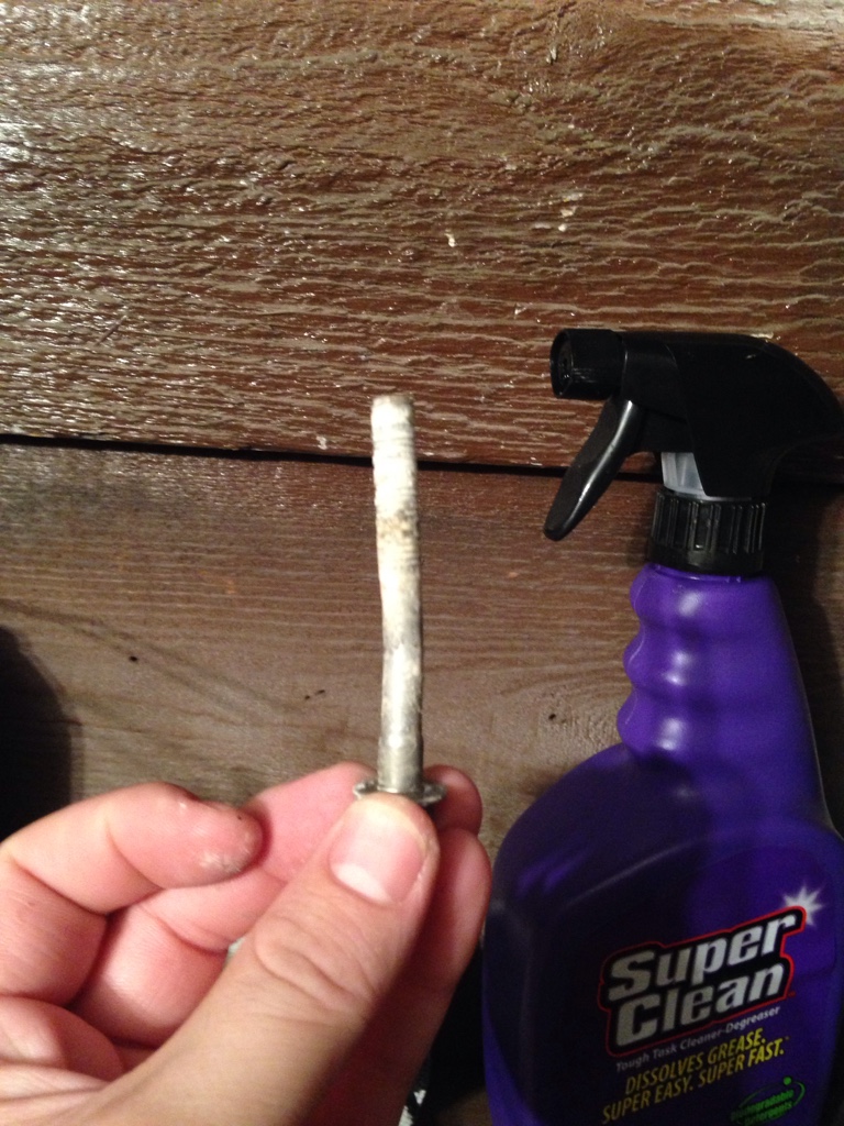

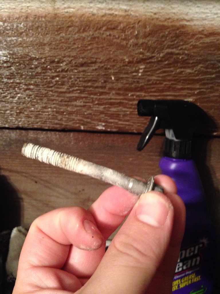

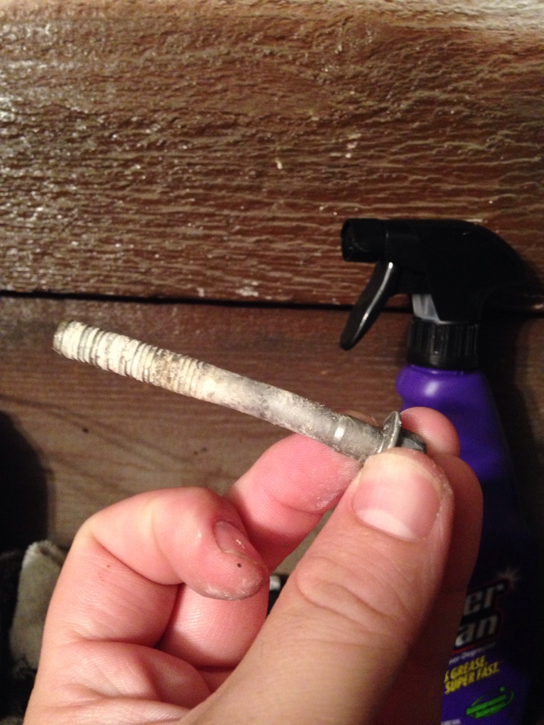

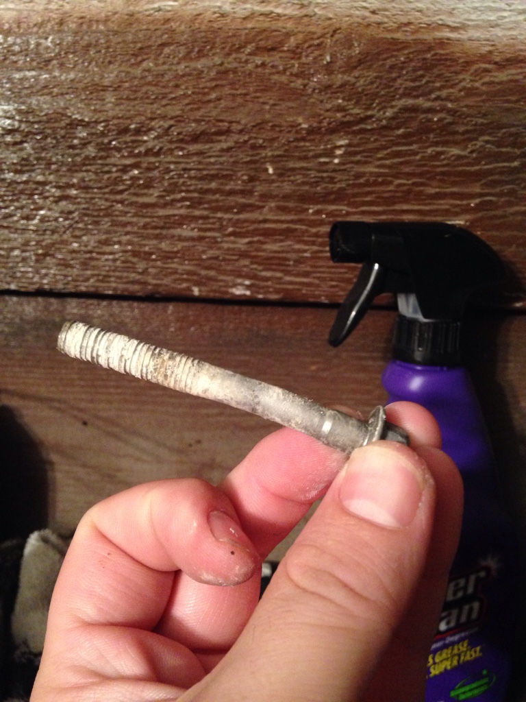

Yea I will eventually. I just wanna see how fugayzee'ed this thing is.. Also, something INSANE must've happened bc I backed these bolts STRAIGHT OUT and two of them had bends in them
A few degrees on a cheater bends the crap out of a bolt

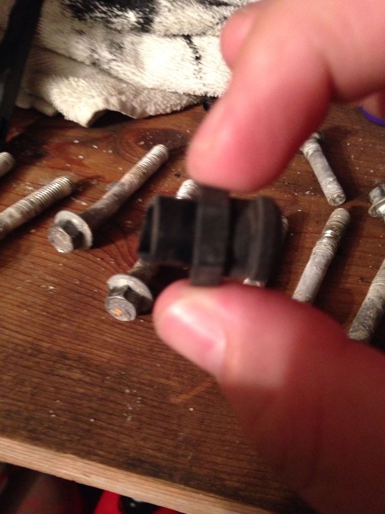

Well me and him are gonna have a word.. Look what else that son of a schnikey did..
Well I tried keeping my hand on it as a guide the best I could..
It will be ok. I have a good 720 head I'll sell cheap picked it up and don't need it anymore
