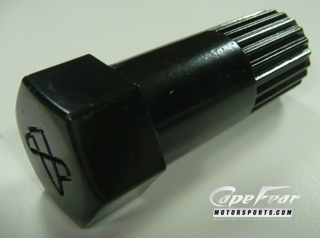

I was going to get the one off of SBT for like $14. Racer, that one says for 580-587 will that exact one work for the 720?
They're all 140mm impellers the splines should be the same. As a matter of fact, I probably bought that one sooner than 96 when I broke the impeller on my old 89sp.
