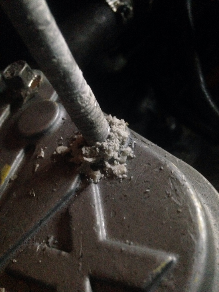

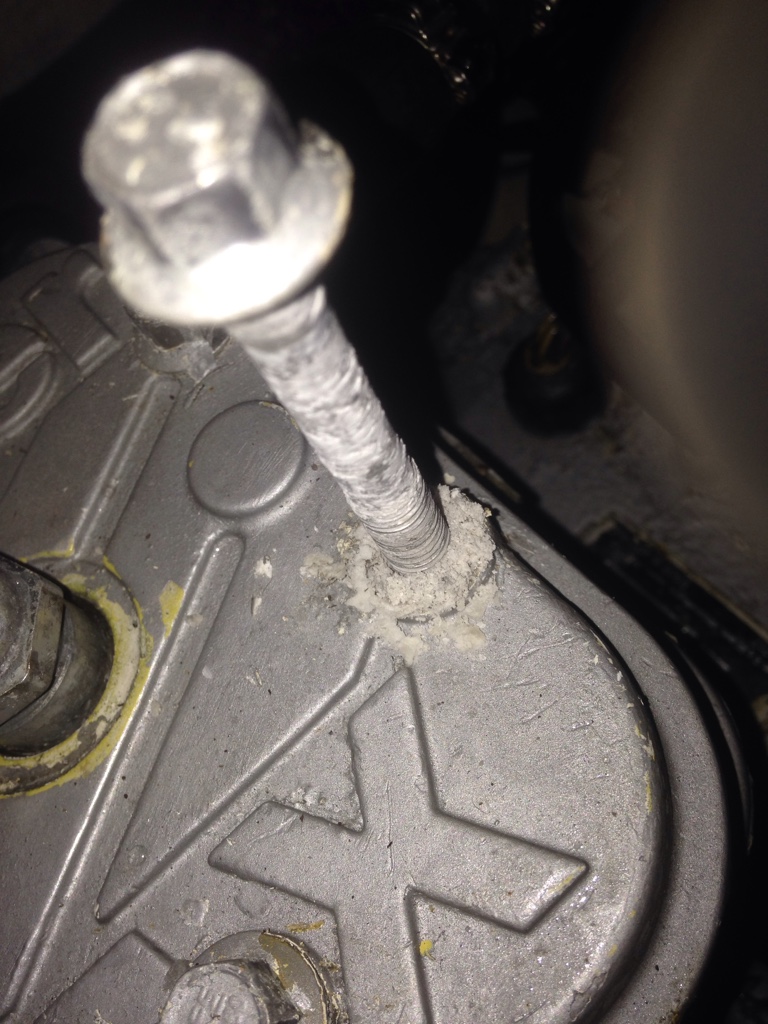

Bro you don't even want to know.. It took a good 5-10 min per bolt using a 2 1/2 breaker bar..
Not even close to done. Two other bolts snapped and I still got like 3 or 4 left

This thing is NOT coming off. Is it supposed to separate here or here? Just say top or bottom because my brain is toast by now
So I have a
Total of 3 bolt heads that snapped off, regardless, they aren't threaded thru the head so this head should still Pop off right? I don't know WHAT was used to put this head on, but I just used a breaker bar, a 2x4, and it still hasn't budged. Any ideas? Bout to hit it with a sledgehammer lol
The head is most likely corroded to the broken bolts.

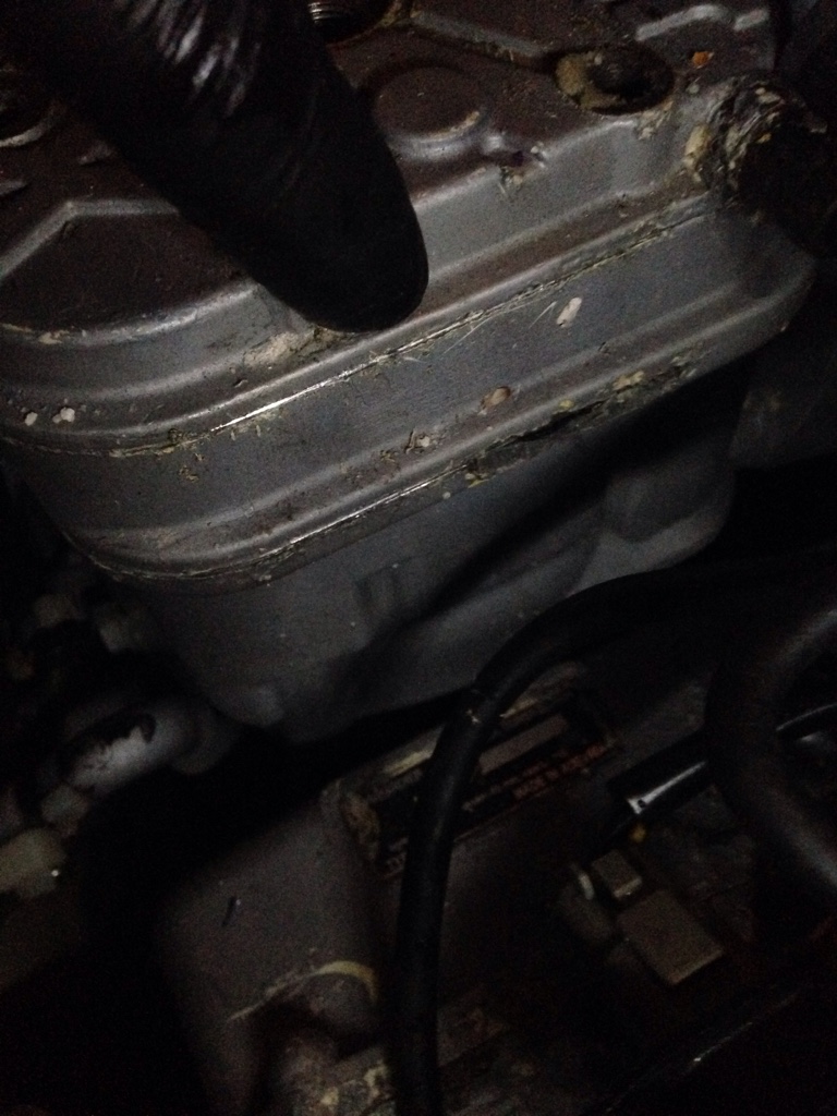

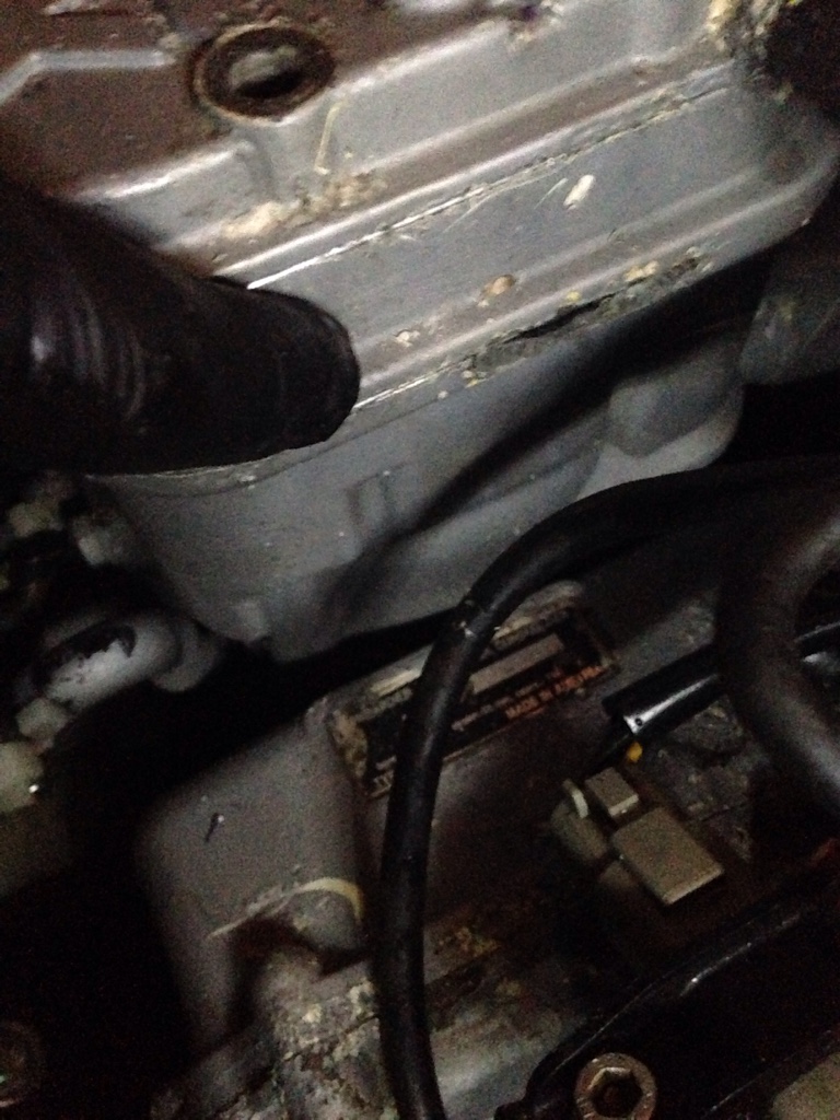

Yea well more chunks of metal came off last nite also.. Although the rear cylinder wasn't blown, it looked like it was starting to have a bulge like the front cylinder.. Although my beeper works(I test it after every run), I have a feeling this thing got kinda hot for it to bulge like that.., that, along with not just the corrosion when I took the head bolts out, but actually a bit of wet sand on some of the threads. I bet this motor is loaded with sand, even with being flushed and fogged religiously after EVERY run.. [MENTION=73220]1of500[/MENTION] thanks for all of the help.. It's nice to bounce ideas off of someone outside of the situation. Thanks bro
I was going to say check for a blockage somewhere in the cooling loop. It looks like the metal split from over heating or corrosion build up.. or a combination of both. I've seen quite a few busted in the exact same manor as yours but they were all caused by water freezing and expanding.
