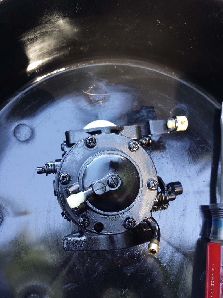

Carb is tore apart now. The gaskets really held it together like glue. The needle valve is stuck closed probably why it wouldn't start but otherwise carb is really clean. PO probably drained all gas before parking it. Need to order the carb kit and the needle valve then I'm assuming it will start right up.
Why do none of the rebuild kits come with the valve and seat? Are they all different or something?

IT'S RUNNING.
Starts right up, no effort. After I rebuilt the carb I put all hoses back where they were. Wouldn't start. I looked further into my rebuild instructions that came with the kit and one part on the very tip end of the round fuel pump was labeled fuel Inlet so I put the fuel Inlet from the portable gas tank there and put the pulse line from the nipple hanging out the side of the round fuel pump and it starts right up and runs great
