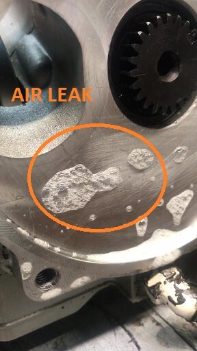

Easy enough to put 5 psi on the rotary valve chamber and see if it leaks at all. Just be careful NOT to over pressure those lip seals. I pressured one up and found leaks at the case partings. I peened them gently and got them to seal. :D It was leaking air but might not have leaked oil. Remember that.... air is a different test that oil and that must be considered if the leak is very very slight.
Ah ok, so I can get the block off plate kit and pressurize to about 5PSI and if there are no leaks then I shouldn't have to pull the entire engine apart?

I was not referring to the engire crankcase just the rotary valve chamber. All that takes is a crimped hose on one end and a pressure hose on the other. :) The Crankcase can be tested as well. Good luck !!

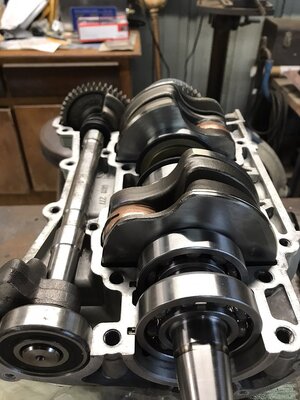

About all you can do with the crankshaft is check movement on the crank rod bearings and feel for roughness on the crank bearings as you rotate it. That is gonna be relative to your experience. I've heard some noise at times that I didn't like but found a new crank sounded the same. Absence of oil will do the same. If you feel bumps or any difficulty in turning the crank or rod bearings hanging up the crank needs to be redone. You can split the cases and buy a full gasket kit. That will allow you to inspect more closely the crank bearings and the balance shaft bearings. This is what it looks like. :D Good Luck.

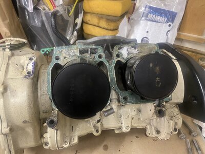

I pulled the engine today and started breaking it down. A few observations;

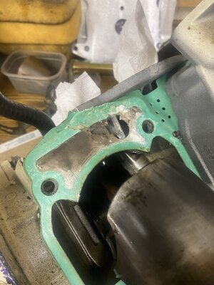

  • The case to jug gasket has a tear in it for whatever reason.
  • The PTO cyl has obvious signs of scoring on the piston, but almost no signs of damage on the cylinder walls.
  • The PTO piston oil ring was jammed on one side.
  • The PTO side, down in the case, has a lot of oil in it. It's about half full of oil.
  • The MAG cylinder and piston has no sign of any issue. Which is strange because that side had low compression. Perhaps the torn gasket on that side was a contributing factor. It's hard to say though because the tear was on the outer edge.
  • The crank rotates perfectly smooth. It has no signs of play and makes no sound while rotating.
At this point I think I have no choice but to crack the case open and replace seals. I don't know why this amount of oil would be present in the case.
Tear in gasket:
Both pistons looks good. No melting:
PTO side, is half full of oil:

Sitting that long the parts may not last anyway but you might get lucky. For the test I'd only put around 5psi on the rotary chamber. I'd also get the oil out of casing and clean it up before testing. Good luck !

Test the rotary valve chamber "before" you disassemble the engine. If you are concerned about the outter seals in the engine case I'd just test the case as well. No sense in opening a can of worms and creating problems unless you need to. I got a bunch of those lip seals brand new. :) Cheaper for me to buy the full gasket set than the gaskets I need so I end up with a lot of new parts.
So I’ve already removed the jugs, but I think i should be able to test the rotary cavity even in this state. I’ll drain the oil out of the case first though. I’ll pressurize to 5 PSI, no more, and see what happens!
