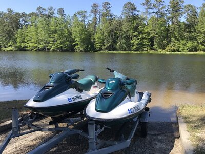

Hey man! Yeah, this one looks identical to the one on the right in this picture. It has the green bottom. And it looks just as clean too.
