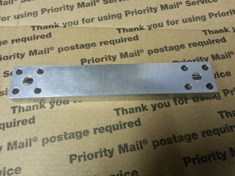

Triple X Buckshot fuel rail

Looks prettt nice! I really hope my measurements were close enough. The mantra close enough for government work usually suffices. We shall see...
If they are off you are going to have to sell me those novi 48s[emoji14]

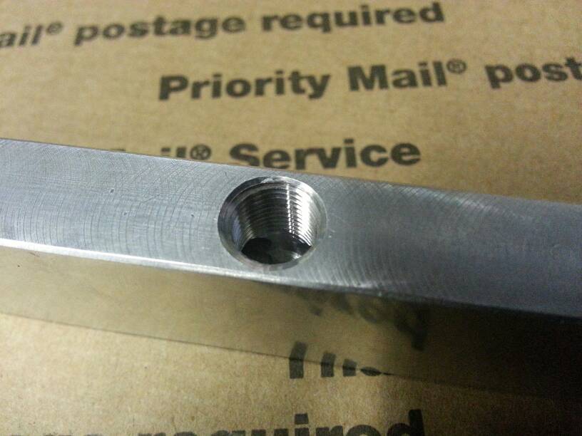

Only number I changed was the filter hole. You called out .280, 9/32 is .281. That's a standard end mill, I plunged in to cut the pocket rather than drilling in. Just preference that's all.
Glad u were able to produce from the drawings. It looks like u were even able to put a nice chamfer on the filter holes. I didn't have a great way of depicting it or annotating the drawing but looks like u nailed it anyway.
Couple brass fittings, some screws, mikuni filters, and cpl orings and the thing should be good to go. Really not sure on the size of the orings though for the filters.
