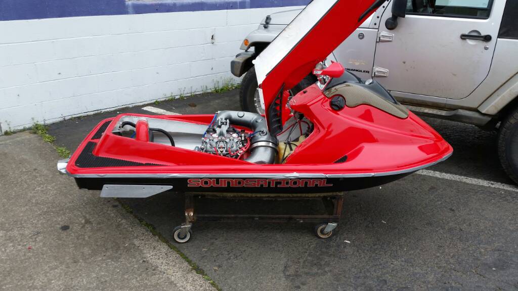

Got a little bit of an update here. I had a custom base gasket made at .086 and had the sleeves tweeked to elongate the ports a little to where they should be. I now have the motor ready to be finished, though I'm going to sandblast the head and cylinders back clean cause I got a powder coating system for Christmas
