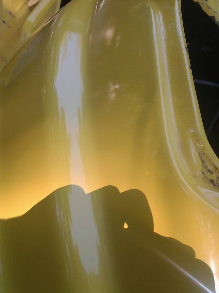

Yeah buffing by hand in general is next to impossible. Gotta go the machine route.
I have found the 96 xp gelcoat tends to clean up the best, well at least for me. Hand doing it though would be horrible. I spend hours using drills and a d.a. As for painting the inside my fiance's brother used a bilge paint that is resistant to oil and gas and it look really good. Some of those decals leave behind the adhiesive, so there we be grey spots every, the best thing we have found is aircraft adhiesive remover. The stuff is amazing.
I'm actually following your method. I used to go the 3m route, but the time involved for the results it yielded. And I have my reasons for hand buffing the bottom guys. I don't want it too waxy and I want scratches on the the bottom that run perpendicular to the hull so it will help with straight line tracking. The only reason I hand buffed the top deck is because I was tired and too lazy to go get my buffer :p

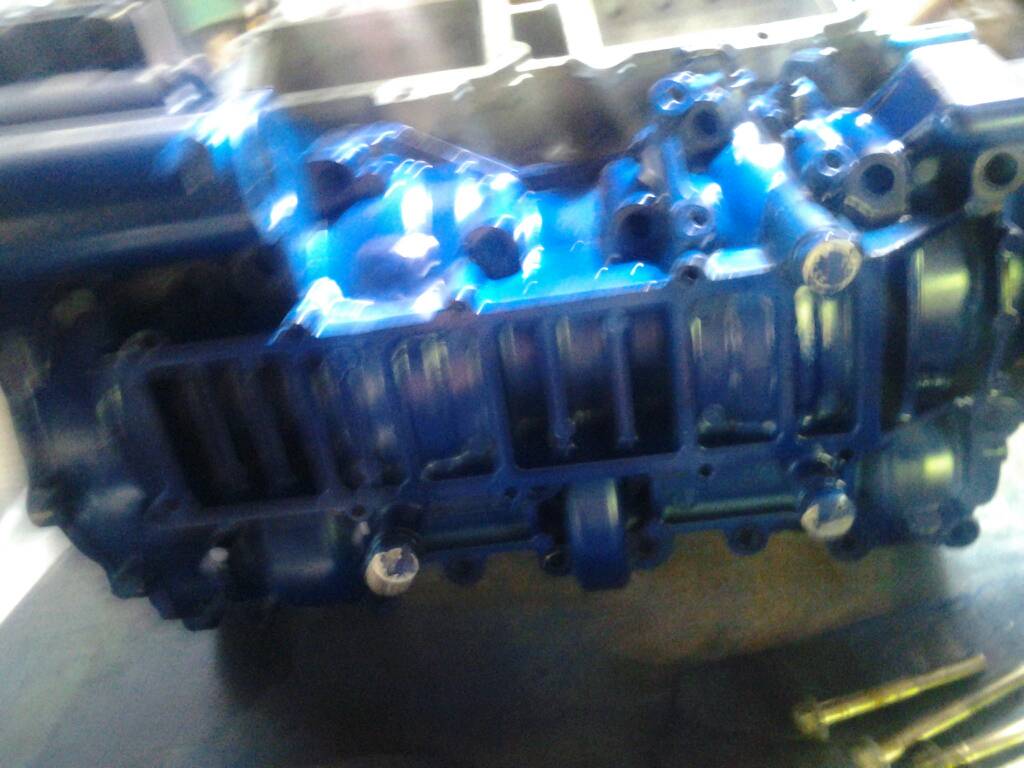

So my Hondabond came in today, so I got the cases permanently sales together.

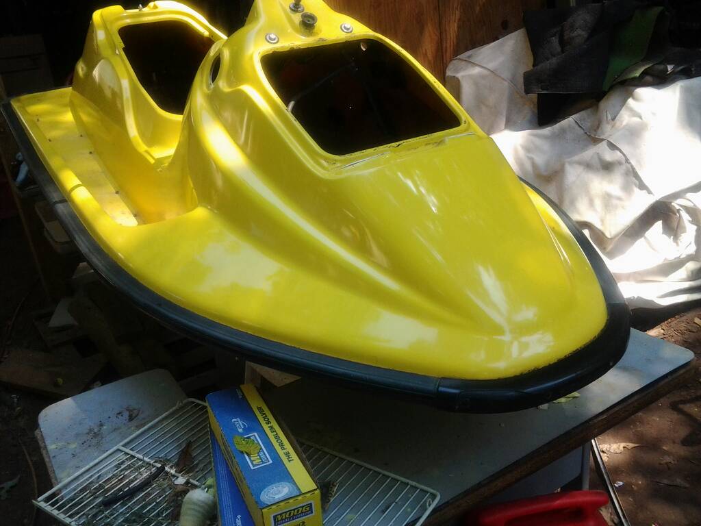

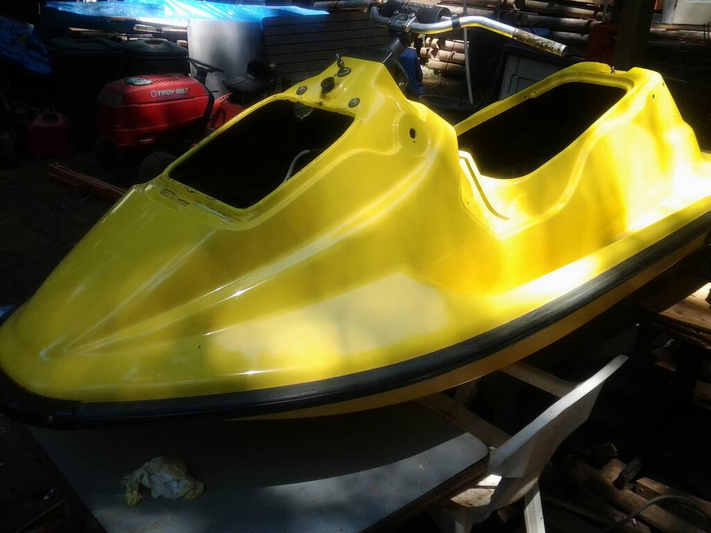

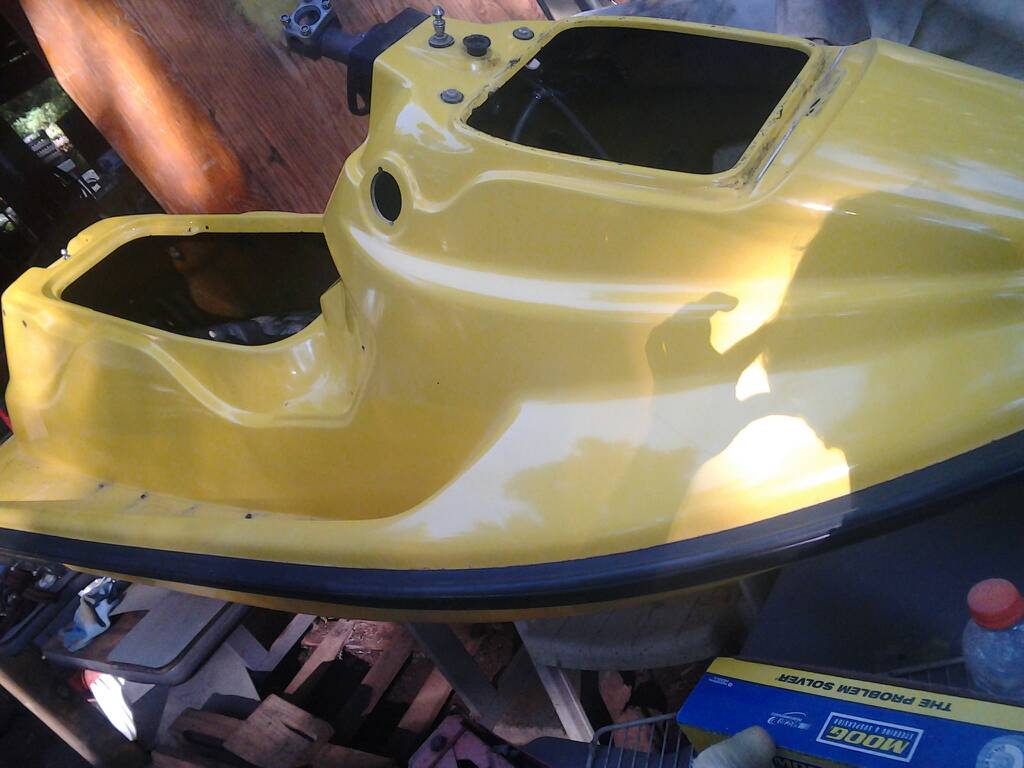

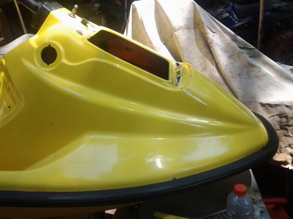

OK I know it's been about a week since I updated this, been so busy it's not even fun.

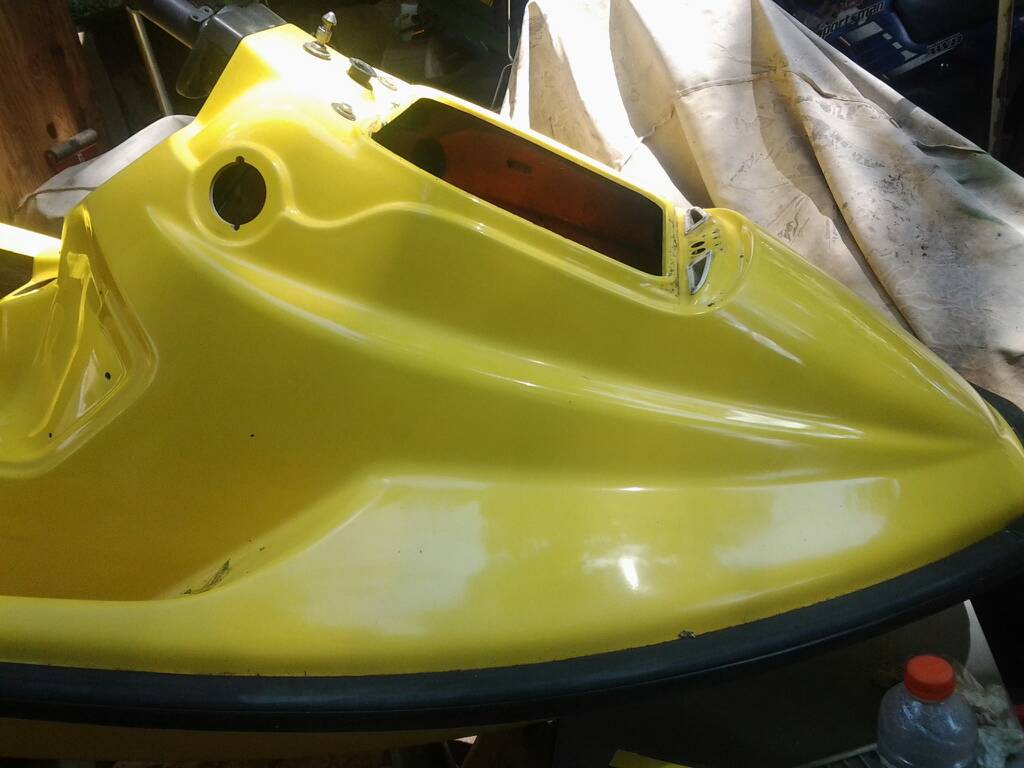

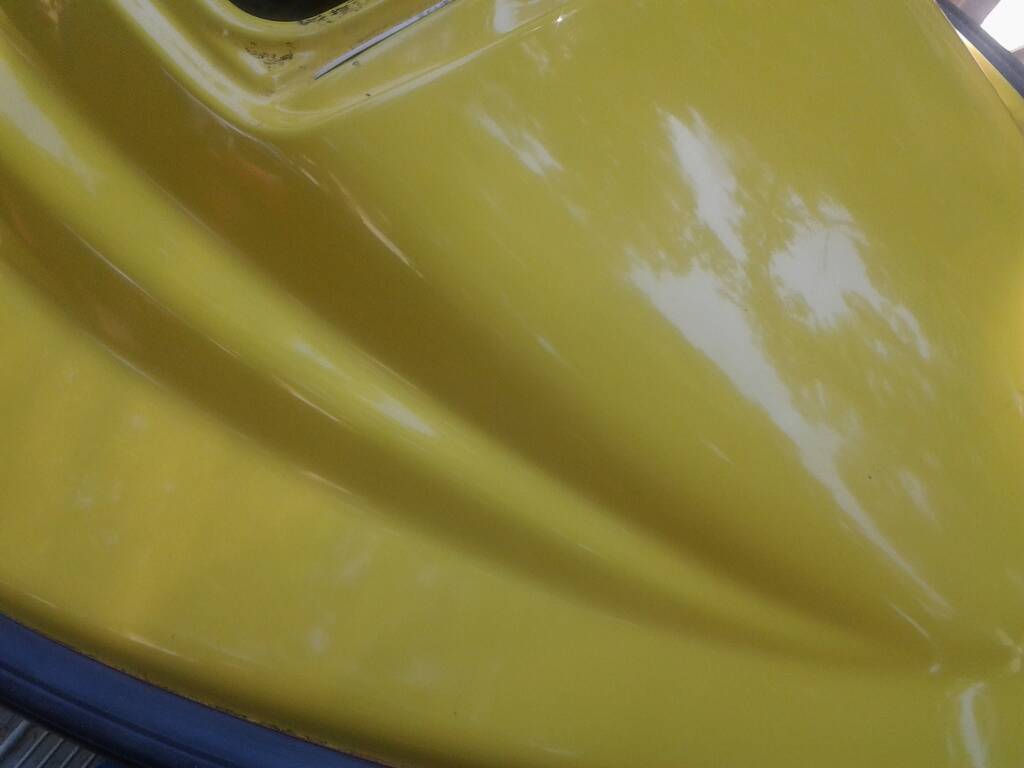

I got the top deck buffed with the first round of heavy cut cleaner. I think this thing is gonna come back absolutely beautiful.

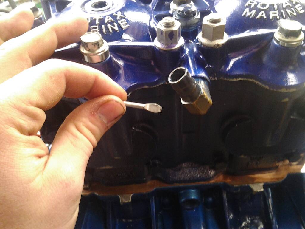

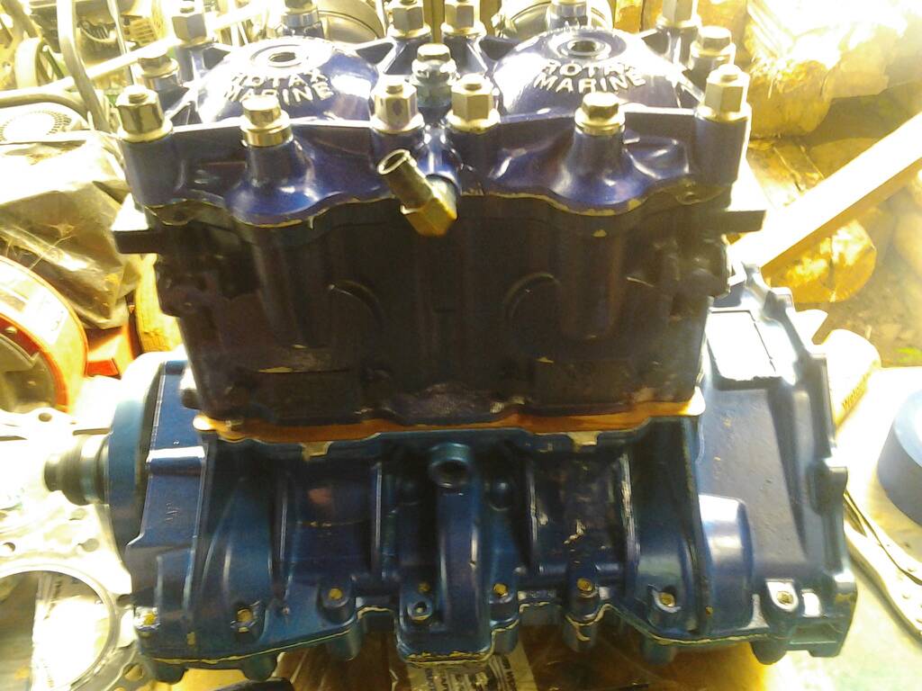

I also got the motor dry mocked
And measured the squish clearance. It was 0.055. [emoji33] can you say detonation city? Not to mention throwing off my port timings.
That's even with a massive base gasket. So I'm gonna either have to find an r motor head or have a stock head machined.

The base gasket I've already got in there is a copper 0.067. It's got to be addressed in the head so I can put a smaller base gasket in so my port timings won't be off for bottom end power.

And in other news, medium cut cleaner is done for the right side of the hull.

Yep I'm using his method. I used to do the 3m rubbing compound way but that was a lot of work for not as near as good of results. The only thing I do differently is I go ahead and wet sand the border of there the decals used to be with 320 then 600 then start on with the heavy cut.

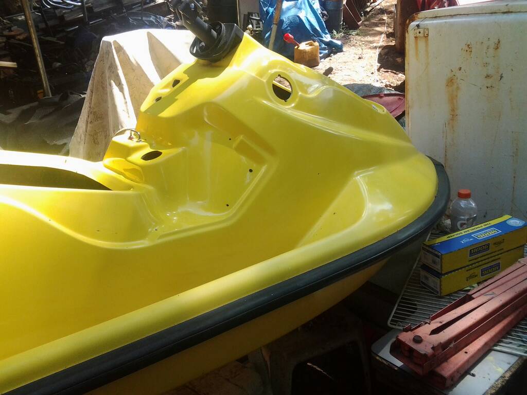

In other news I finished the medium and fine cut on the hull yesterday, all now is the swirl remover and the wax.
You can see my new handle bars in those pics too. I'm gonna be flying the adrenalin racing cover on them since without help from Dan this thing wouldn't be coming together.

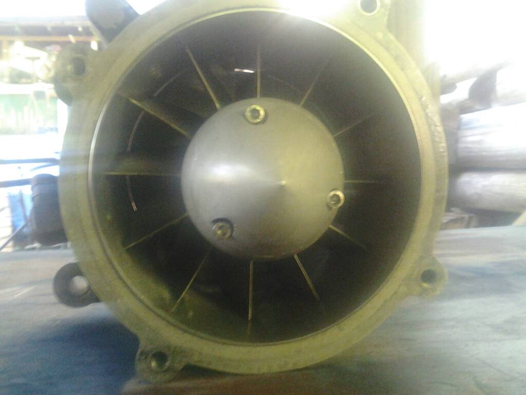

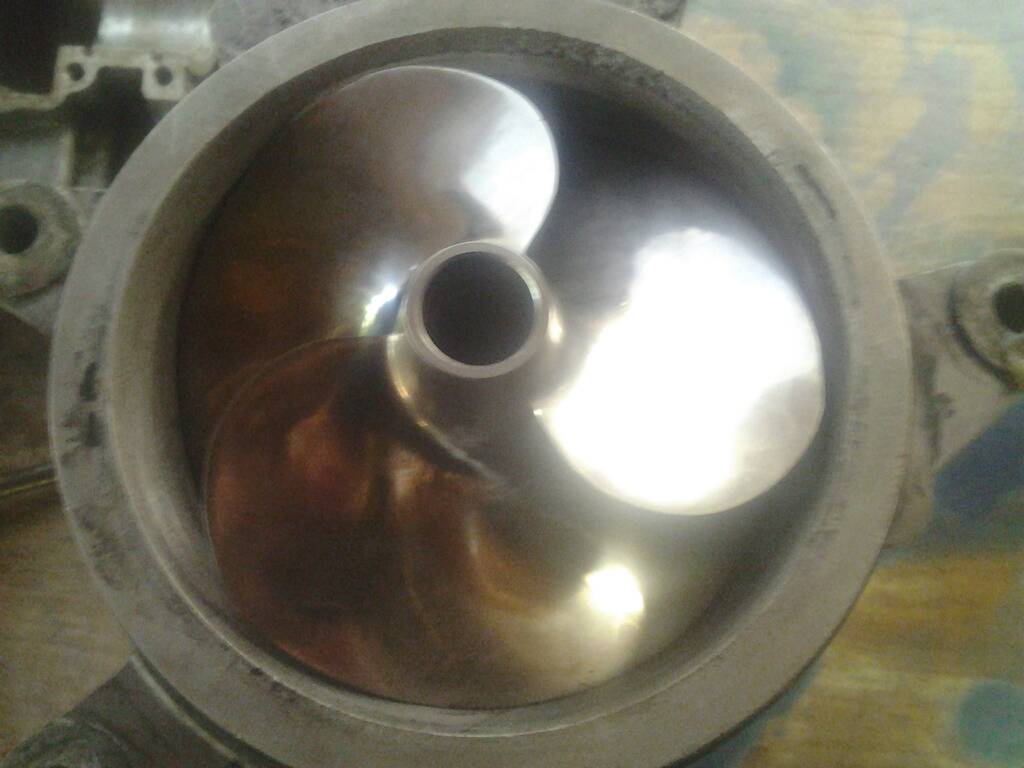

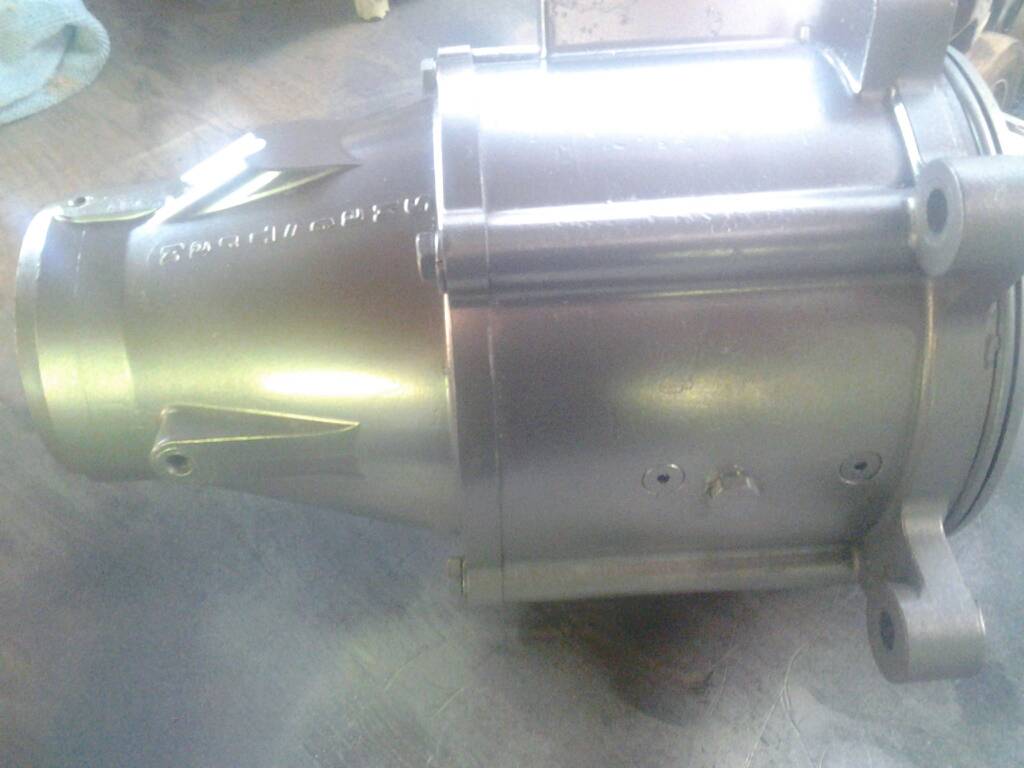

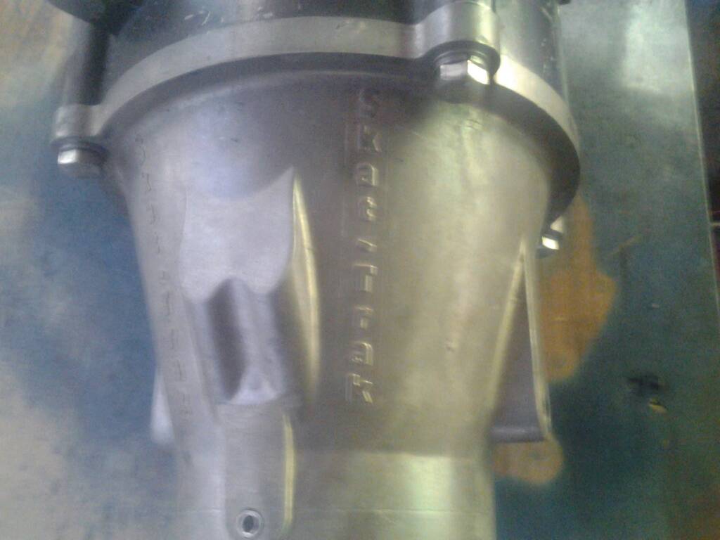

Also cleaned up the Magnum and installed the super steep impeller.

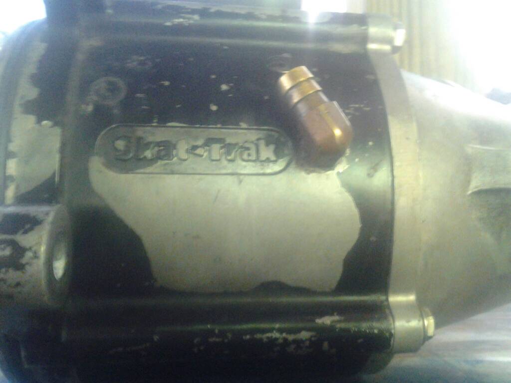

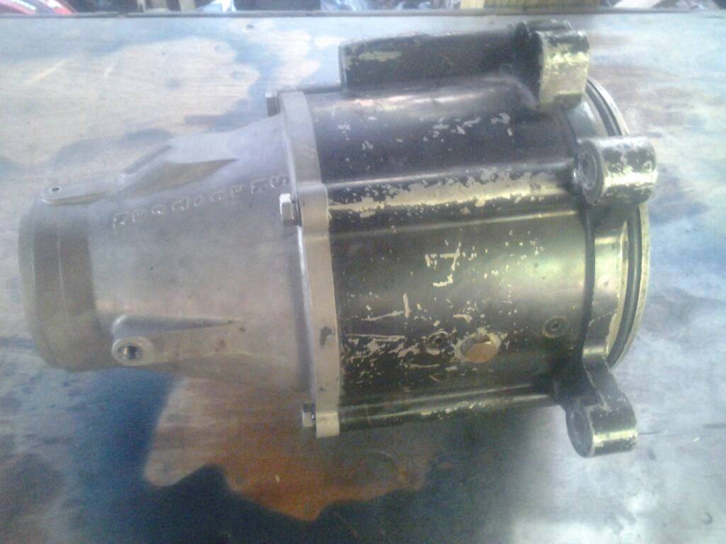

Before:
Impeller
After
Just gotta the fiberglass done and I can start throwing this thing together.

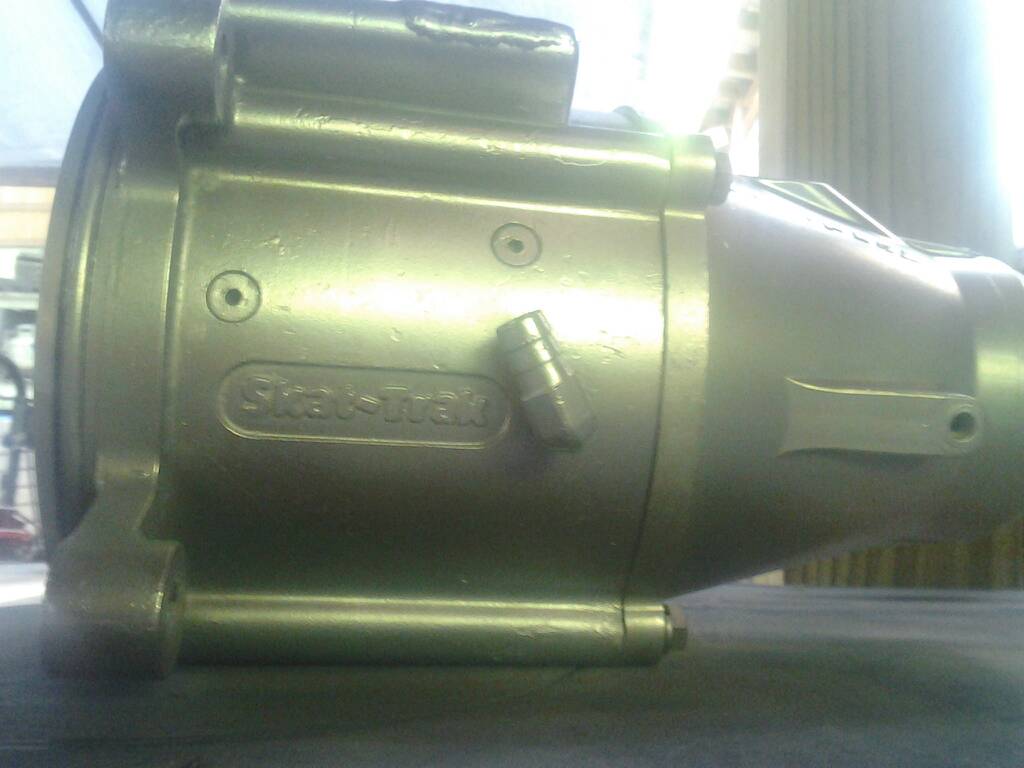

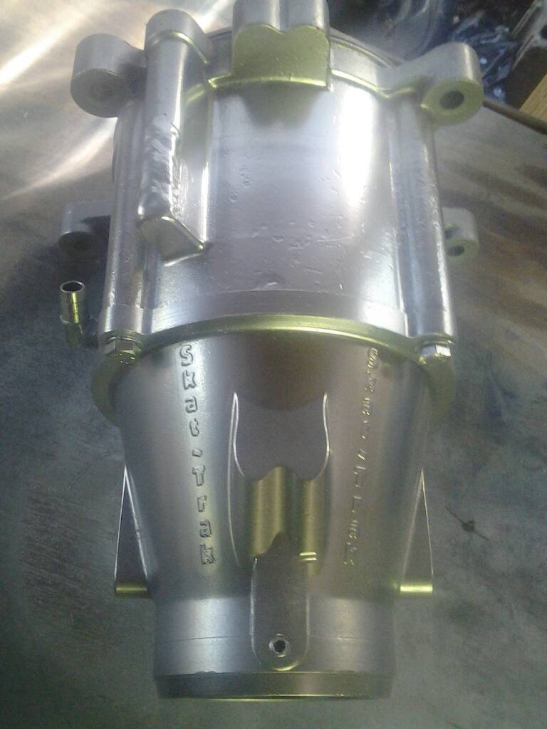

how did you get the pump cleaned up so well? cant wait to see this thing come together ! looks like it will be a rocket :thumbsup:
I cleaned it really good and painted it with this:
Anything you see with an aluminum look to it on this build has been painted with that. I was really skeptical at first when I bought it, but I really like the look of it.

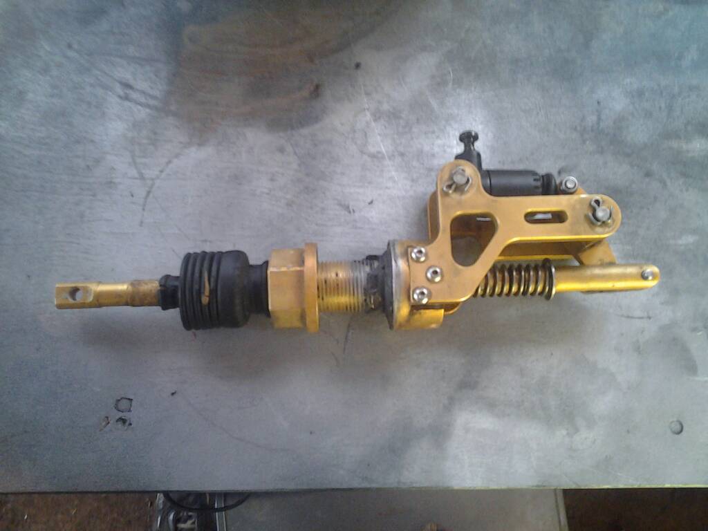

Also here's another goodie that's gonna be going on this beast:

I've actually hit a few snags on the motor build. The R cylinders are supposed to be . 125" taller than the stock cylinders, thus the need for stroking the crank. However when my set where decked the mechinest took way too much material off. Now they are only .004" taller than stock. I'll post more this weekend on how I'm solving the issues.
