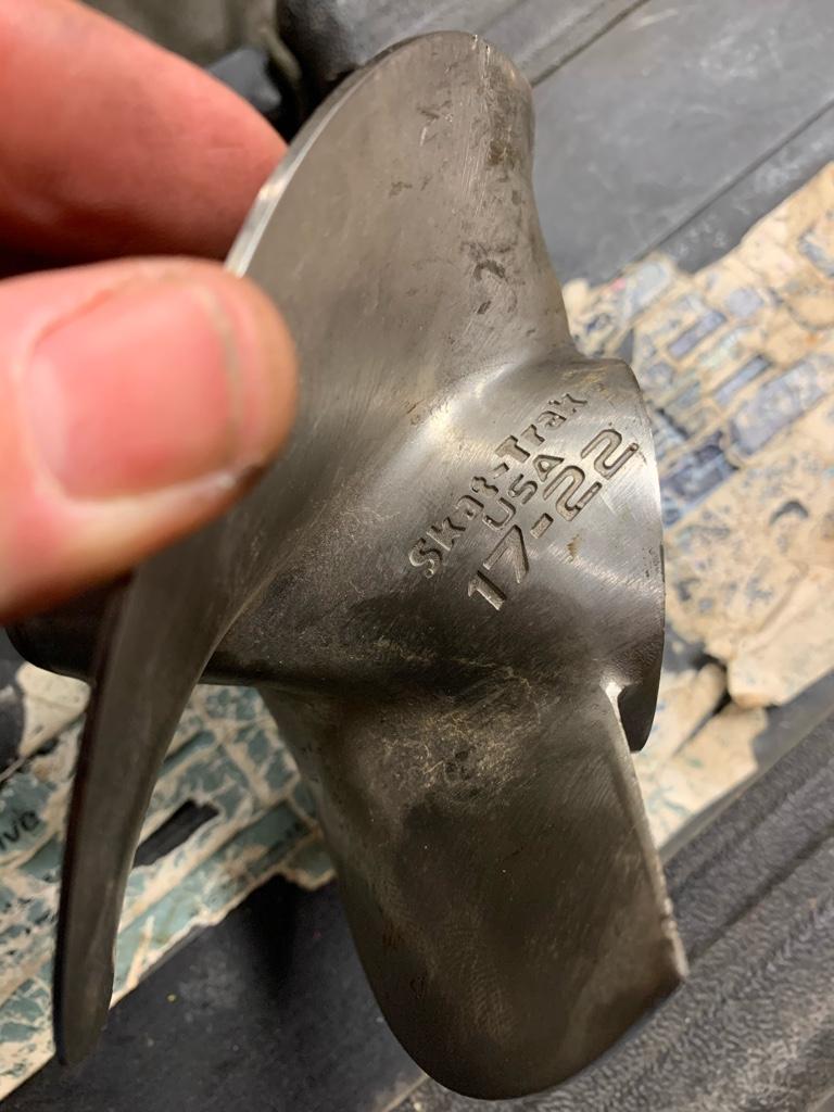

Tore into the jet pump. Has aftermarket impeller. It’s in good shape. Question is does impeller allow for more top end or provide more take off? It’s a Skat-Trak 17-22.

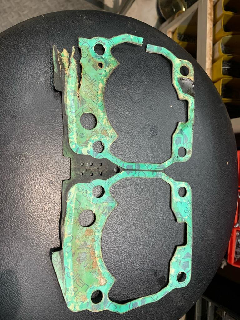

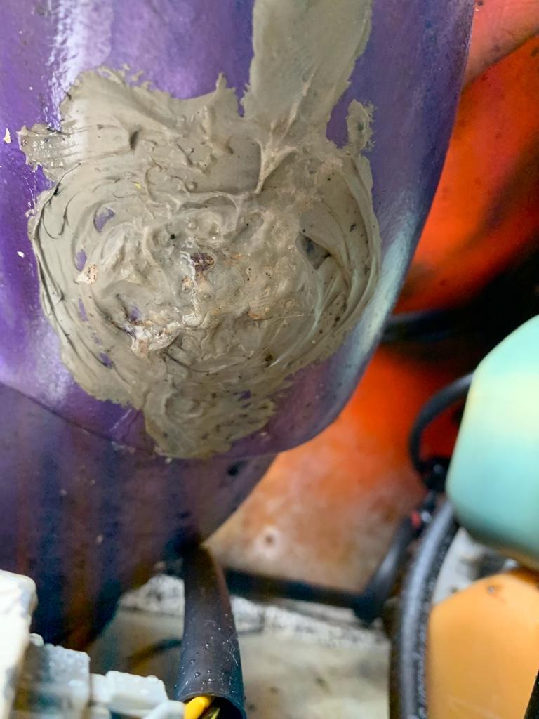

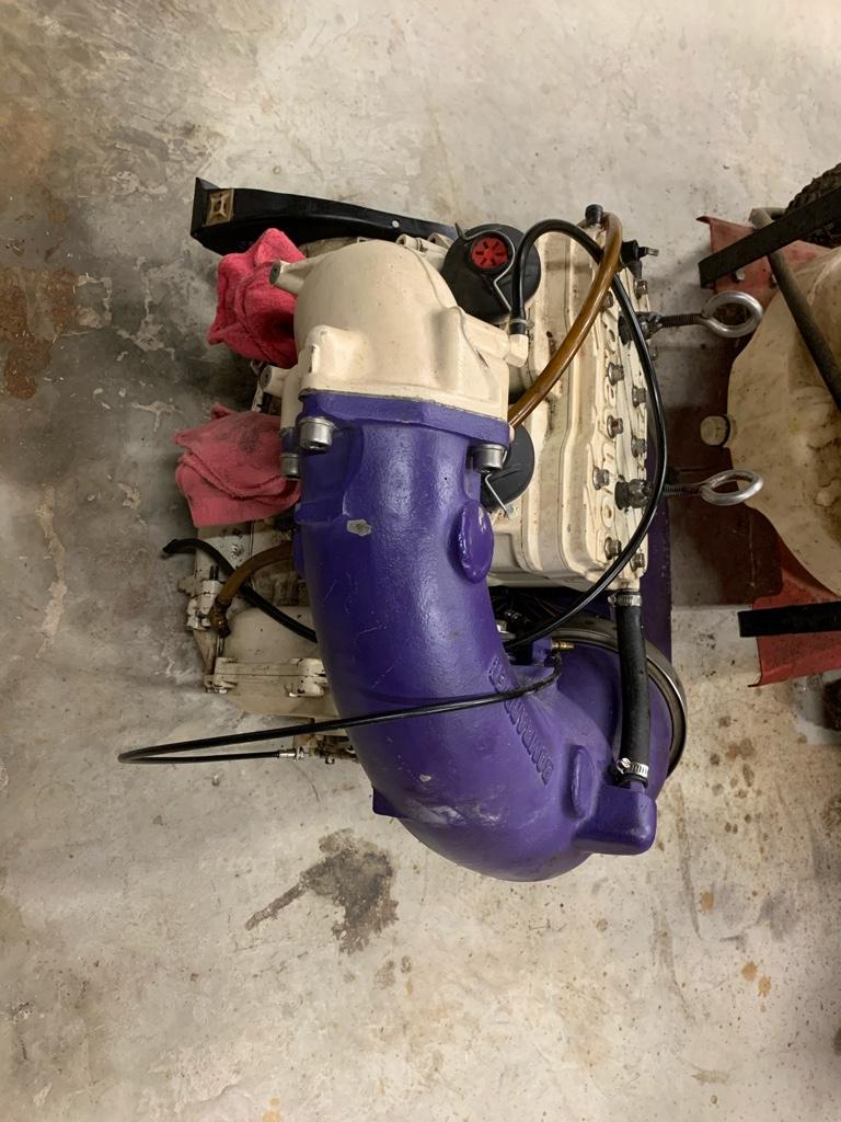

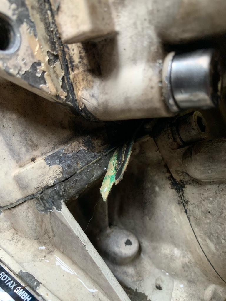

Got the jet pump rebuilt and everything bolted back up. Theoretically, it’s ready for a lake test. Well I hooked it up to the hose and I got issues. The big purple exhaust has a hole in the underside that the PO tried to seal with some kind of substance. I’ll scrape it off just to see what kind of hole he was dealing with. Either way I have a donor exhaust that is is pristine condition. The issue that is going to be the most time consuming is there is a leak at the base of one of my cylinders. Looks like a portion of the gasket has been torn away allowing it to leak externally. I was afraid that there could be a bigger issue with water leaking into my lower end. I pulled spark plugs, grounded wires, and turned engine over repeatedly. Luckily nothing but air pumping out. So looks like I’ll be ordering a base gasket and replacing the purple exhaust. I’d do a top end but compression was perfect.
I’ve never separated the exhaust. What is the secret to unhook the large band ring joining the two separate pieces of exhaust?
Just unscrew the nut and give it a few taps. Likely they Hi-Temp Copper RTV is holding it. I use a dead blow mallet.... gently. Remove the copper gasket and give it a good cleaning as well as the mating surfaces of the exhaust. Easy peasy for a man like you. :)

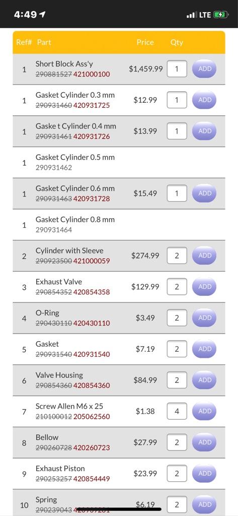

So I was looking to order a new cylinder base gasket, but there are a couple of different thickness. Which one should I order?
You will have to count the holes in the old gasket and order the same one. The base gasket is how the squish clearance is set and can be different on each engine so we can’t tell you which one to get.
The only other way is to measure your squish with solder as described in the factory service manual.

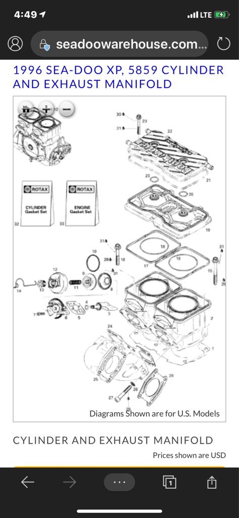

Thanks for the help. I found this pic which helped me understand which holes to count. Guess I’ll remove the cylinders so I’ll know which one to buy. Do you coat the gasket with Threebond 1211?
The gasket should go on dry.
Having said that in over 25 years of building ski engines, this last summer I had a superjet that would not pass the pressure test so I had to use 1211. If there’s corrosion in the cases or cylinder gasket surfaces a very light coat of 1211 can’t hurt anything.
Looks like I need a 0.6 mm. The 6 holes are in a different spot that the manuals diagram, but I think it’s what I’m gonna order. I’ll try to research the brand and part number in the current gasket.
