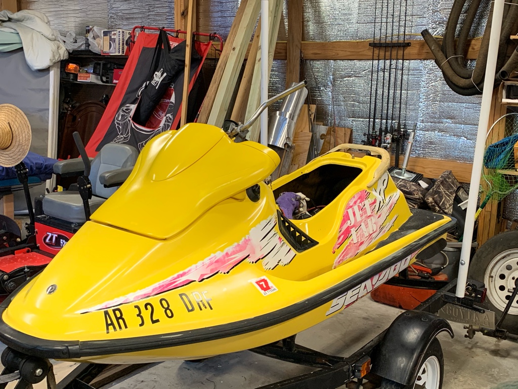

RESTO Picked up my winter project 1996 XP

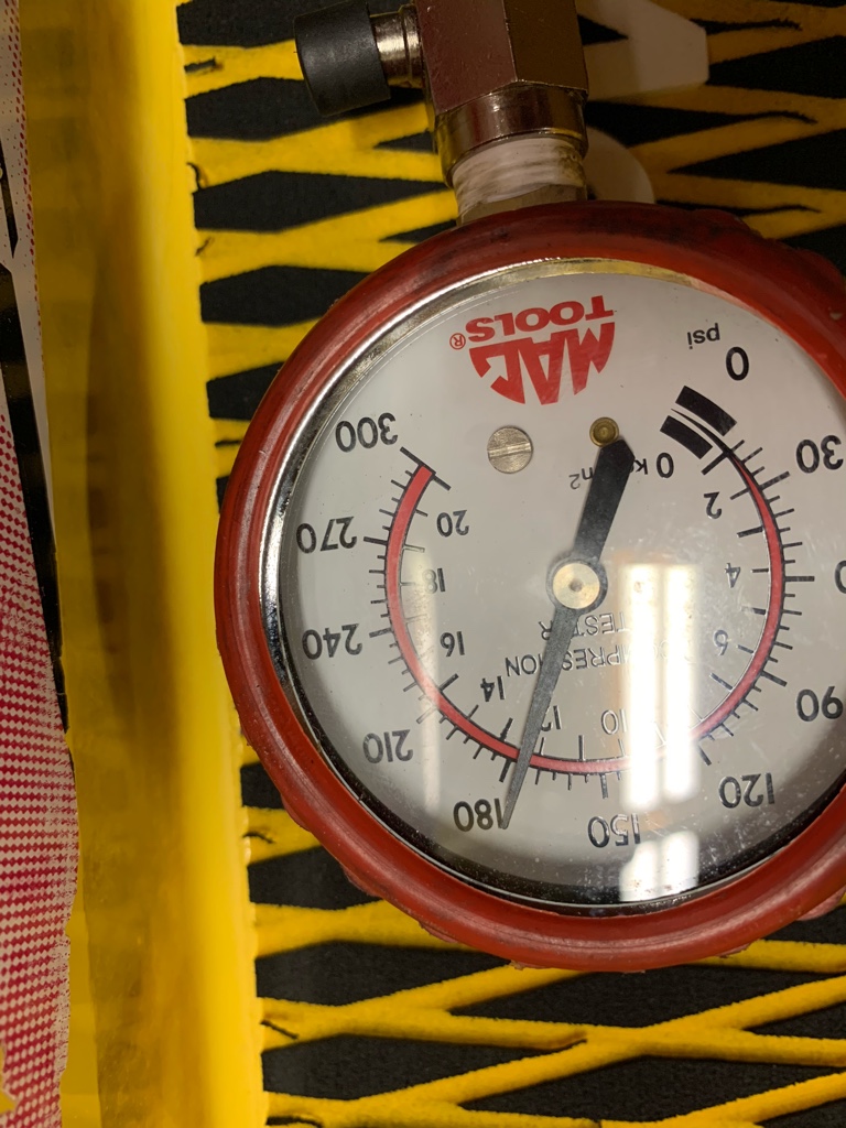

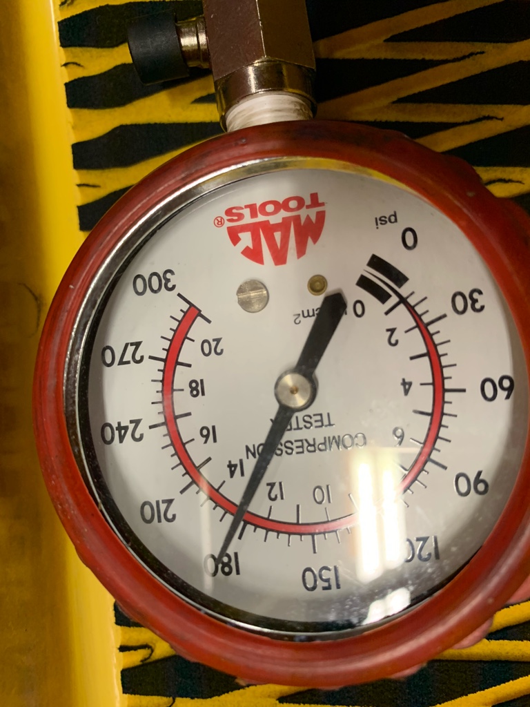

Checked compression on my winter project. I remember my 1996 GSX having 150 psi. This 1996 has some mods and aftermarket parts. Is this too high?

You might have a little oil in the cylinders raising the compression a bit. I wouldn't be concerned with the reading as the engine was obviously running at some point. :) I had 170 on a GTX I built and it was stock.

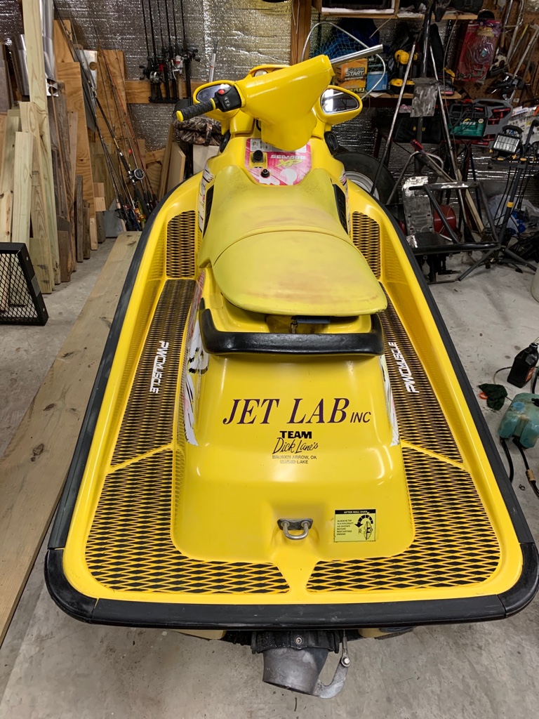

Thanks for the response. The hood was really rough when I brought it home. Just followed the tips provided on here with the Clorox soft scrub, scotch brite pad, then McGuires rubbing compound. Wasn’t that hard and it turned out great.
You freakin suck dude !!!! :D :D I'm so slow. I've been having this ski for 6 months and just pulled the engine. LOL Lookin Great !!

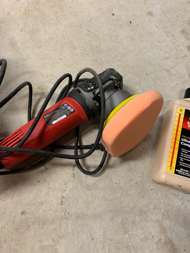

I did one ski with the soft scrub and blue scotch-brite but never heard of the rubbing compound over the top. Which grit did you use ?? This is the one I did.1996 XP Body Work (1).JPG
This is what I used. I bought everything at Harbor Freight. The peach colored foam pad to apply the McGuires. I then used another buffer with a cotton pad to polish it to a shine

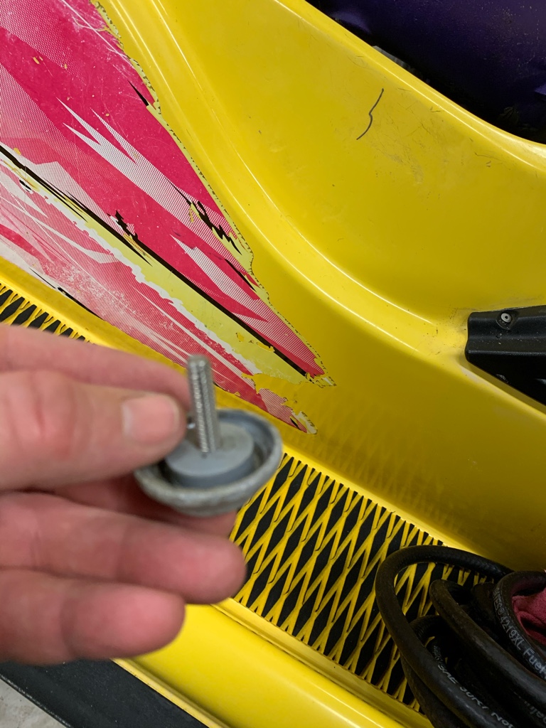

Quick question. I removed and installed a working info gauge tonight with the homemade pVC tool I saw on this site. Buttoning up the hood and I see this part lying on my bench. Do any of you know what this is and where it goes?
That is some bad azz compound and it ain't cheap either. I bought some a while back. I might give that a try on an old hood. Thanks for sharing.
