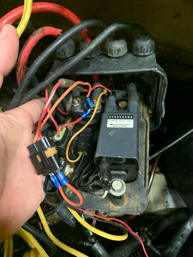

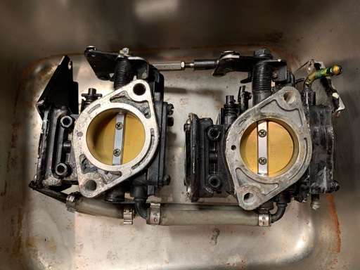

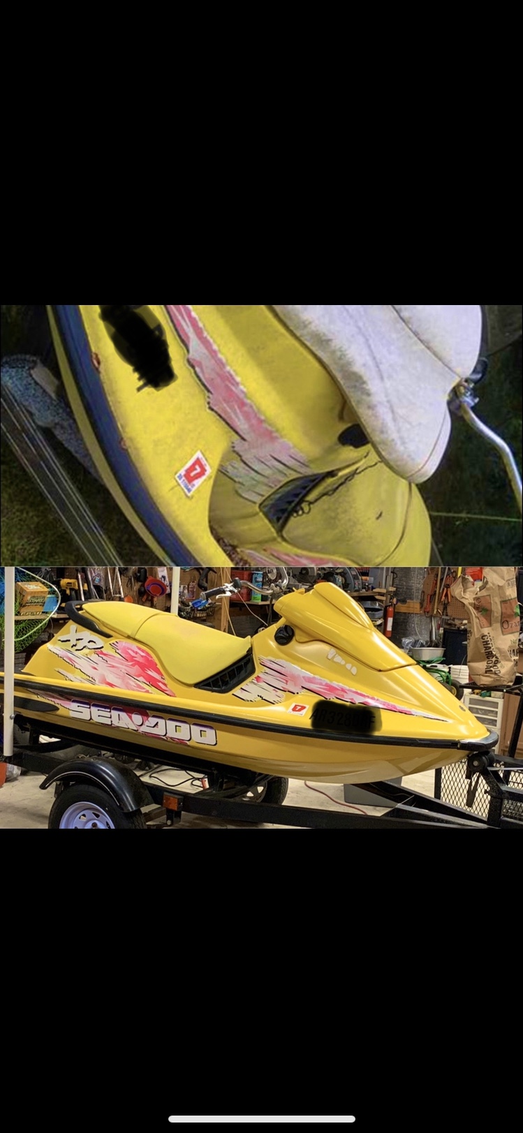

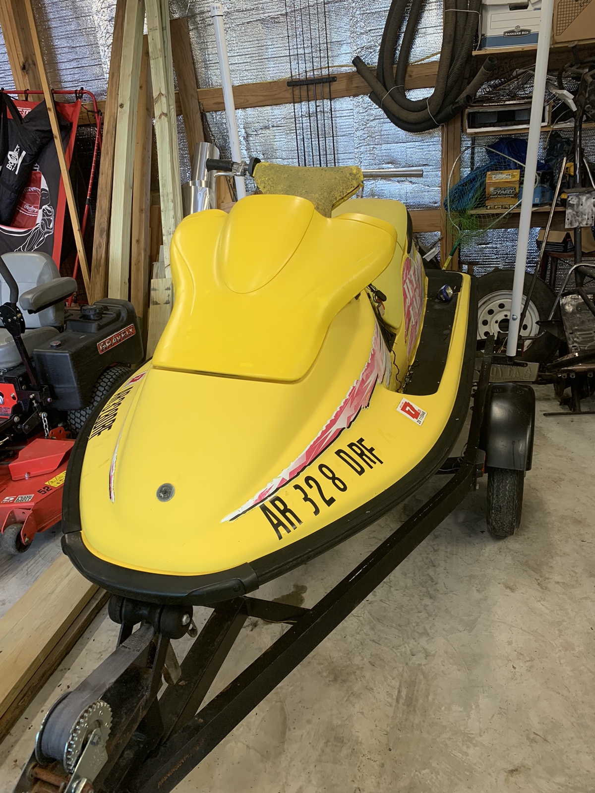

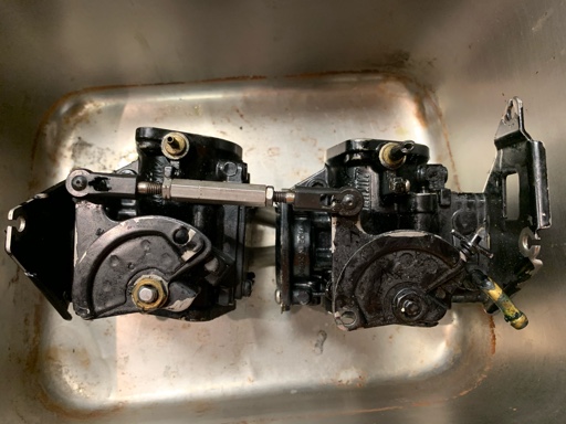

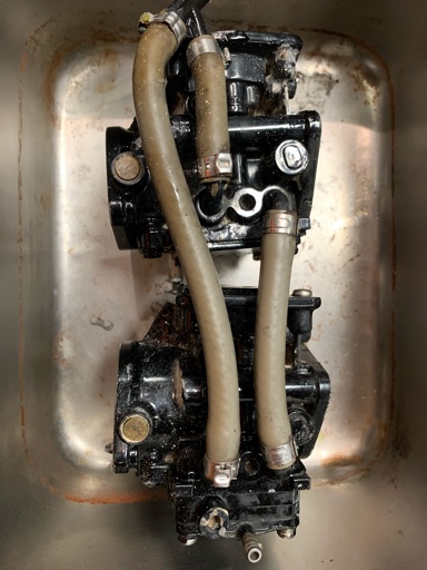

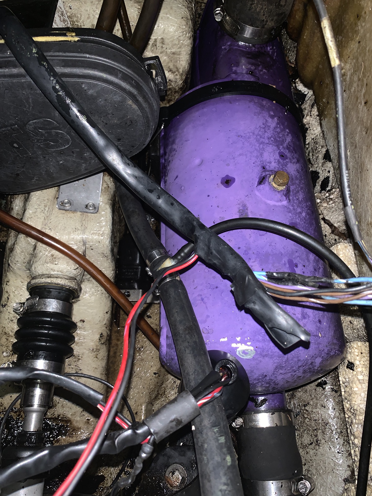

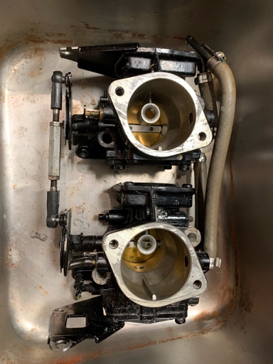

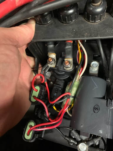

Picked this up yesterday for $100. Washed it and took some rubbing compound, followed by polish and then wax. Looks significantly better. It’s not running, appears to have an electrical problem of some sort. Scoped then cylinders and direct wired the starter and got 150 psi each cylinder. All of the electronics are disconnected and out of the ski. Have to reconnect everything. Impeller and wear ring all look good. Choke has been removed and a primer installed. It has a Pro Flow R&D Power Plenum air box and carbs appear to have possibly been sent to Jet Lab. The water regulator has been deleted as well as the oil pump. It still has all the gray fuel lines. Here’s a few pics. Will keep this thread updated.
