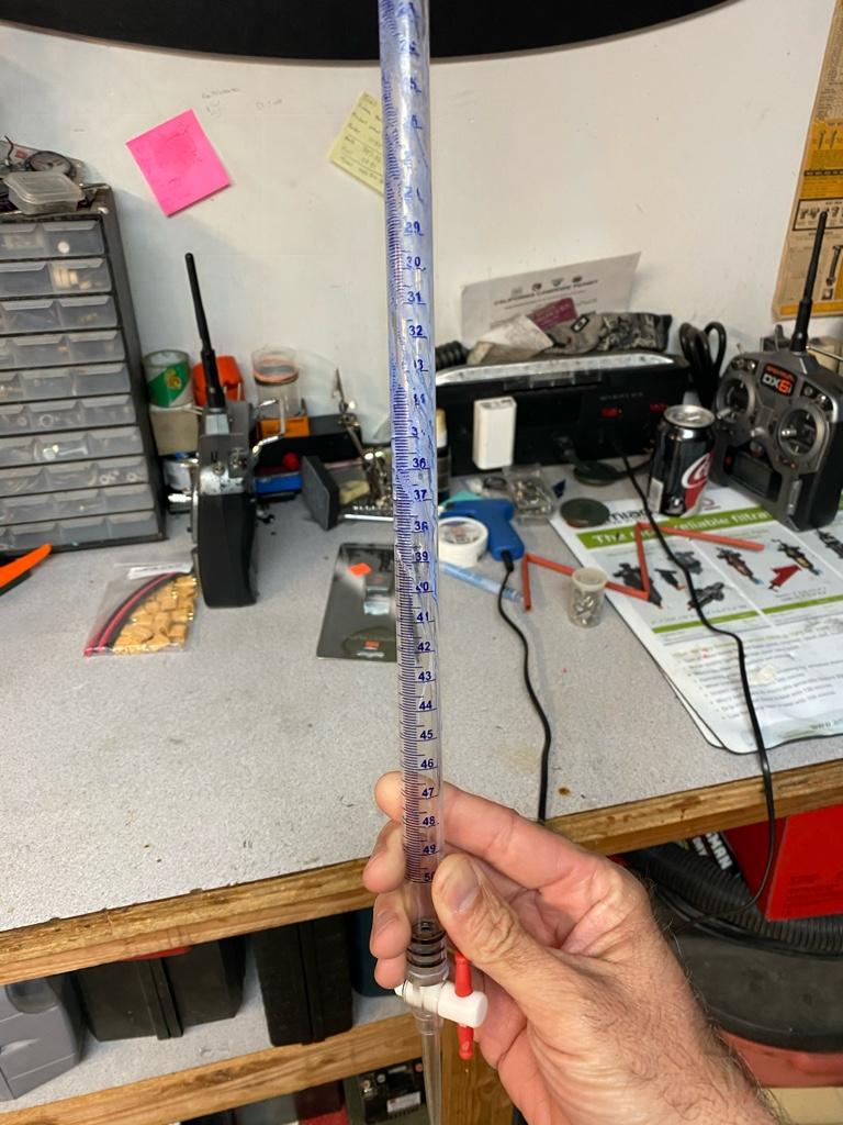

For the last 2 years+ I've yet to hear of anybody on this forum or the FB forum actually getting a TDC gauge and a burette to inject a liquid in the combustion chamber to measure the CC's. Is it really that necessary? Apparently not, since it's not widely known if people are having issues by not checking it.

I have seen a few folks check the cc. It's usually done with the head upside down and the spark plugs all the way in.

This is easy to do with solder but for some reason they switched to cc measurement once the 951 came out. It is much harder and almost impossible since once you fill the combustion chamber up it is already leaking past the ring grooves. Yes, ask me how I know that.
Also note to self, don’t get brake cleaner on the burette.

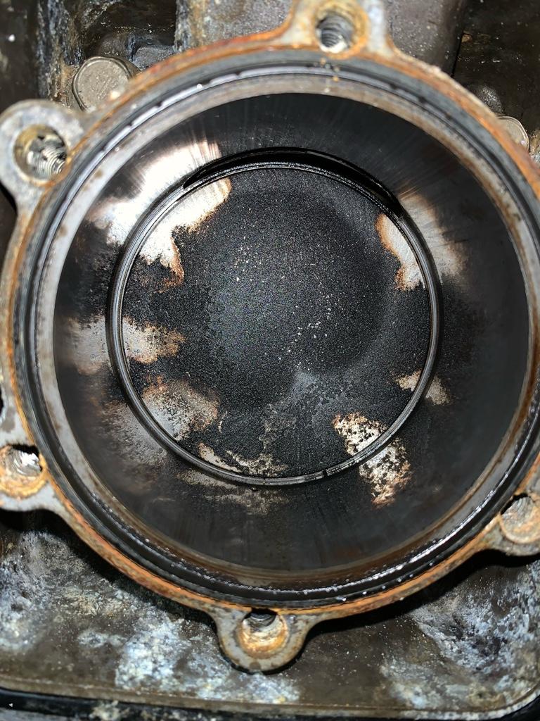

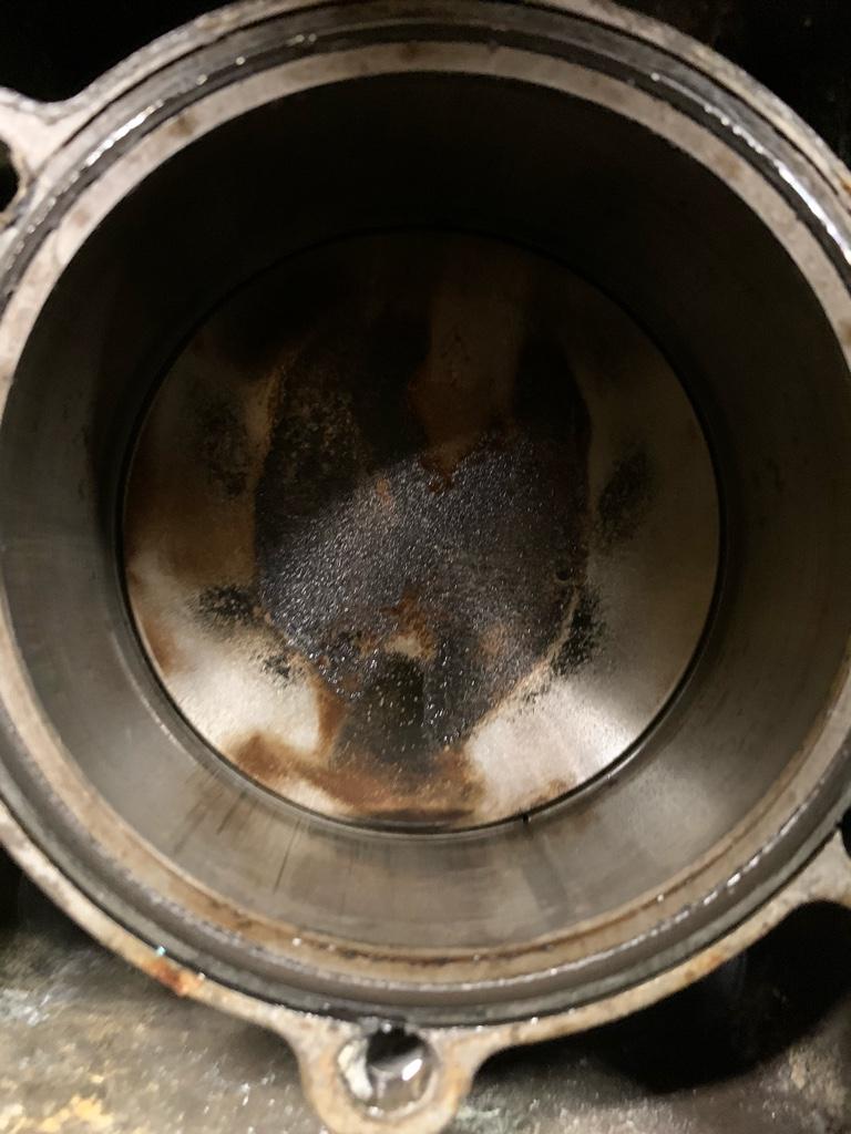

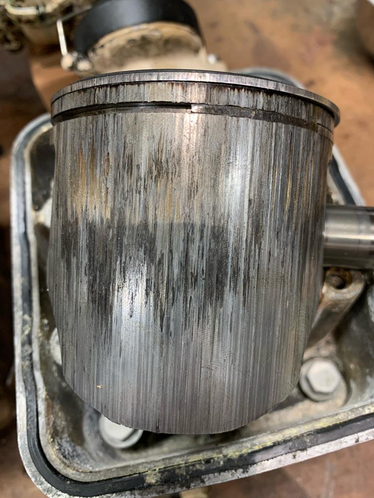

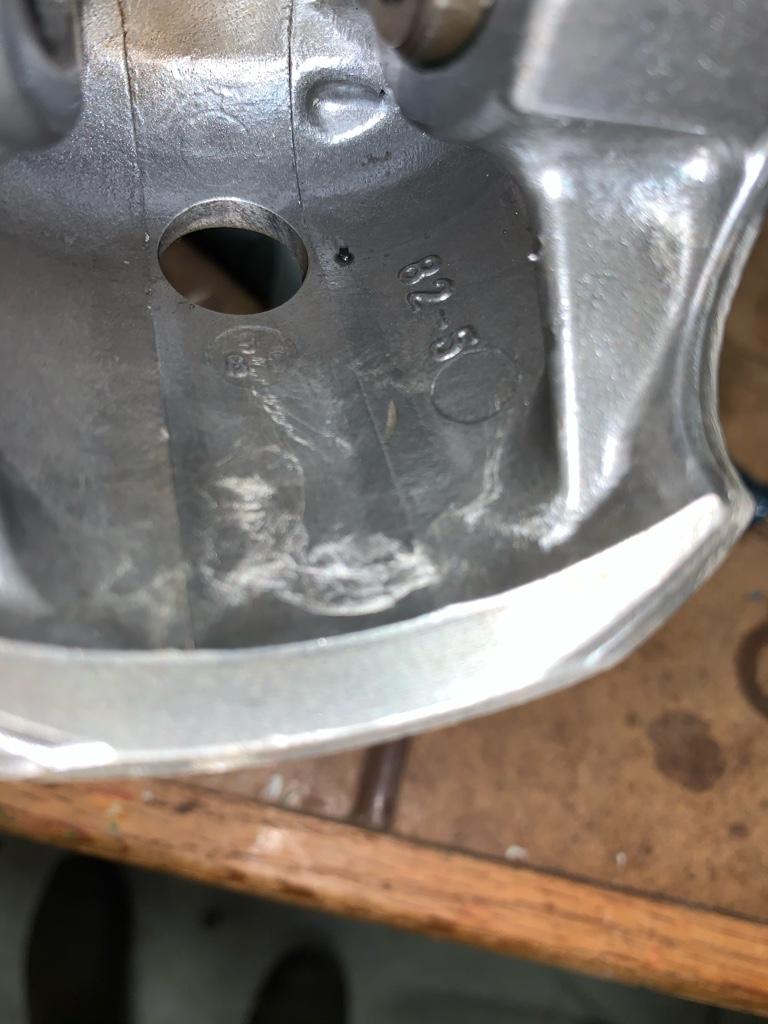

Pulled the cylinders and gonna have to do a top end. I have no idea how the compression was so good and even. Both pistons had some scoring and one of the bottom rings was snapped in half and locked into the groove. I’ll take some pics of the scoring. Here’s some wash pics of the pistons. I have rebuilt the carbs and found that one side of the cylinder drain at the tee was clogged with sand. It was a ticking time bomb if I’d run it.
The first piston is the one with the most scoring and the broken ring.
I tell ya, the compression test doesn't tell everything. We've discussed this previously. The engine can be in failure mode and you can still get good/decent compression readings. I don't mind doing the top ends, I don't like doing the whole engine. :) Ski is gonna be even cooler when you are done. :D

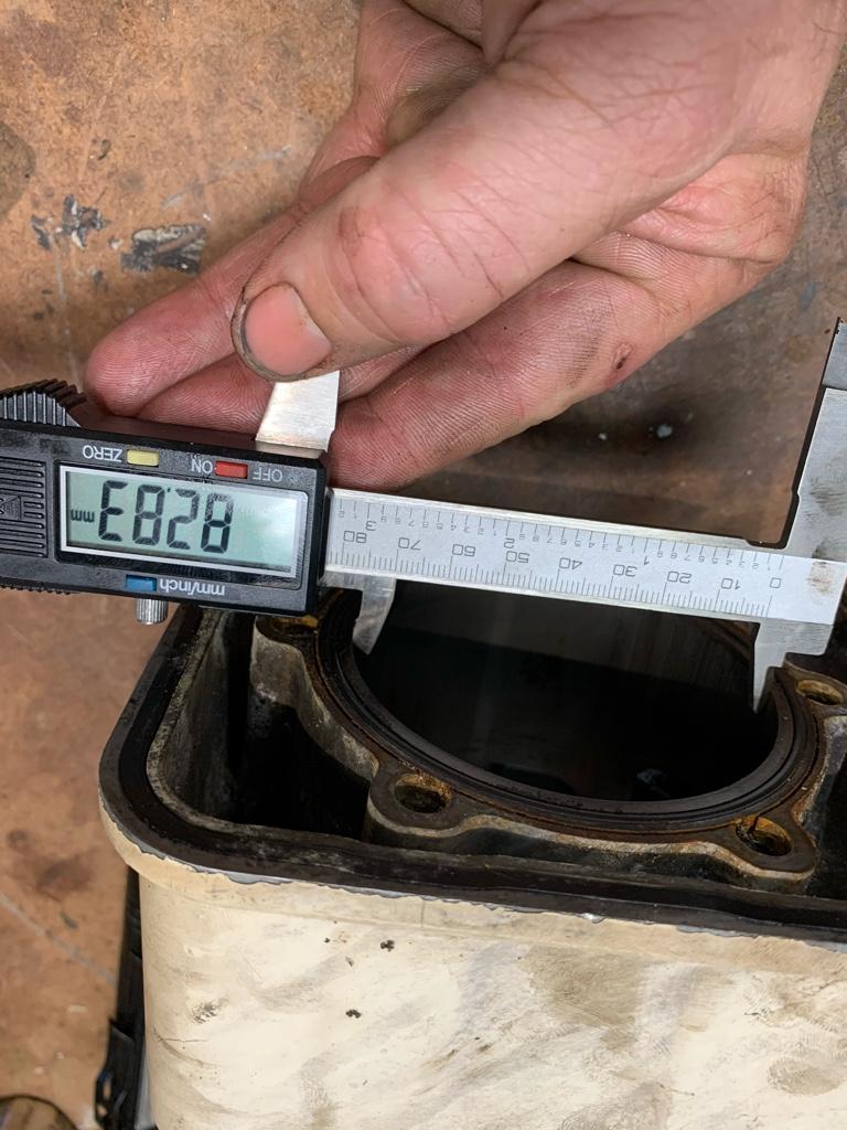

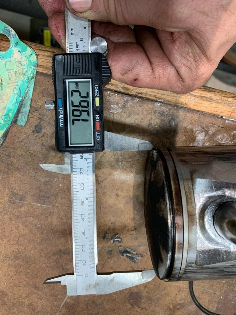

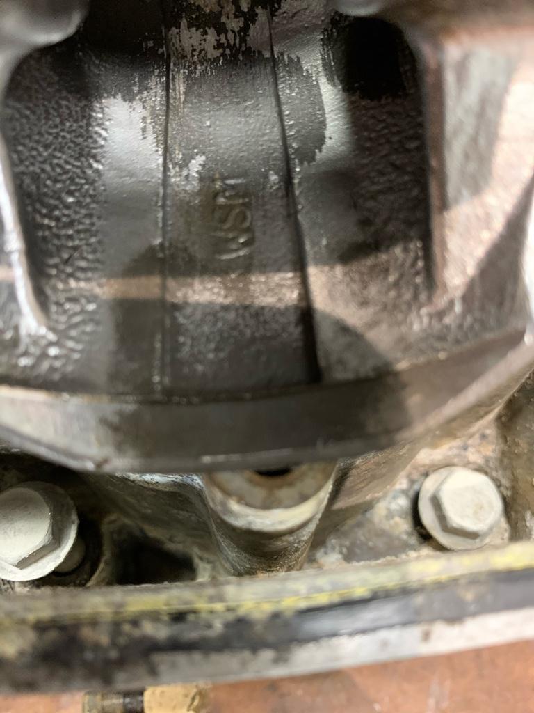

Here is the bad scored piston. I had ordered a gasket kit and orings. I have two donor engines that I thought I could just rob their cylinders, pistons and rings. Well they are OEM 82.5 marked on inside skirts of pistons. The pistons that are on my engine are WSM and no marking to determine size but they are larger and won’t fit into the donor cylinders. What size WSM Piston do I need to order to fit my current cylinders?
You really shouldn’t just slap pistons in a used cylinder.
You need to have a machine shop measure them with an actual bore gauge to see if they are within spec and aren’t out of round.
My original plan was to use the matches pistons to their matched original cylinders from the donor motors. They had no scoring or obvious issues. The aftermarket ones on my current motor are definitely larger and I thought I’d try to go back to that set up. No way I could mix or match any of the donor pistons/cylinders since too small. Yeah I’m kinda in a pickle at the moment.
I suggest Group K. They have been doing my cylinders for over 25 years now. They can supply pistons or once they measure the cylinders you can have pistons sent to them for a little less money and his turnaround is about a week.
Another good option is FullBoreonline but his turnaround time varies and can be quite long at times.
I don’t care for the quality of SBT or their parts.

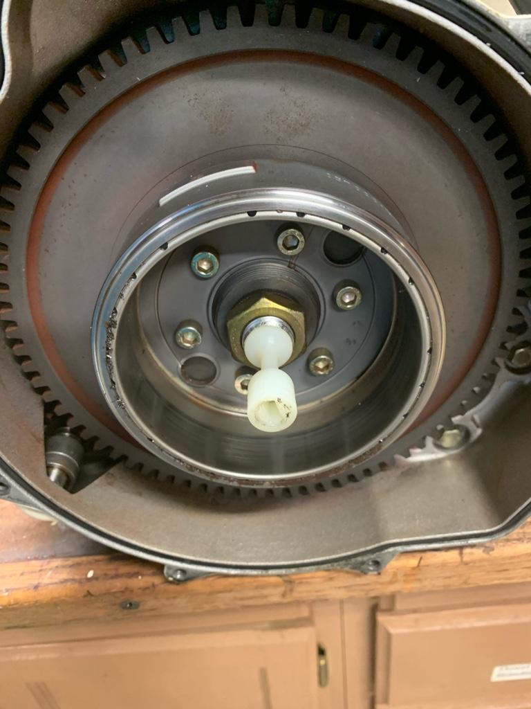

Instead of doing a top end and not 100% sure of cranks condition, I bought a motor from Westside Powersports. I’m changing it over to premix and from everything I’ve read and watched im supposed to remove a nylon gear from rear of oil pump. Mine only has a steam linking the flywheel and oil pump. I’m assuming I just remove the stem, the oil pump and place my block off kit?
There is no good reason to convert this to premix. The seadoo system is as reliable as it gets. The only thing you need to replace is the little 3/32" oil lines from the pump to the intake manifold.
