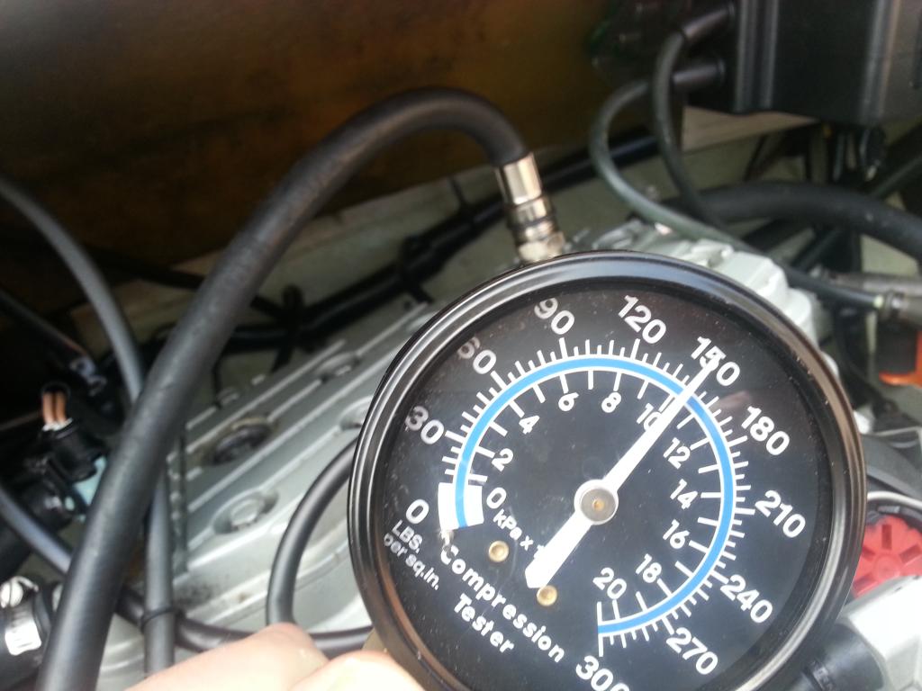

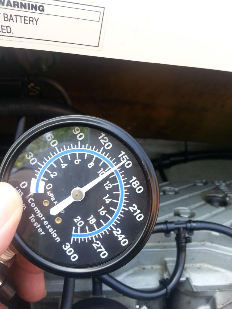

I fired up the gsx today and it was barely running with a low idle. So I did a compression check both right at 150. The front plug was fouled. I put new plugs in and the idle is now 1900. It was running fine so I checked the volts on the battery. It was at 12.4 when not running. At idle it dropped to 12.2. At 3000 rpms it dropped to 11.4. So I assume the rectifier or stator is bad.
