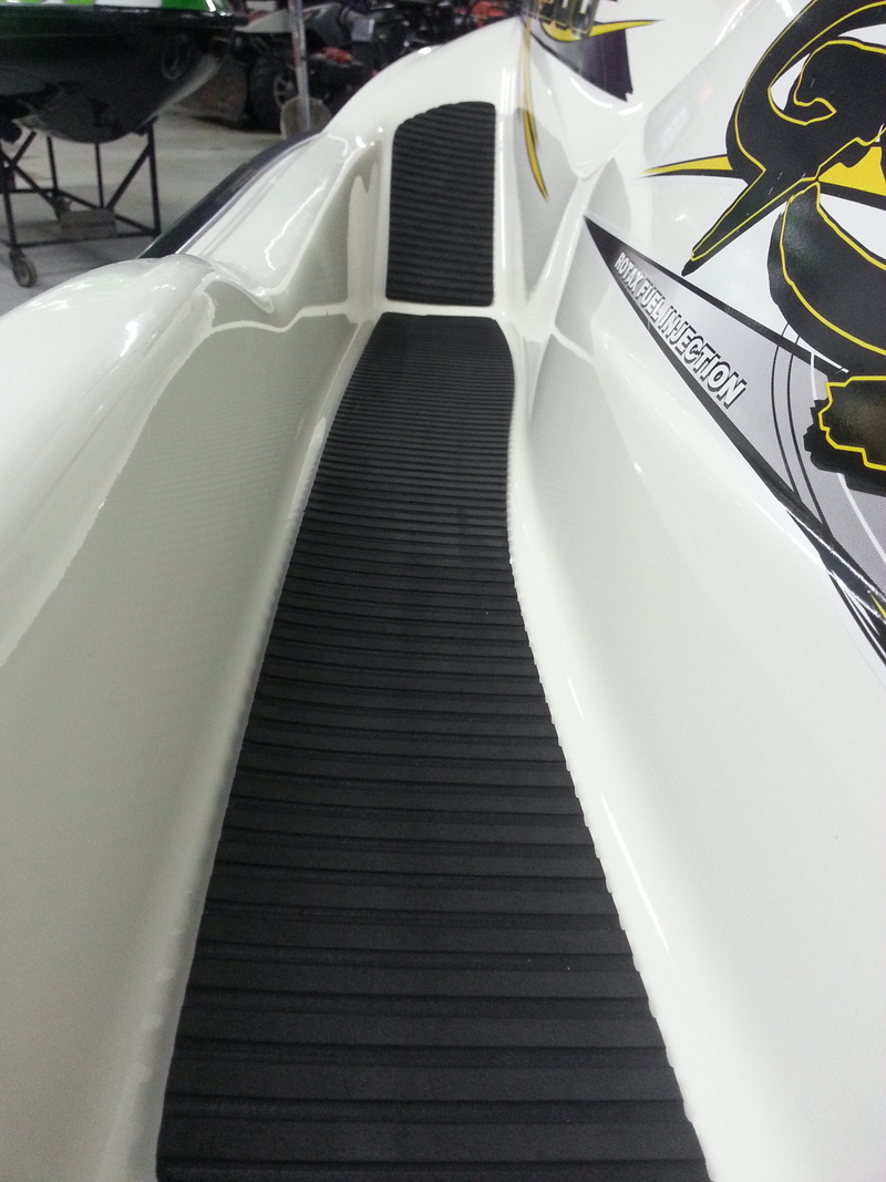

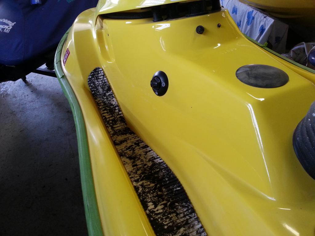

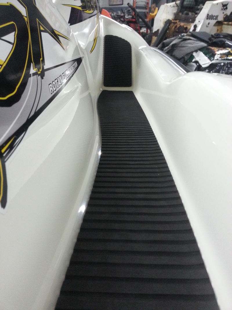

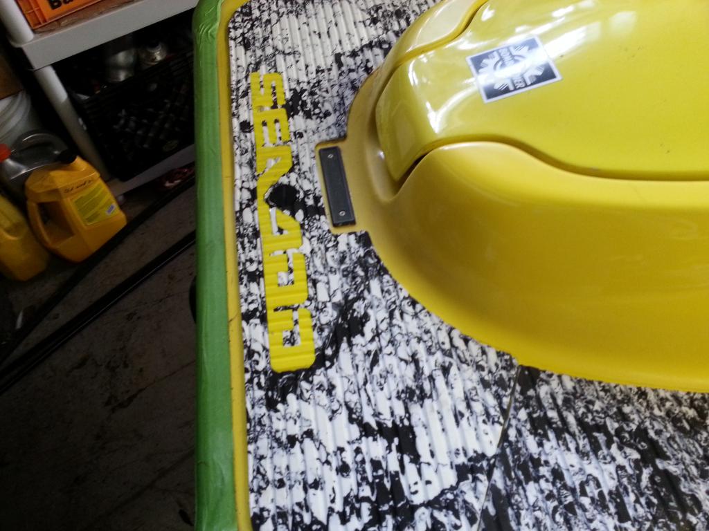

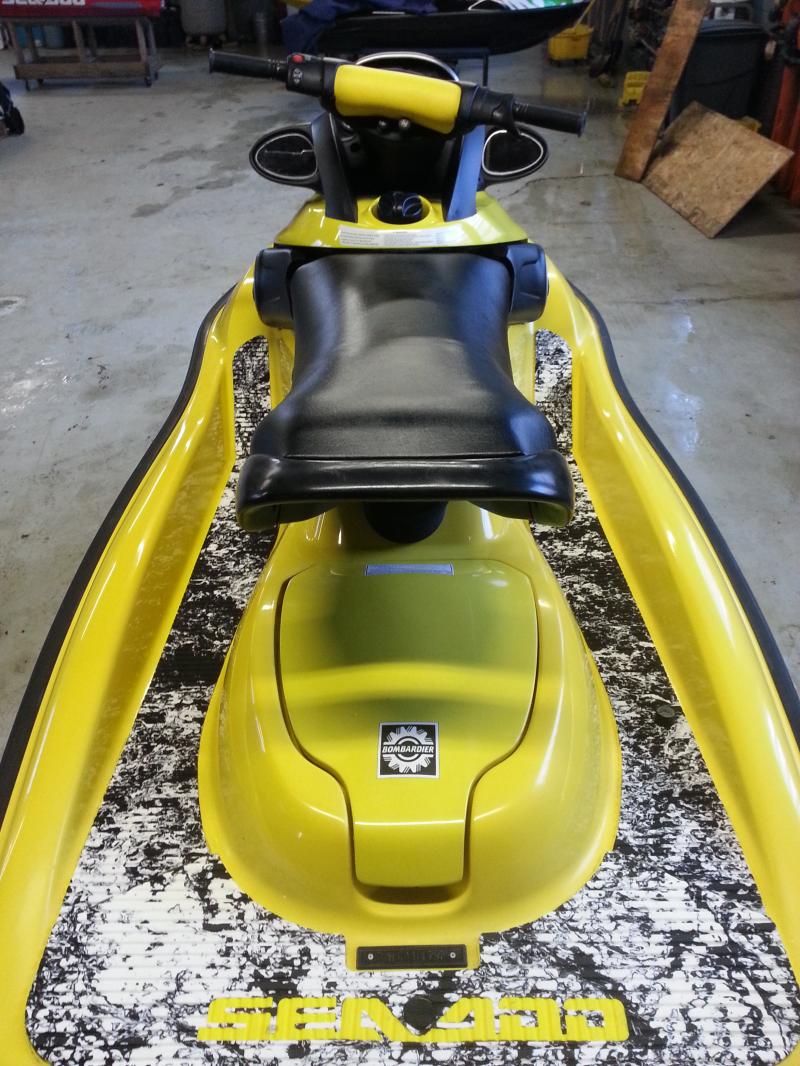

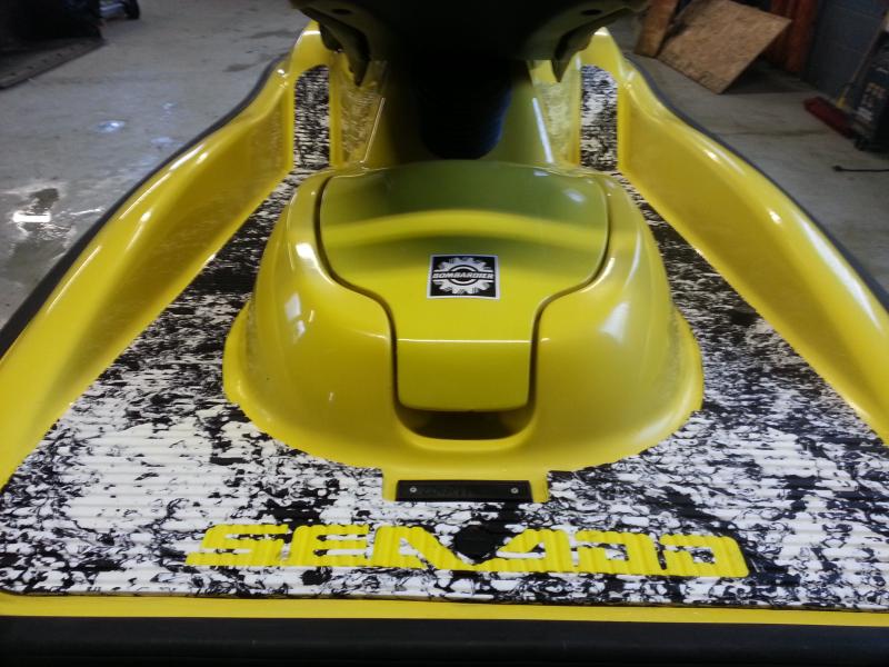

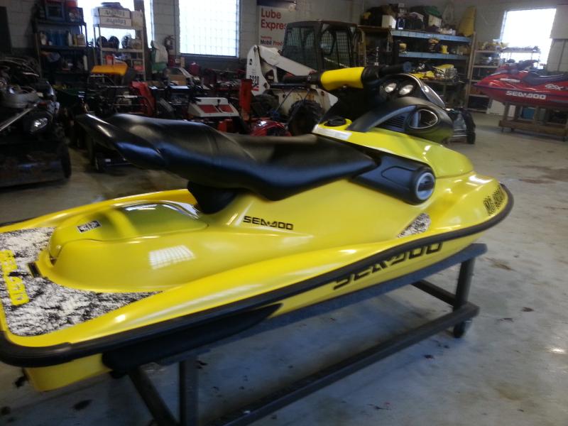

And a set of oem seadoo mats. These were actually an option for the 99 xp, when I was doing the 99 spx resto [MENTION=57920]racerxxx[/MENTION] found these on ebay. The auction title showed that they were for a 99 spx, I bought them and when they got here I knew they were for a different hull style. The paper work that came with them listed 4 different models, so I assume they printed one paper for all the models they were making them for and the seller just went with the first model. Anyway it was also missing the yellow circle so we cut a circle out of black and put it on.
These also did not have the psa on them. We only buy them with psa but this was an impulse buy. Any way we used weldwood per recommendation of [MENTION=41828]Minnetonka4me[/MENTION]. It was simple. We laid the mats where they were going to go and I traced them with a pencil onto the hull. I then brushed the glue on the mats and then inside my pencil stenciled area of the hull. I let the glue tack up and then applied them. One thing i would do differently now is brush the glue on the hull first and then the mats. The mats seemed to tack up alot sooner then the hull did.

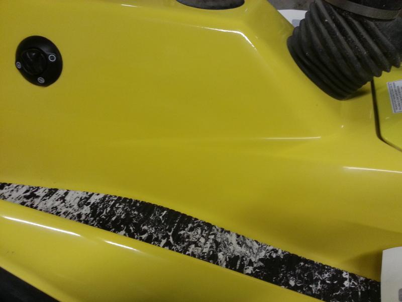

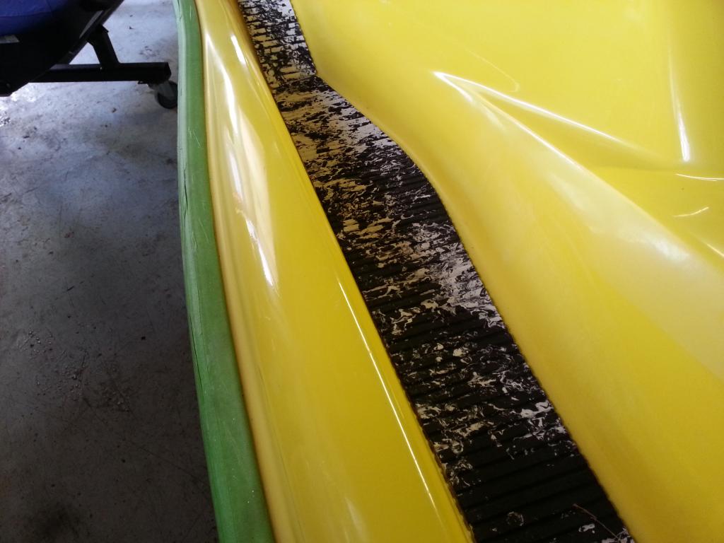

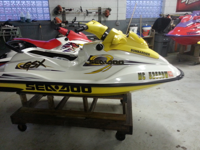

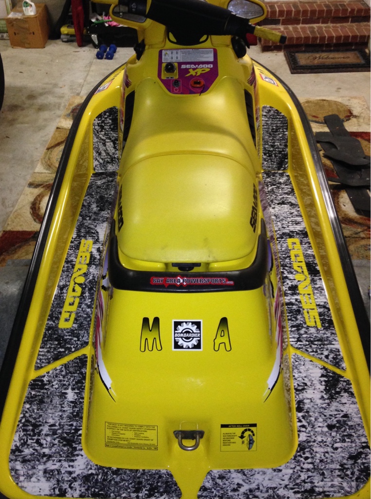

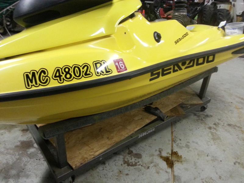

Today we played with our plotter and cut some reg numbers for this 97xp
Old and busted
New and improved
Not bad for our first set.
We still need to play with the software a bit to see what we can really do

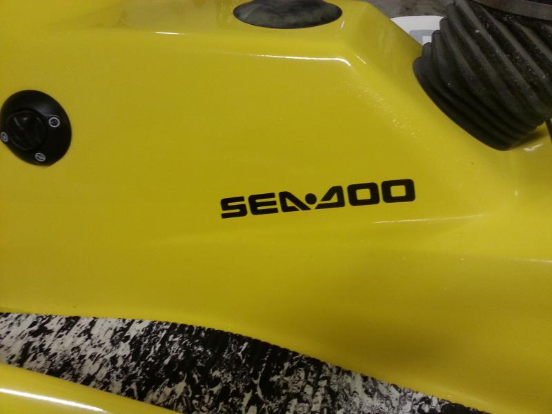

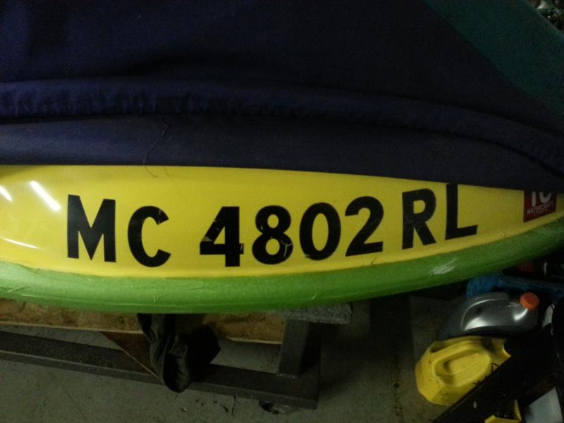

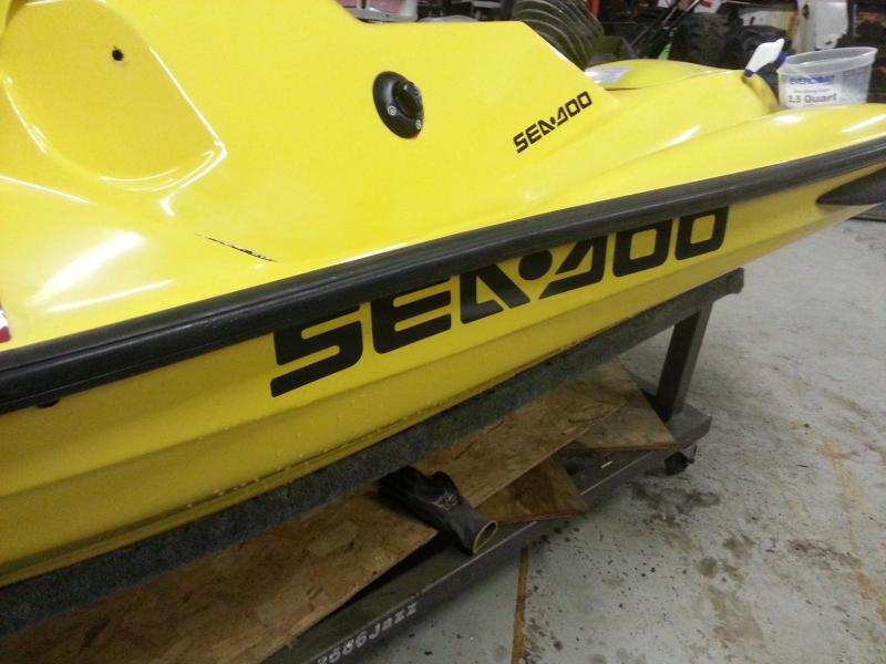

Old and busted
New and improved

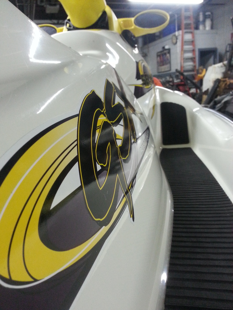

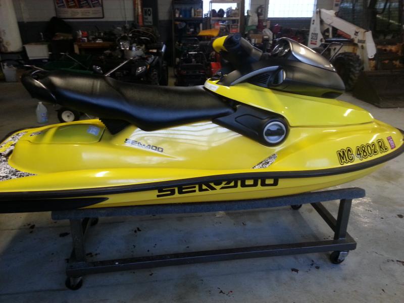

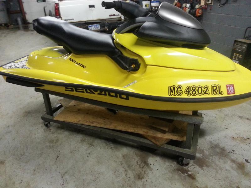

Did a little more to that 97xp. We have been neglecting our projects but all this had left was some cosmetic work and new needles and seats. The needles and seats are ordered and the cosmetic work, well
Finished buffing.
Put some decals we cut tonight on.

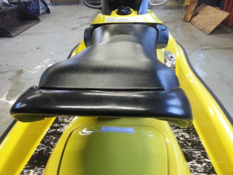

Warmed up some vinyl for the seat.
Seat wrapped, and just placed on to see how it looks. We still need to install the grab bar, under pan, and the rest of the seat trim parts. Actually used a harbor freight screw driver to hold it on.

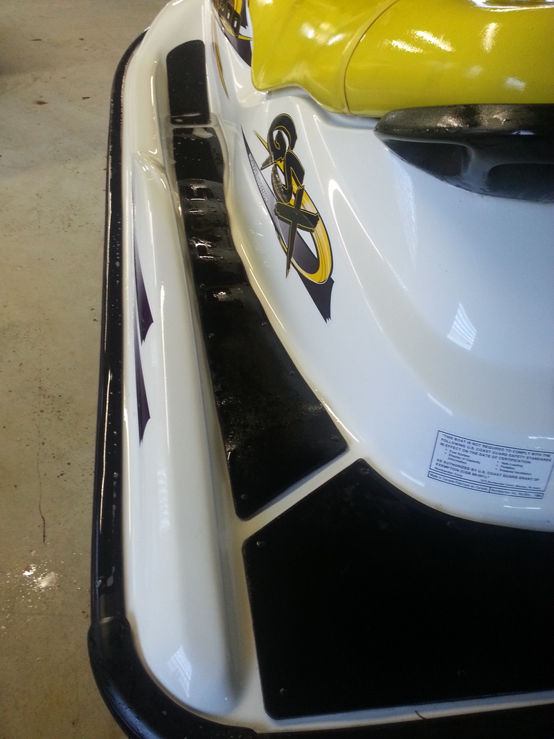

Thanks but it Looks better today! I do not think we will stencil this one. It might just be too much unless i do a brp logo
That was made for the 99 models. I have the paperwork it came with and it listed all the models. I originally bought this for oem parts for the 99 spx resto but the guy listed it wrong on ebay.he had it listed as the spx, not xp mats.

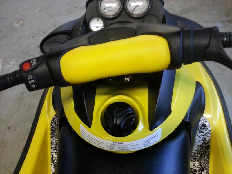

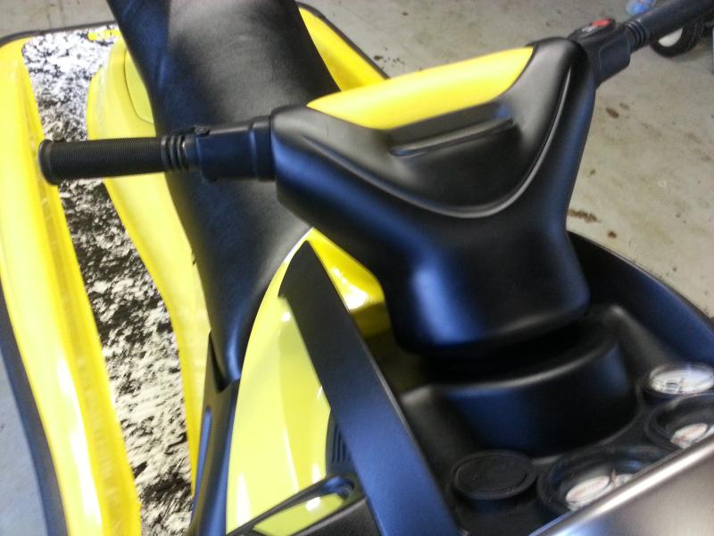

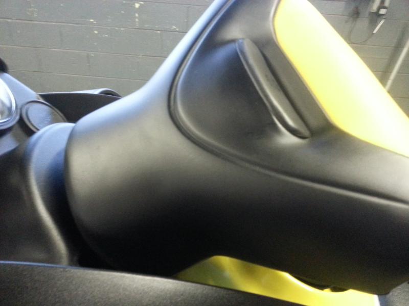

Looks great JSG! I assume the handlebar cover and seat pivot covers got the Wipe New treatment?

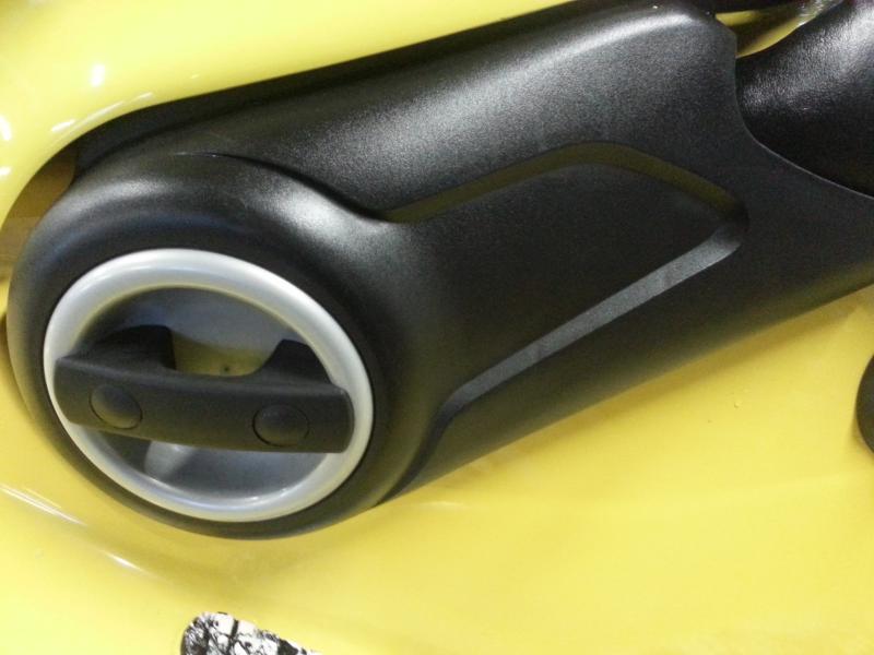

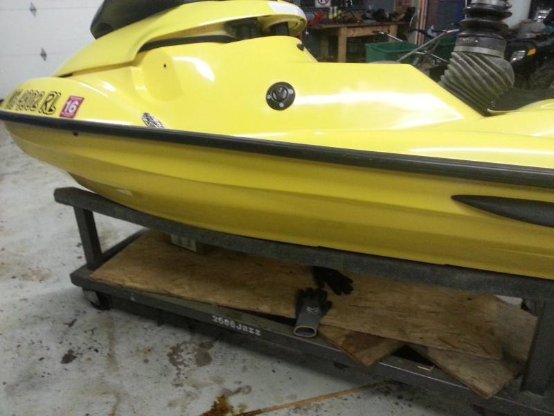

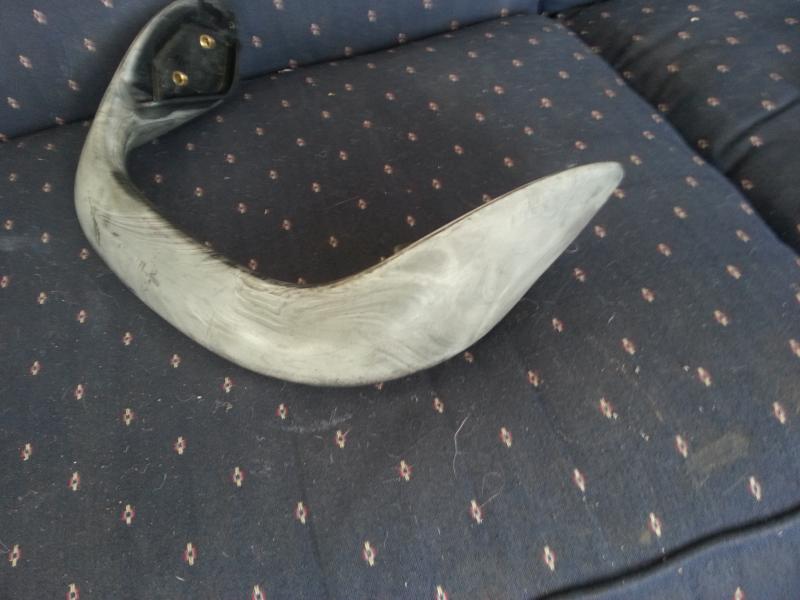

Sure did. The rear grab bar got the heat gun though. The wipe new did nothing for it. The trim pieces on this were all in good shape already but wipe new made it shine up. The rub rails were wiped with acetone. I tried rustoleum brand first and they turned a greyish color. Went back over them with kleen strip and they were glossy black again.
The grab bar looked like this
Now

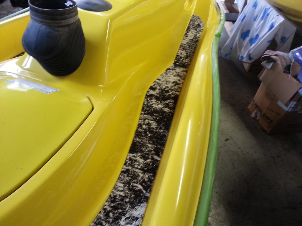

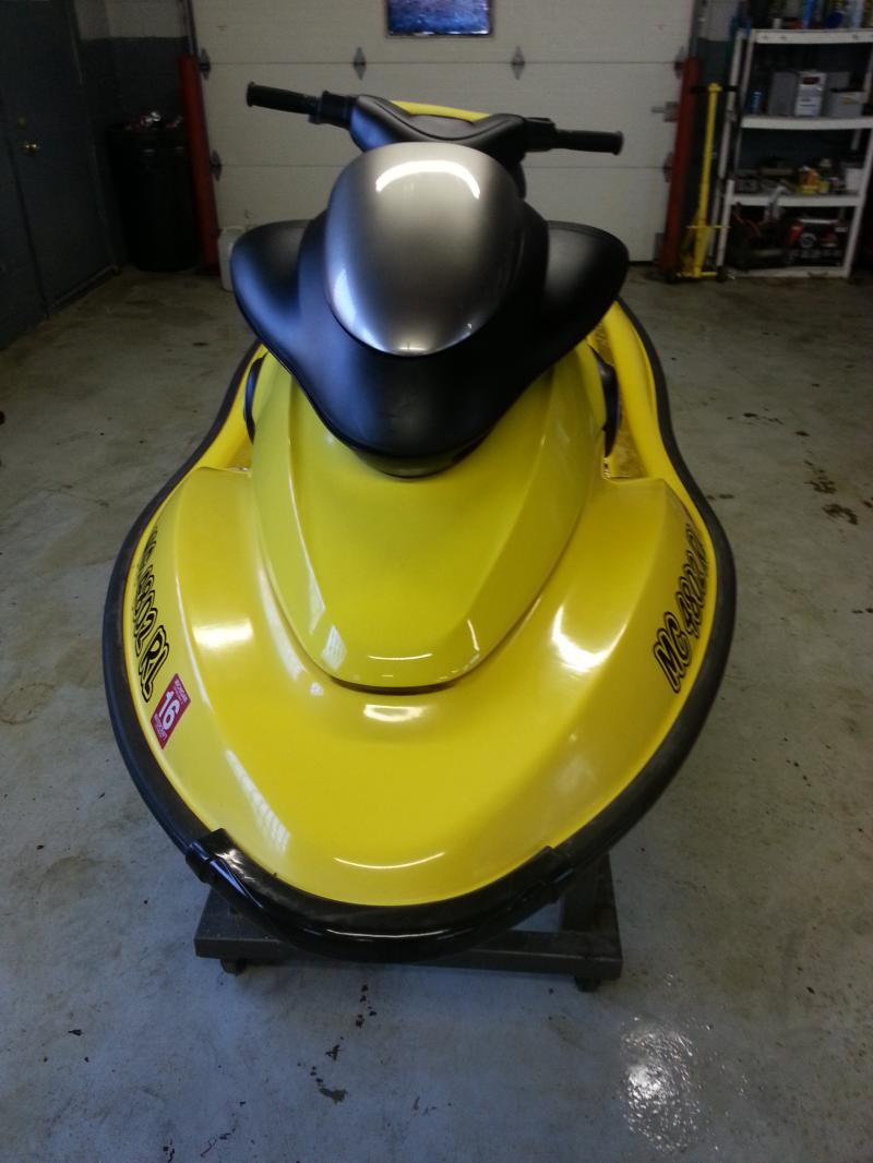

I changed the plugs and put in a new battery and it ran great during the test ride but then the low battery came on, I rode it like that for a long time and it never died. I only got around 6500 rpms but it was quite choppy out. Now it got Rectifier and she was good to go. We are putting new mats on it next week and it is going up for sale.
