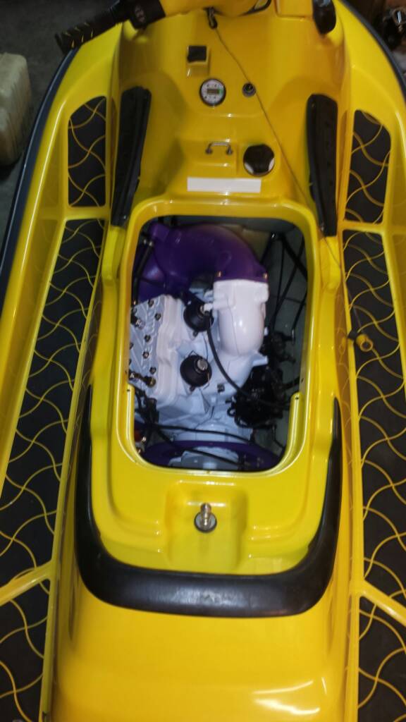

So I've had the ski out a few times, burned two-ish tanks through it. Strange issue popped up that I'm working through, though, is after going for a minute or so it will give a slight bog, then it wants to start popping and bogging and running really cruddy. It will progressively get worse over the next few minutes, eventually only going to idle speed before finally dying and not able to start. let her sit for an hour, and it'll start back up like it's ready to rock.. but there is no rocking.
I've tried without the rectifier hooked up, changed out the gas, ran with the fuel cap off, changed the MPEM, and changed out the stator with no difference in its performance. The only thing left to change is the coil (which I would have done had I not forgotten to grab a spare on our last outing) or the entire wiring harness. Somewhat frustrating, but such is life.. i'll get it whipped.
Now, a few pics, because words are stupid without pics.
It's those redneck racing rave adjusters you have on there. OK just kidding, I like your coil idea. A bad coil will often start acting up as it warms up.
I hope to get time to get it all sorted this weekend, just in time for one last ride at Jess's place before putting all the toys away for the year and start the off season rebuilds. First on the list is to get this seat to jettrim.. should have done that 6 months ago.
