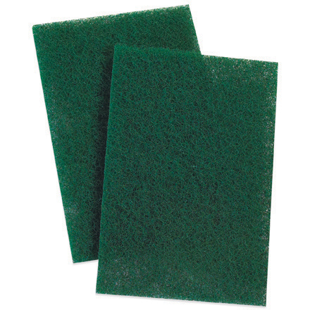

i use brake cleaner and a scrubbie pad, works wonders.
just spray some on the glue, let it sit about 3 seconds, then scrub scrub scrub it will gel up into little balls... wipe up the balls with paper towel, then repeat, about 95 times. whole process should take about 35-45 minutes 1 can of brake clean, 2 scrubbie pads, and 3 beers,

one thing that I failed to mention is that I generally use a plastic scraper or metal is fine too, your working on an area that will be covered up again anyway so scratches won't hurt anything... anyway... try and get 90% of the built up glue off first, then use brake cleaner & scrubby pads... so in my experience, brake clean, or any adhesive remover will be mostly useless until you get it down to the last remnants of the stubborn stuff, then it is very effective.
