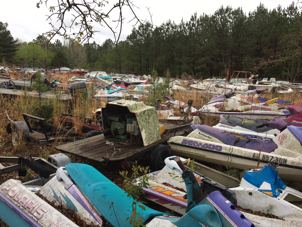

I've always thought the 2000 and 2001 white and blue GTXs looked awesome ( I restored my 97 GTX to look like one), so I made a trip down to my favorite salvage yard (that has now been closed and property cleaned up) to grab a hood and other random goodies. It was sketchy to say the least.
And yeah, they had stuff. LOTS of it.

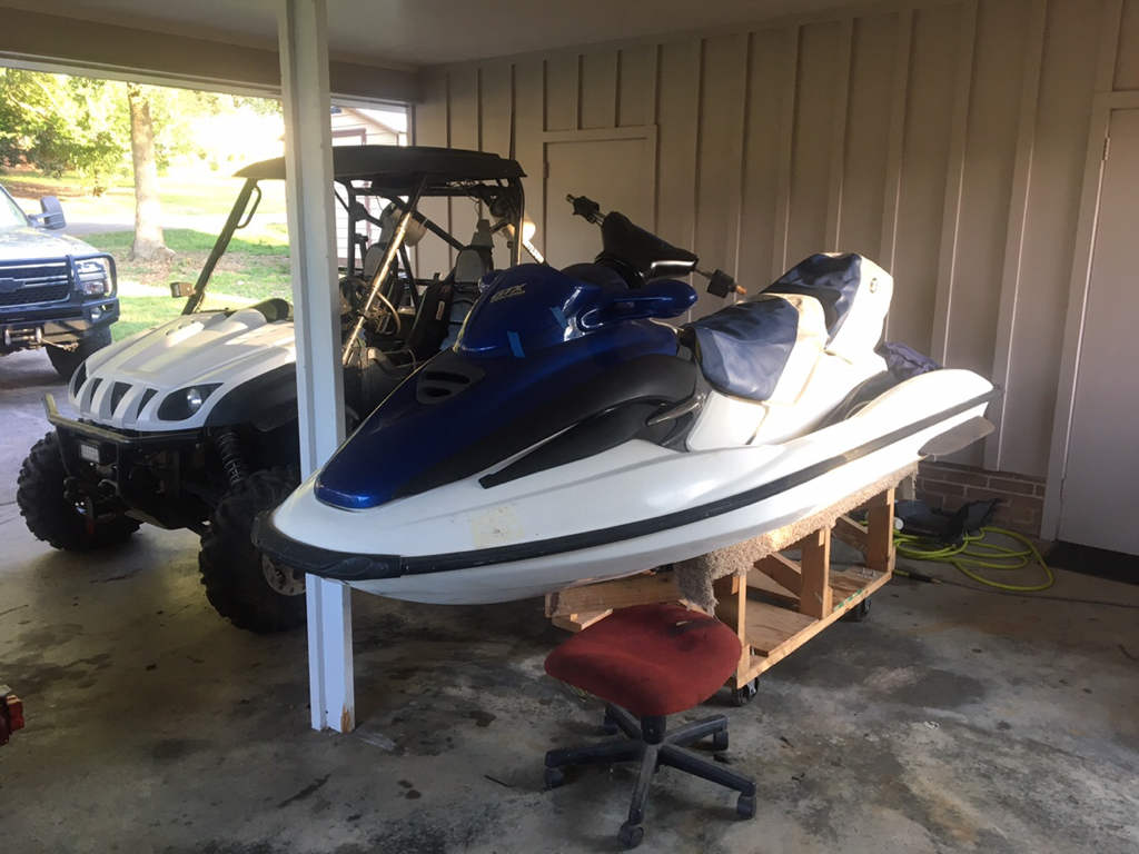

New GTX hood installed.

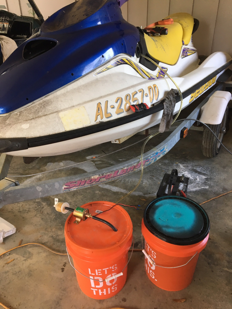

Here is a closeup of 'before'. The hand painted letters took some time to get off. The buckets are the rig I use to drain gas out of Seadoos. It's nothing more than a bucket with an inline fuel filter and a cheap fuel pump. Works like a charm.

And the finished product. I had a local company custom cut the registration letters for me.
Since the color on this ski is limited to the hood and seat, you really can make this ski your own. The 717 has plenty of power to be fun and will last long time.
