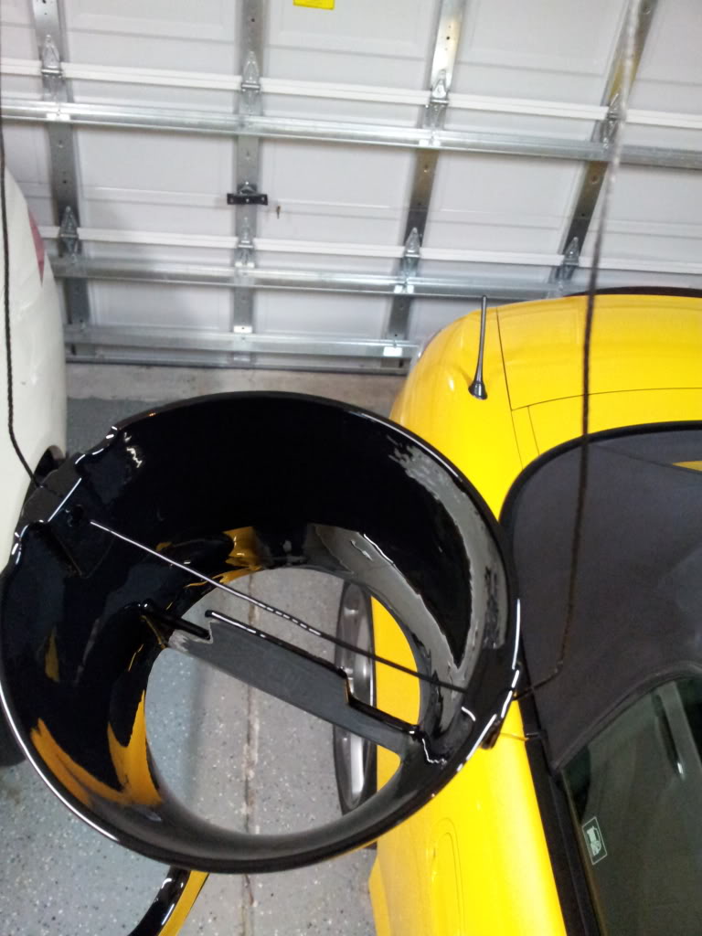

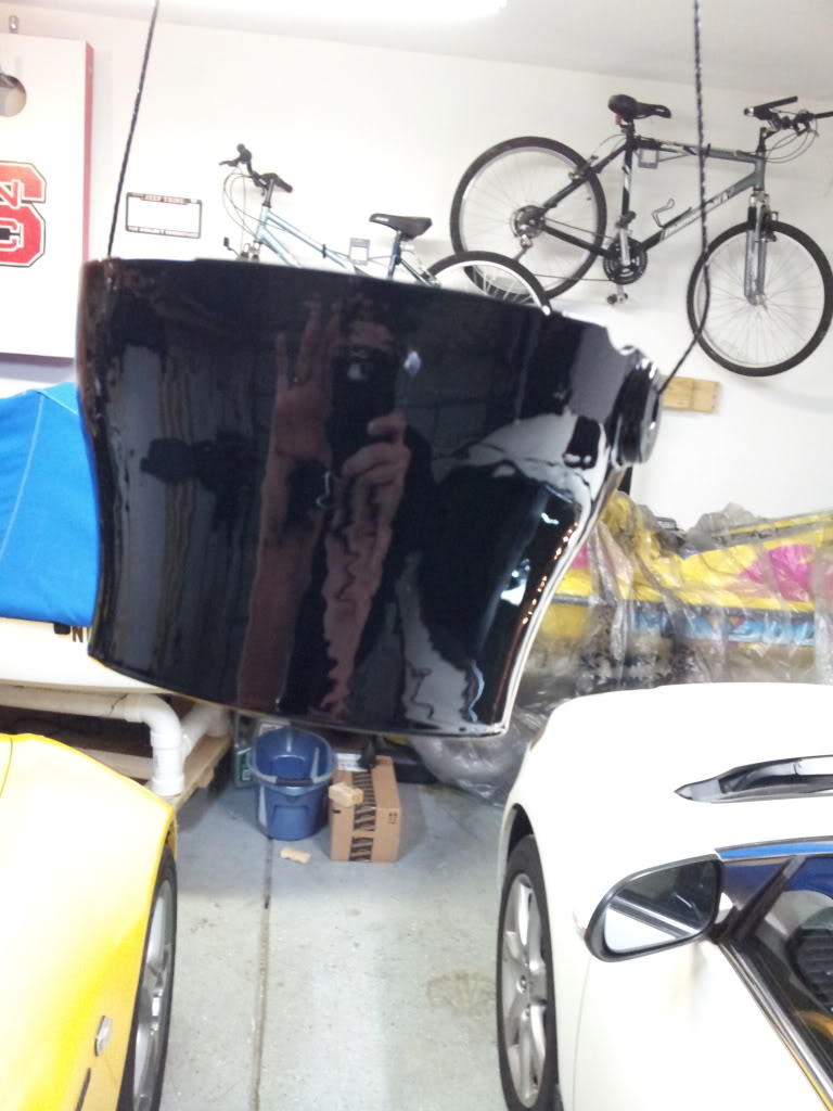

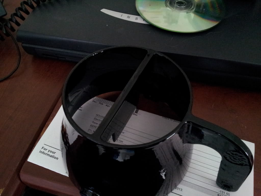

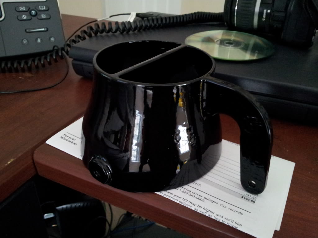

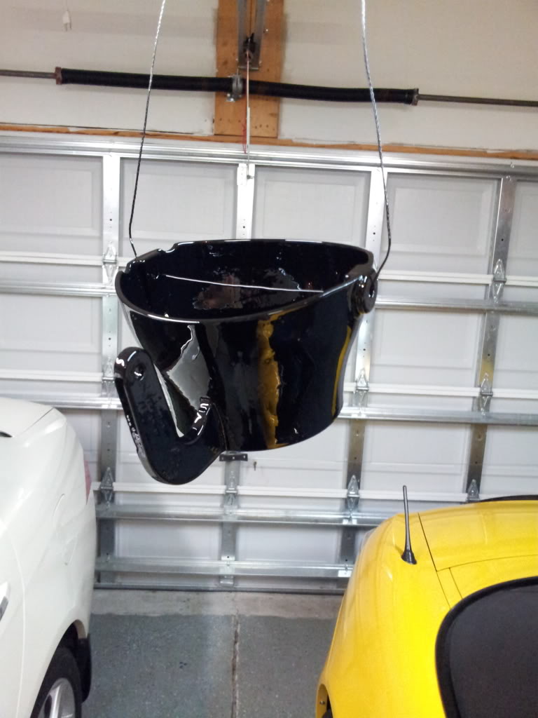

So some day this week I'll run it by so I can get to putting this back together. Figured today I'd go ahead and paint the steering nozzle. Painted this in the same epoxy paint I did the intake.
It's all done and hanging in the garage drying.
Apparently the paint isn't quite set. I picked it up and it left a fingerprint in it. Dammit!
Looks pretty good.
I can't find it now......so maybe it's still wet enough that it smoothed out? This stuff is weird......it doesn't react like normal paint I'm used to. Never really dealt with epoxy paint before.

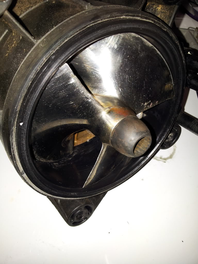

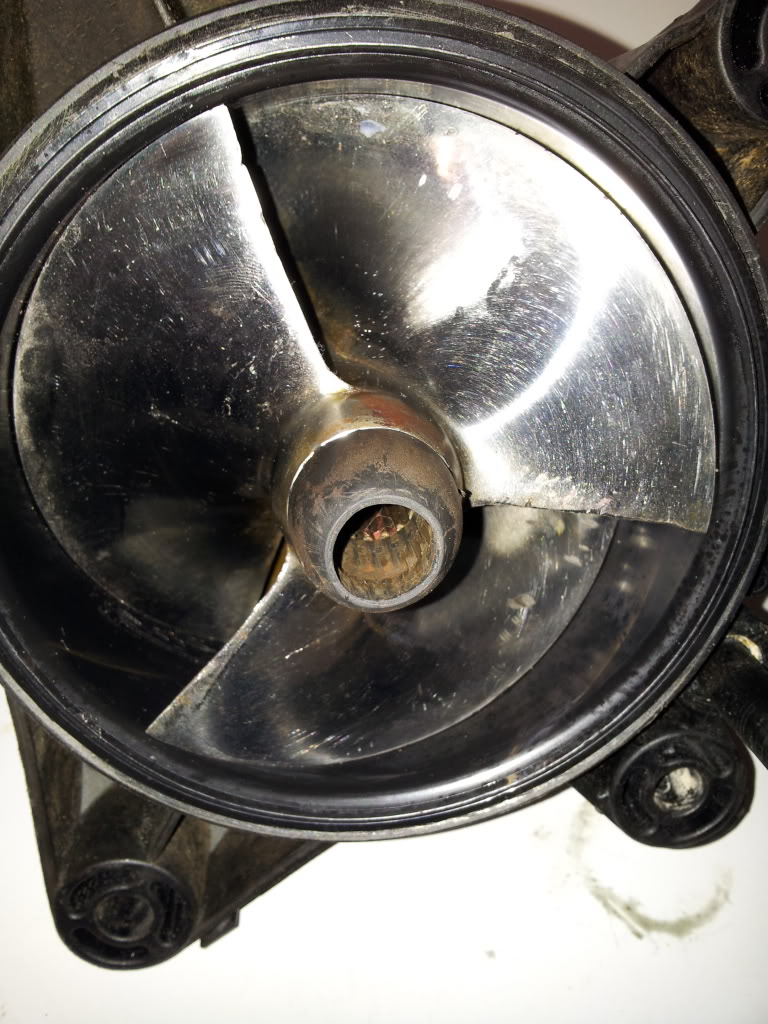

So finally had a spare few mins to work on the ski. Cleaned up the edges of the prop a little bit, put in the wear ring, and pump oil.
The wear ring took a bit of persuasion to go in. Seemed like I was really hammering on it and it wasn't going anywhere. Then finally all the sudden WHAM it went down the rest of the way. It's hella tight on the prop. Like tighter than a virgin on prom night....tight. I can spin it with my hand, and if I look through the pump I can see light on all parts of the prop. So it appears there's a little bit of clearance. Read the service manual and it says absolutely nothing about being too tight, just being too loose. It's not so tight it's making any groove in the wear ring or anything. Not much to really take pics of, but took one of the pump.
I like a tight wear ring myself. Looks like you have a Solas impeller there. 17/26 is very tall as you said. It won't make you go faster because the engine will be overloaded. The normal sweet spot for the Solas is their XO which is 16.5/23.5
Yeah no way that prop is coming off, so if I wanted to change the impeller I'd have to get a new pump.

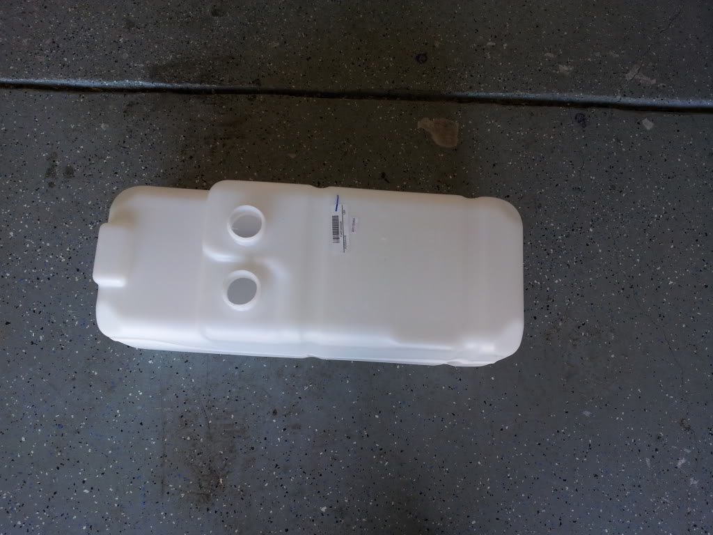

Very nice, those free tanks are a great deal, mine came in a couple weeks ago.
