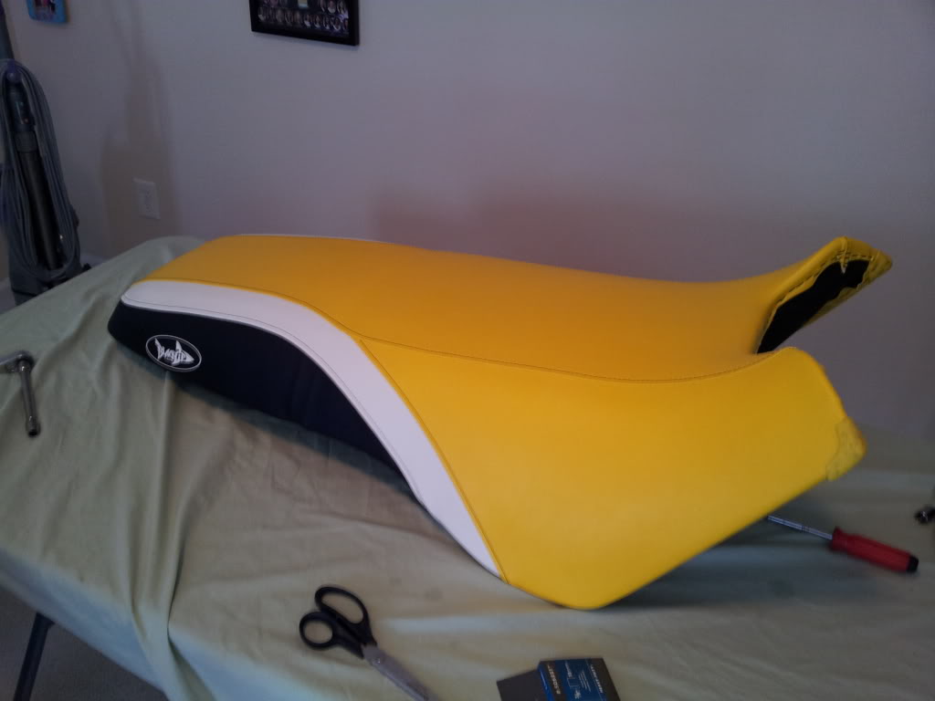

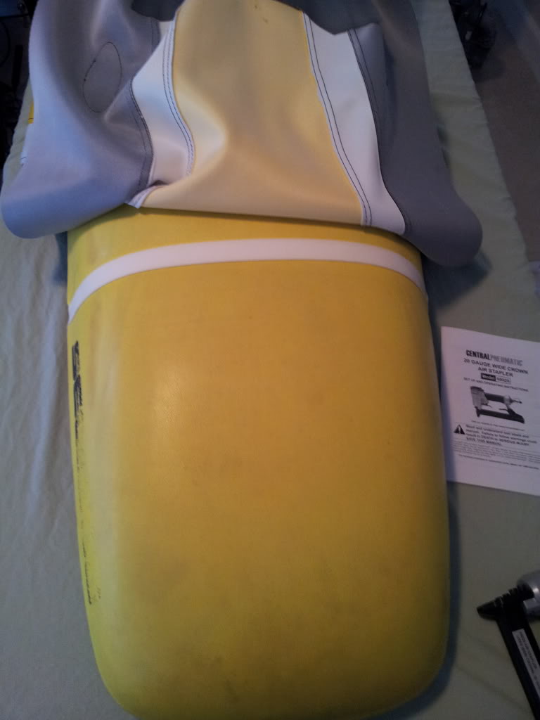

Sorry did not see this sooner. If you do it again just remove 10 or so and then run a phillips screw driver or a flat head under the vinyl on the inside of the staples that are still there and then just pull up, the staples will pull up with the vinyl then just continue sliding the phillips along the next section of staples

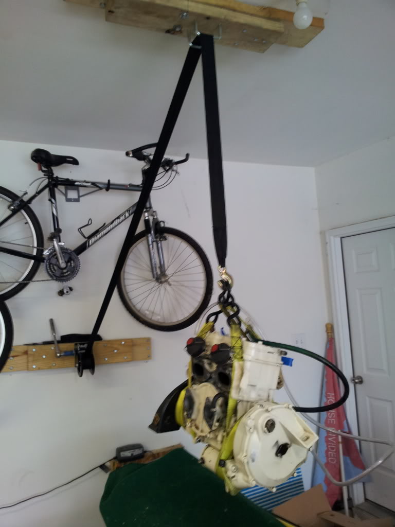

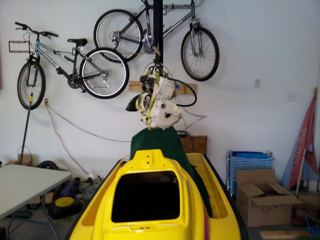

I dropped my wife off at the airport, picked up some steaks, made some chicken chili.....oh and built an engine hoist. Then put the motor and gas tank in my ski.
FYI I DO NOT condone this. Sooooooo I was sitting in the garage, had 2 hours before I had to get to work, and thought how in the hell could I get the motor in by myself. Looked around the garage......what do I have? I have some left over 2x6's, bunch of lag bolts, and some ubolts I bought for the trailer that are too big. Already have a winch on the wall to haul my skis off the trailer.....BINGO! I hung on it and weigh 185lbs and it held me just fine. So figured it would hold the motor with ease.
It was kind of a bitch to get the driveshaft with rubber tip thingy in the motor.

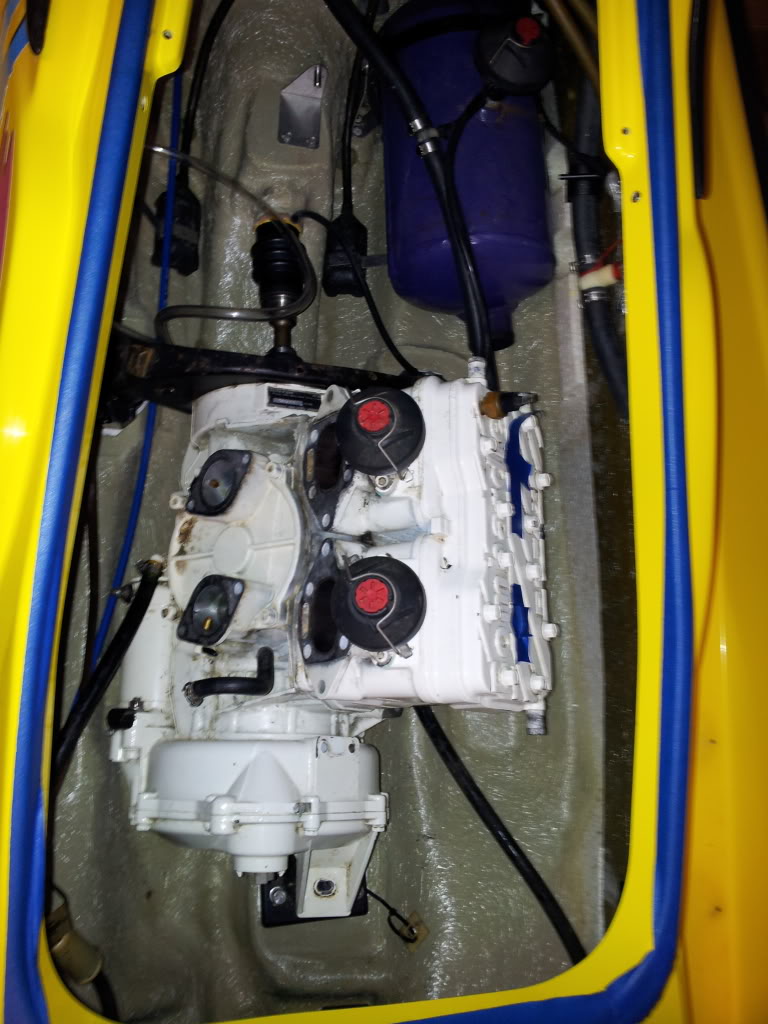

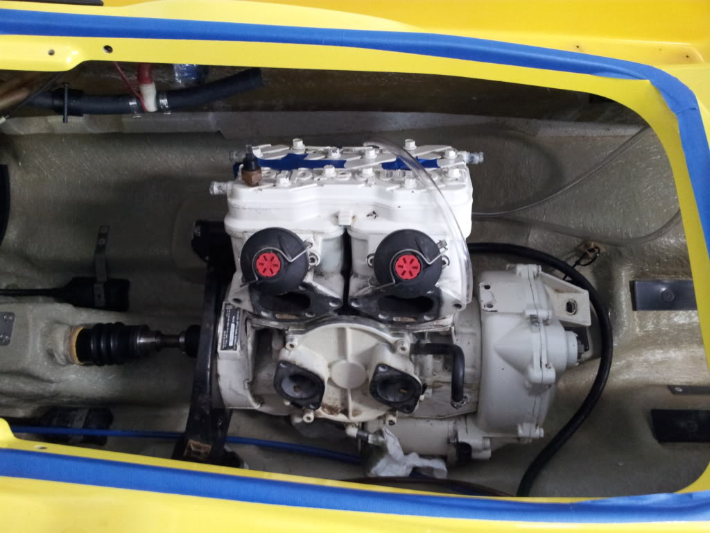

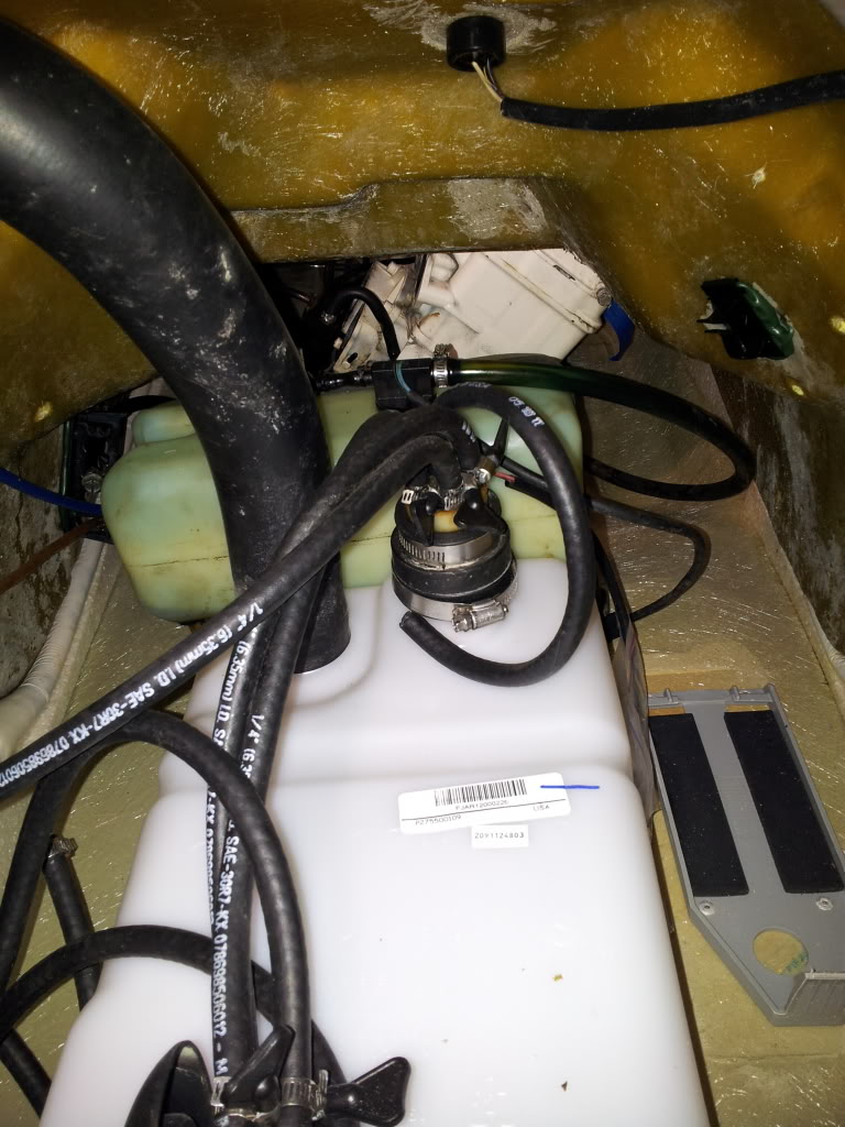

So in between meetings today I've been able to get a little more done. Apparently I lost the bolt to the accordion type clamp for the exhaust. DAMMIT! So right now I just have everything sitting in the hull and not bolted down. Just to make sure I don't need to move things around.
Got a little more done but don't have pics of it. Next is getting the pump on. Then doing anything else that needs the through hull sealant stuff that I need to use up( plugging foot pad holes, intake grill, etc). Dreading the electrics and the hood. Especially putting the wires back in the weatherpacks and making sure they're right.
I have one meeting left at 3 and I'm DONE for the weekend. Then it'll be jetski time until I passout. HAH!
Got quite a bit done, but doesn't really look like it. Forgot how much little shat there is to do.
Motor is now bolted down, pump is in, air louvers are in, sponsons are on.
Been up since 5 today. I'm wiped and starting to make stupid mistakes. It's time to hit the sack and go at it again tomorrow. Plan to do the seat at some point tomorrow as well.

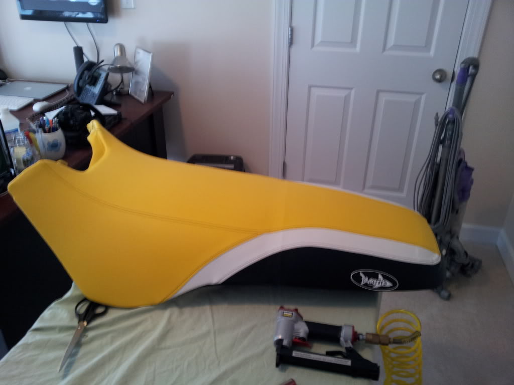

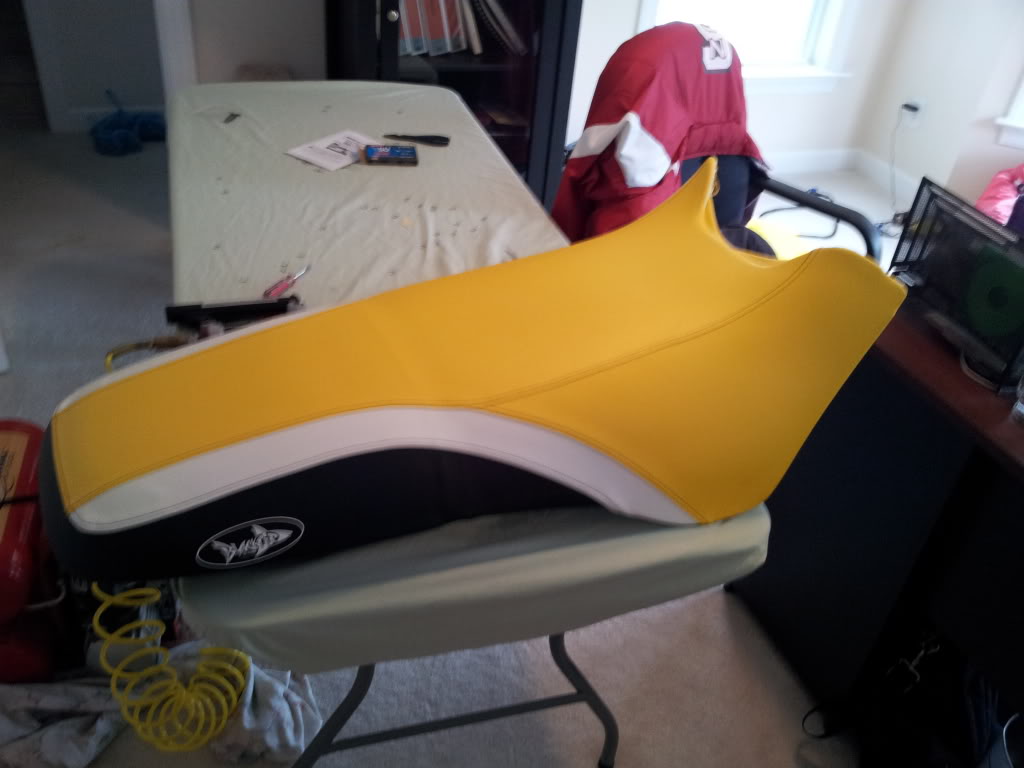

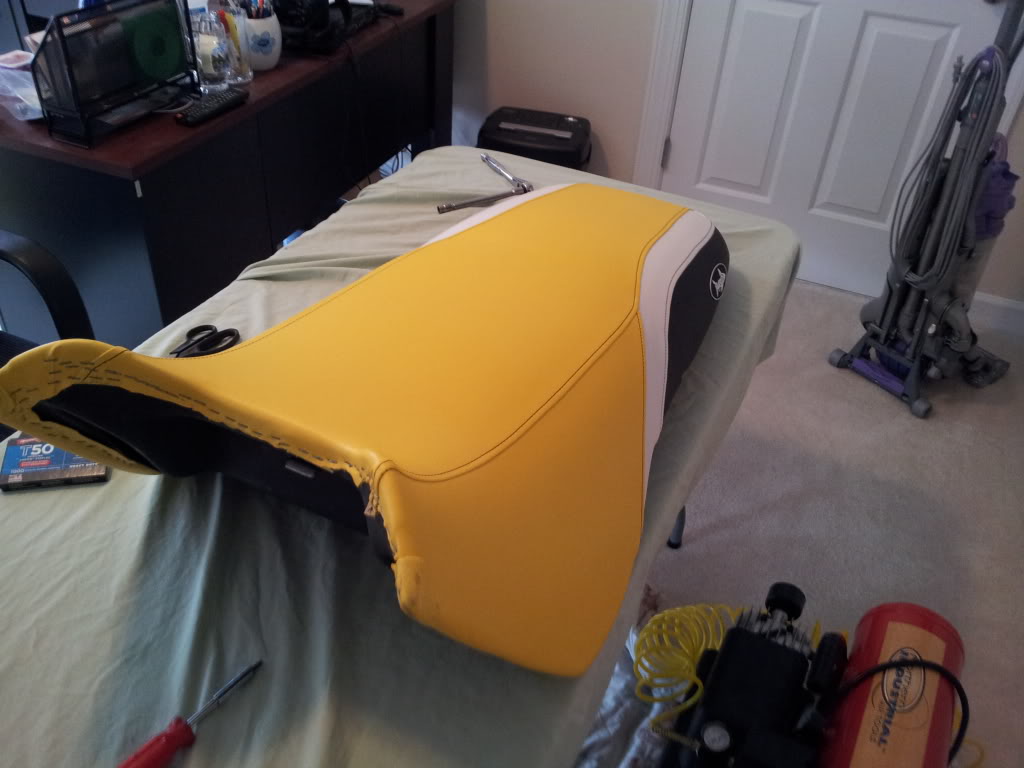

So 3 hours in today and this is all I've got to show for it. I'm def not quitting my day job......I'm not very good at this. I won't even dare show you my suck staple job. LOL

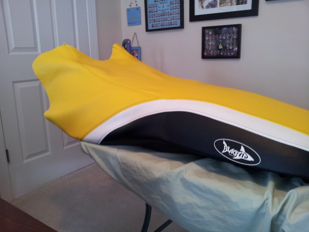

So that indention that drives me nuts on some cover jobs......I put some double sided foam tape down to help out. Doesn't look perfect, but works.

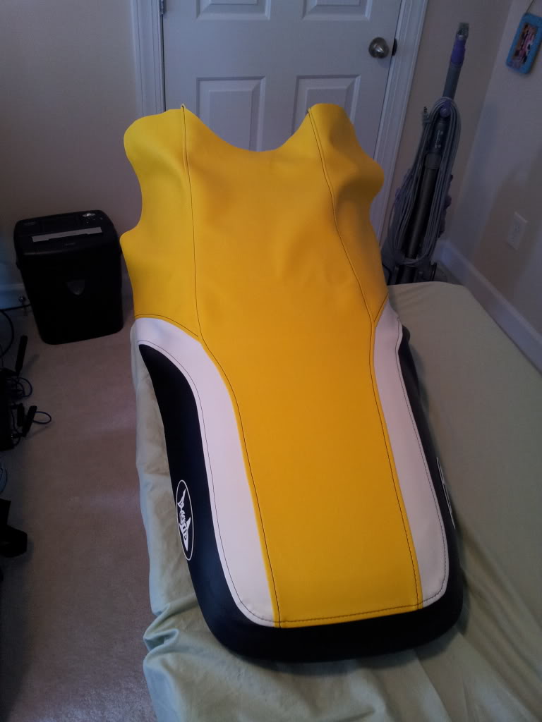

Getting there.
Done

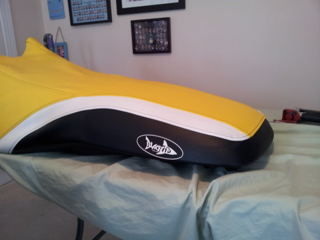

Looks good! Oh, the seat does too. That strap dent drives me nuts. The only thing I wish is that Hydro or BT would do is when you choose the same color for the top and "front" side they wouldn't stitch it. It would make a much nicer product for sure, but your's looks good don't get me wrong.
Yeah I agree. It's kind of a pain to try and line that stitching up. Mine doesn't quite line up, but oh well.

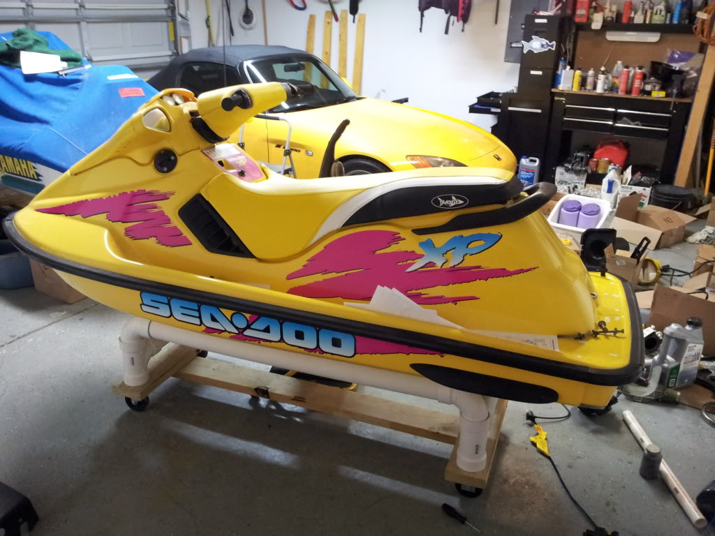

I can't possibly do anymore tonight. I've gotten to the point I'm not thinking clearly. Started making stupid mistakes, which I tend to do once I get exhausted. Past that point a few hours ago, but HAD to atleast get the exterior stuff done.
I detail cars all the time and put in 13 hours days quite on the regular.....however, this whooped my ass. Anywho this is where I stopped.

Ribeye is correct! My favorite cut of meat. I prolly have about 5-10hours left. Carbs, finish the exhaust, hook up the starter, and other odds and ends.
Ha, I know my Rib-eye's, everything else is junk to me. I noticed you skipped the bone in every cut of meat? Bone+Marbeling=Flavor explosion. Damn, now I'm hungry again.
Don't forget to change your inline oil filter, I hope you didn't fill the tank yet. And wipe those lines down. Those graphics look great, it's totally different looking at the ski completed exteriorwise. Great job.

I'm going with premix so no filter needed for me. Unless I hooked it up wrong. lol I haven't filled any tanks yet. I wiped the lines down already.
