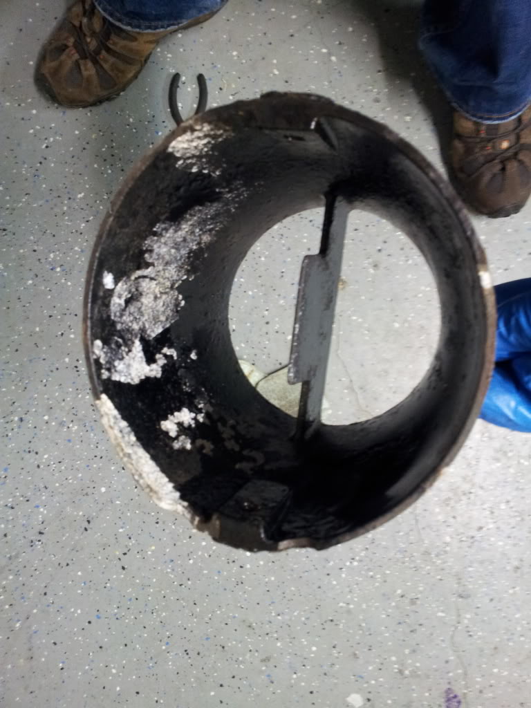

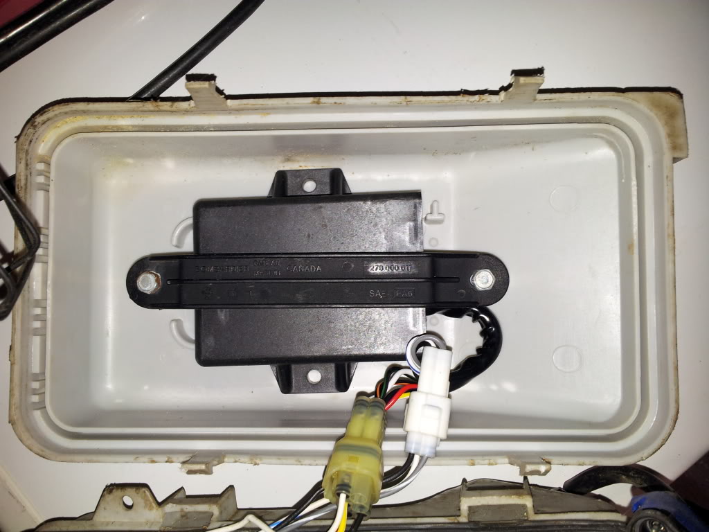

Starting to get everything cleaned up to go back in.
Appears someone has been in here before.
Looks clean in there though.
Pretty dirty
Much cleaner

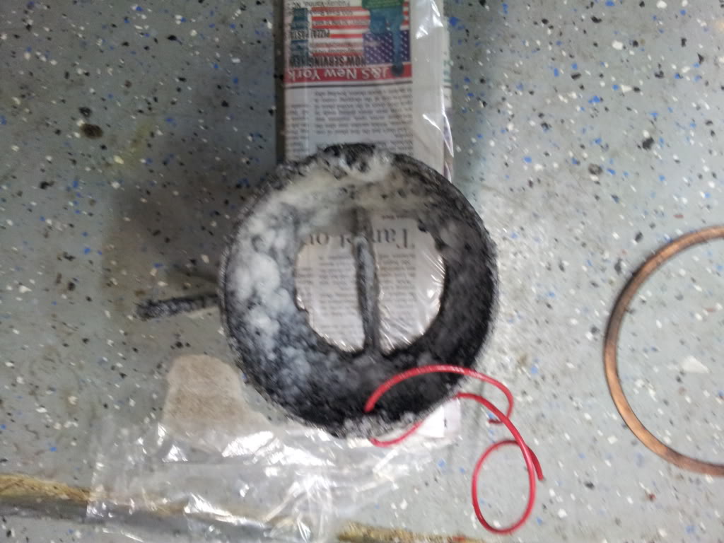

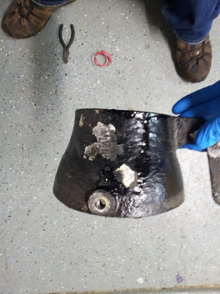

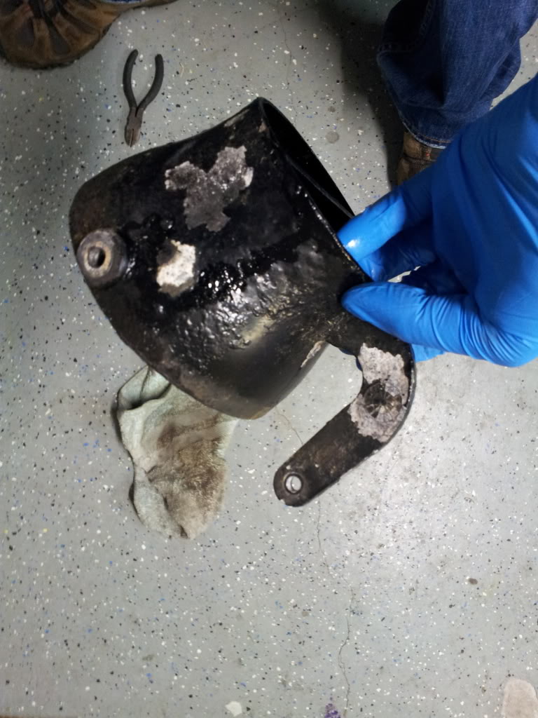

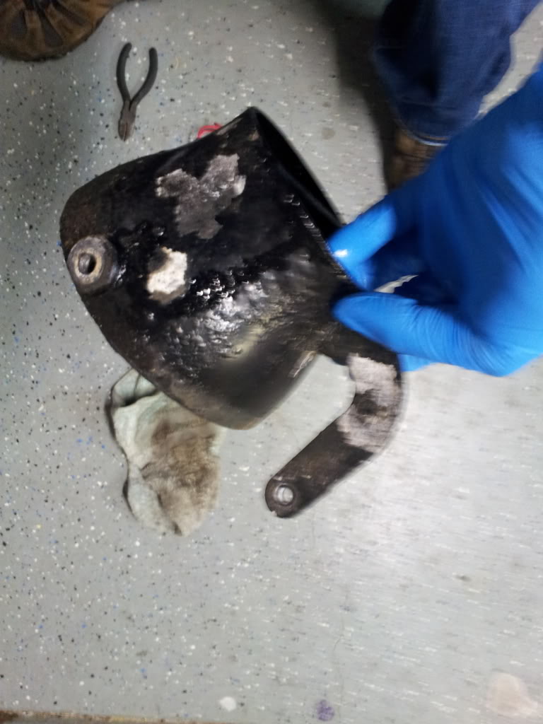

Gonna strip this and repaint it. It appears someone did a very poor paint job on it.

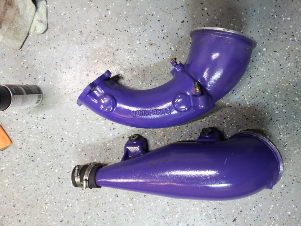

Exhaust all cleaned up ready to go back in. Waiting on the copper washer to come in.
Paint stripper at work.
Most likely won't get all the paint off. After this next round I'll sand it smooth, then scuff it, then paint it.

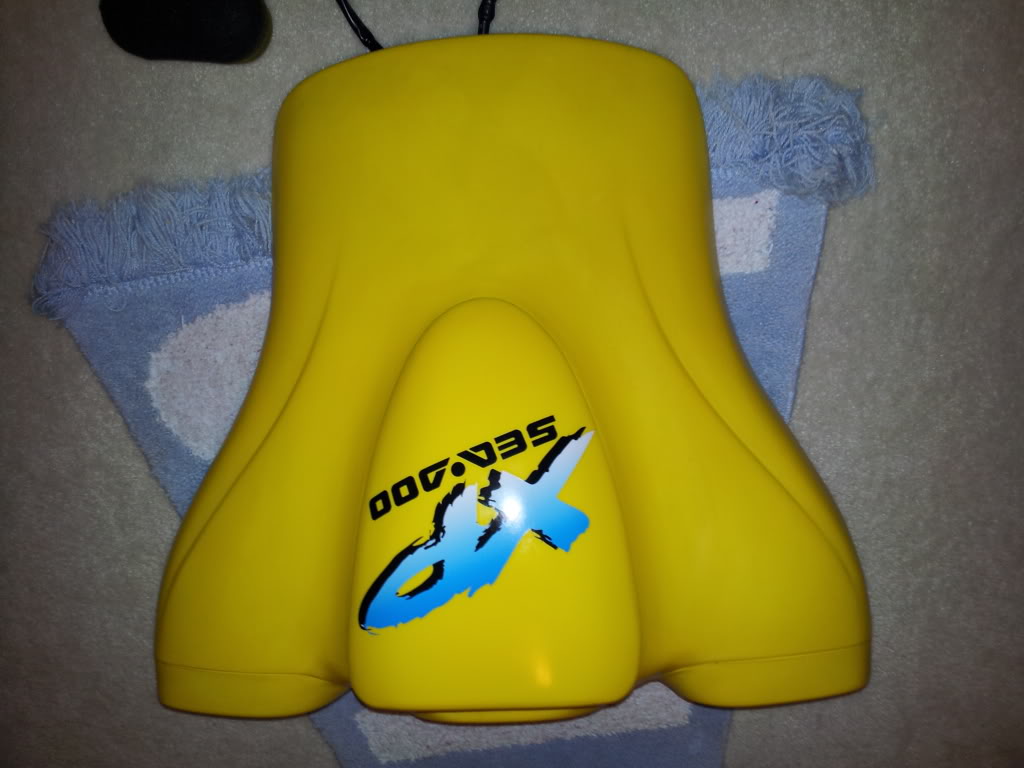

The new hood with the new hood cover in place.

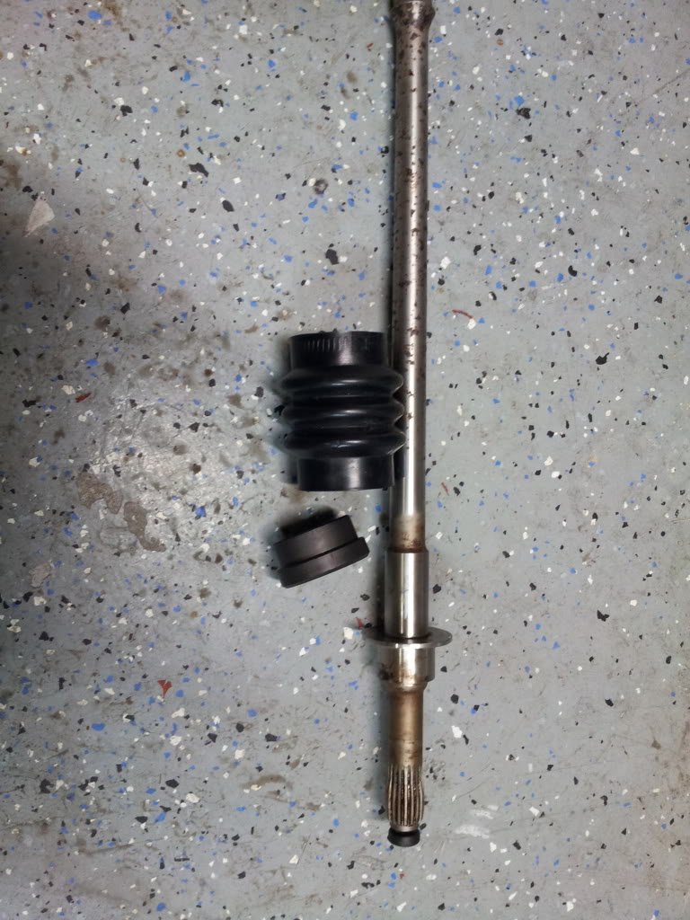

That stainless ring won't budge. I can see a rubber gasket down in there. I took some pics of what I have.
This is what I have
I have the clamps, they're just not on there right now. Also I have the rubber boot on the engine side but let that on the motor. But that's all I have on the pump side. The carbon ring isn't tight on the shaft either. Is that all normal?

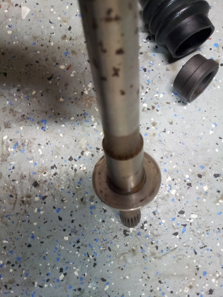

Can see the rubber seal in there
Dark ring against the stainless steel ring led me to believe I'm missing something.

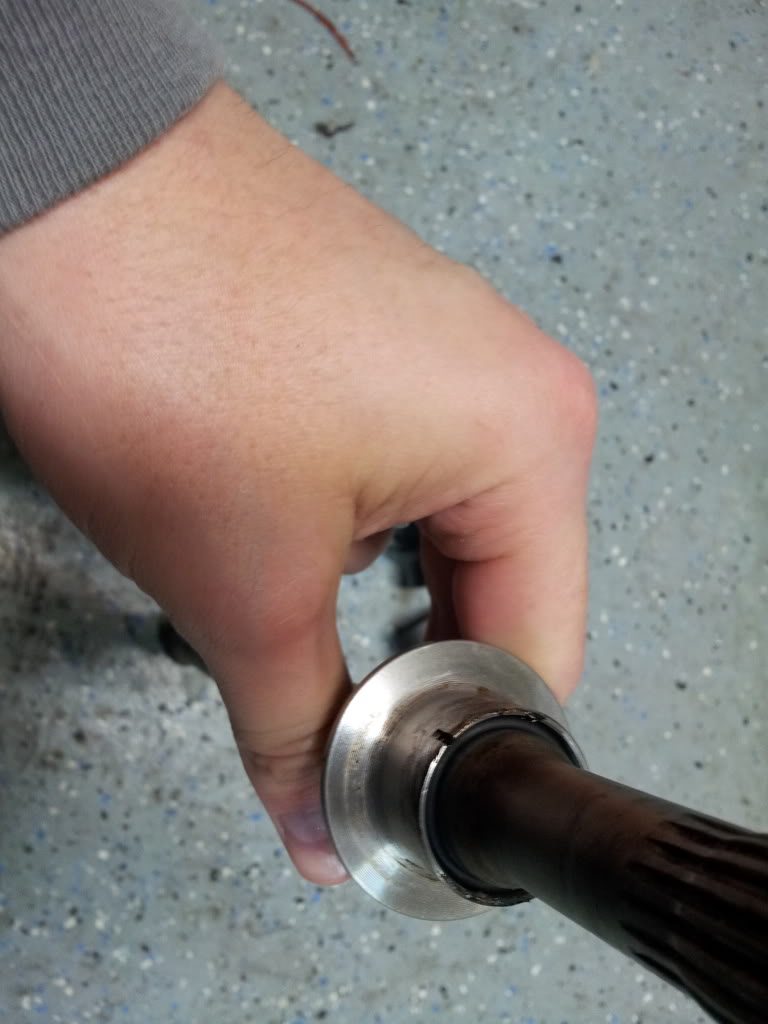

However I have no idea. That's all that came off when I took if off. Is that right?
I really don't want to move that stainless steel ring as it's fixed on there VERY well and I don't want to create more work or break anything.
I'd make sure you can remove it so if you need to service it in the future you can. If not you'll need to pull the engine to do so. Hose it down with wd or something or just use a torch and melt the O-rings out of it. The ring seal the stainless to the shaft. Remember try and push it towards the long end if the shaft. The rings are probably suck to the shaft. And the carbon ring doesn't touch the shaft, just rubs the stainless piece you can't get off.
