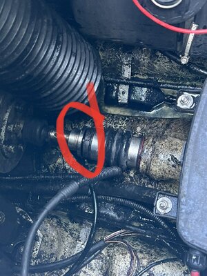

All, I took the pump off to replace the reverse lock nut and put it all back together. The issue I’m having is that when I put the pump back on and begin to tighten the nuts back onto the studs on the hull, as the pump starts to adjoin the drive shaft, it pushes the driveshaft toward the engine and causes a separation between the carbon seal and the metal driveshaft ring or seal (not sure of the actual name.) and when I put it in the water, an enormous amount of water was coming through the gap. here’s a pic of what I mean.
