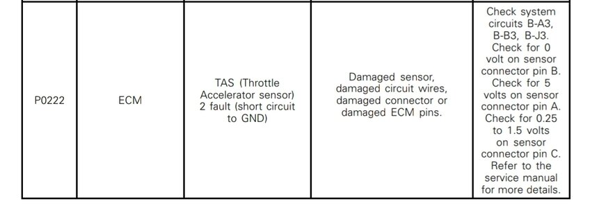

After Riding my GTI 130, I noticed that it has a problem accelerating and flashes a P0222 Fault code on the dash. The problem accelerating is around 10 mph but past a certain threshold it is fine and is able to reach top speed but has some trouble around 10 mph. I just replaced the throttle body hoping that it would solve the problem but it still seems to pose an issue. Does anyone have thoughts on how to solve?
