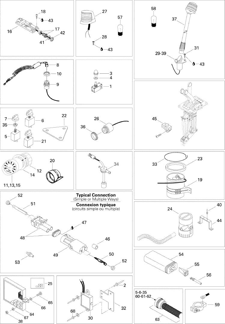

The Neutral start switch is on the gate control handle, it is part#45 on the picture. What USAF was trying to say is, put the gate lever in forward or reverse and try and start the boat. It should not start, if it does I would suspect a bad switch. At the same time the boat should beep 4 times telling you you're not in neutral. You can check continuity of the switch with a DVM.
The neutral switch is in the throttle assembly. Does the boat start with it in forward or reverse?
