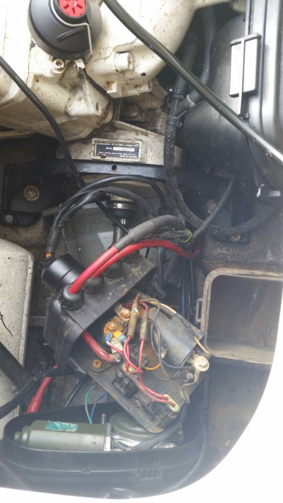

I've been fighting a run away idle. Finally turned the idle screw down and it doesn't run away anymore (after tearing it down and pressure testing it) BUT NOW I'm fighting a electrical gremlin. One time it won't turn over but I do here clicking in the gray box. Another time it will turn over but no spark and of course sometimes it will crank and run great. So I'll be going over all the electrical connections just frustrated and thought I would put it out there. I also put a working vts in the ski and it worked great and then didn't. I hit it with a hammer and it started working and not to sure if it's the electrical gremlin or if the housing just went bad.
Sounds like a bad ground. Probably the small wire that goes from the battery to the plug on the rear ebox.
Run a new one directly from the battery to the bottom of the coil where they all tie together
If it looks like this one get a new one
A swift, unexpected blow from a hammer lets a failing VTS know you mean business!
Been there many times my friend.
Yes that rear ebox is the issue I'm sure. It will come back with a wire wheel and di-electric grease but that power cable looks like it may have some internal rot. Your VTS may work also once you get clean power to it.
That was it cleaned up the black box and bam all fixed!! When I first looked at the box today it looked fine but once I started cleaning up all the connections I understood why it wouldn't run the grounds especially were dirty as hell. Vts still don't work but I didn't have time to go over those connections yet. Thanks guys
