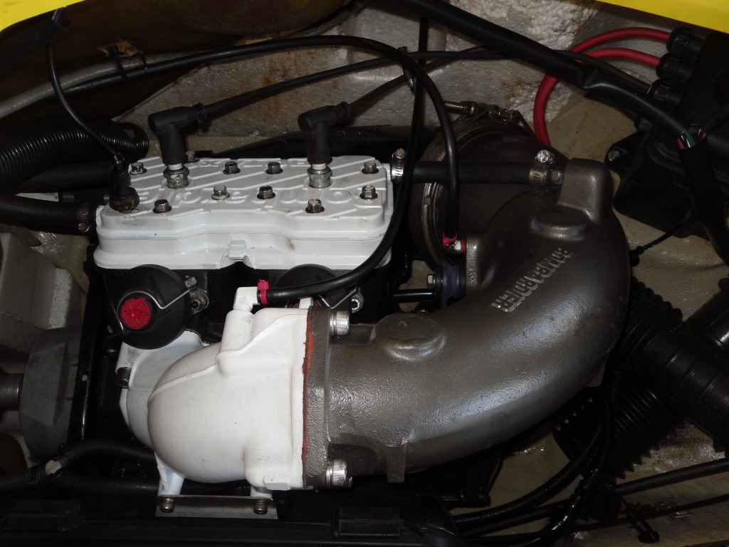

it isn't much as far as pic's, but here's some hammer finish (at least i'm 99% sure they all are, some of these pic's are older) I'm guessing back in the day, that we used hammer finish on probably 6-8 engines with great results, It still looked new on mine 3 seasons later. It coats Extremely well.
That dark grey or charcoal is a nice choice. It doesn't show dirt or oil easily like a leaky rave down the side of a bright color.

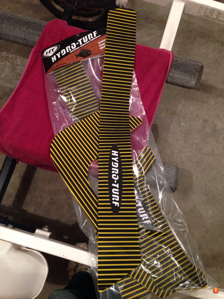

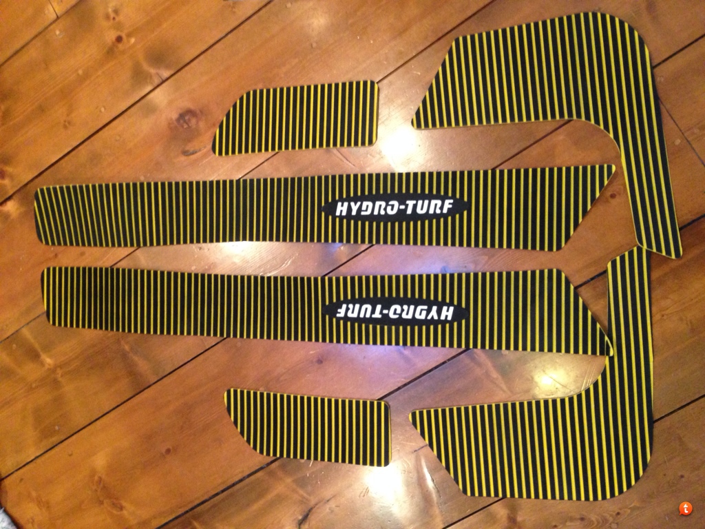

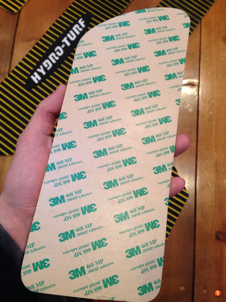

I did come home to a little present on my door step though, unfortunately they won't be going on until the outside is done being wet sanded, buffed and waxed:
2 tone black on yellow with 3M adhesive. Cost me $110 shipped to my door. I think these will look killer in the white footwells!

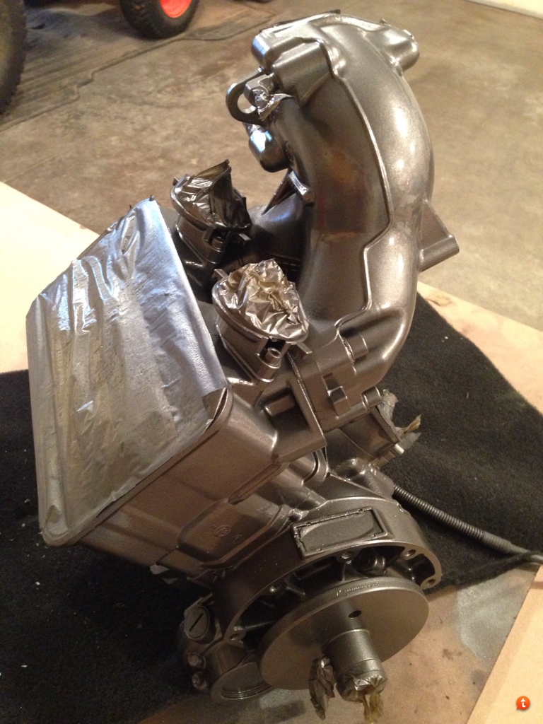

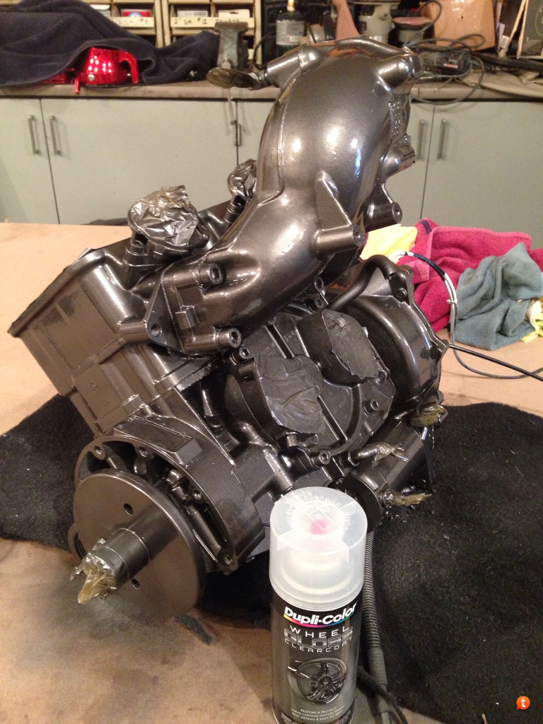

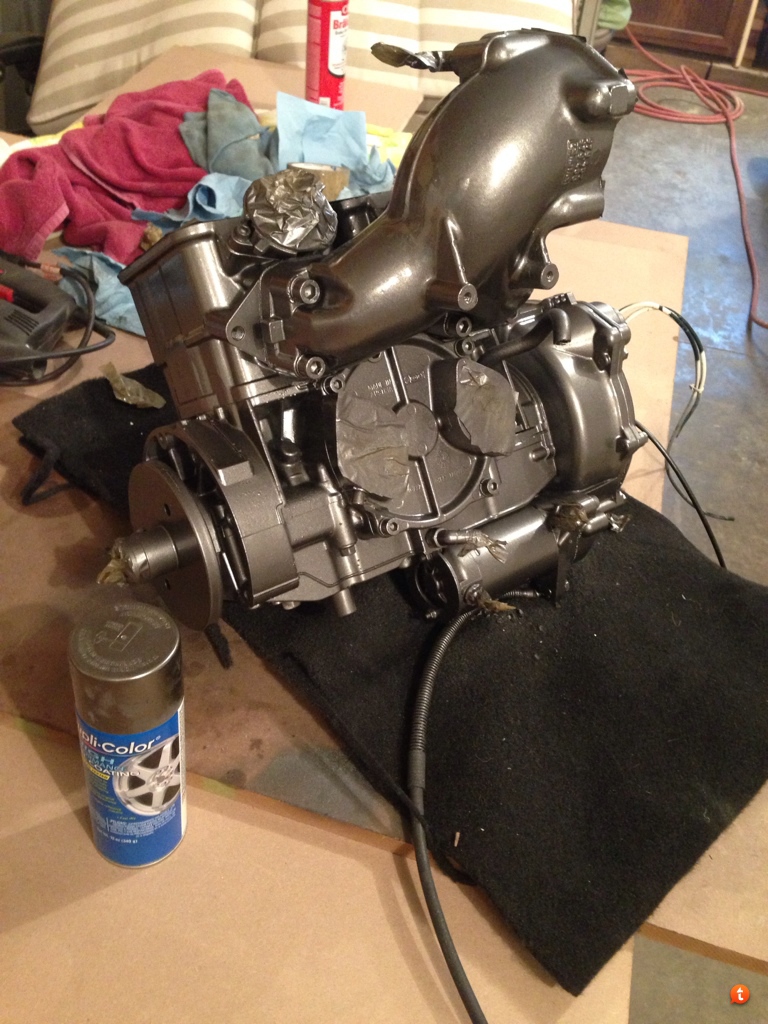

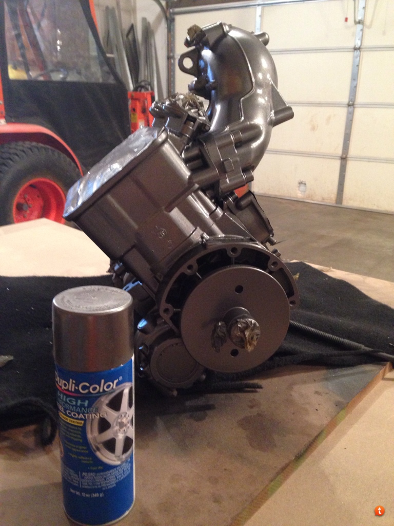

Finally had some more time for the resto today, got the motor all painted up. Thanks racerxxx for the paint recommendation, it turned out great IMO. The duplicolor wheel paint lays down extremely well!
Sent from Cody's iPhone
Now hit it with the clear, it's 100 times glossier That it's if you haven't already, hard to tell from my phone.
Sent from my SGH-T889 using Tapatalk 2
I'm very pleased with the color, glad It turned out the way I was invisioning. Here it is with clear and like racerxxx said above its hard to tell, but the clear made a huge difference.

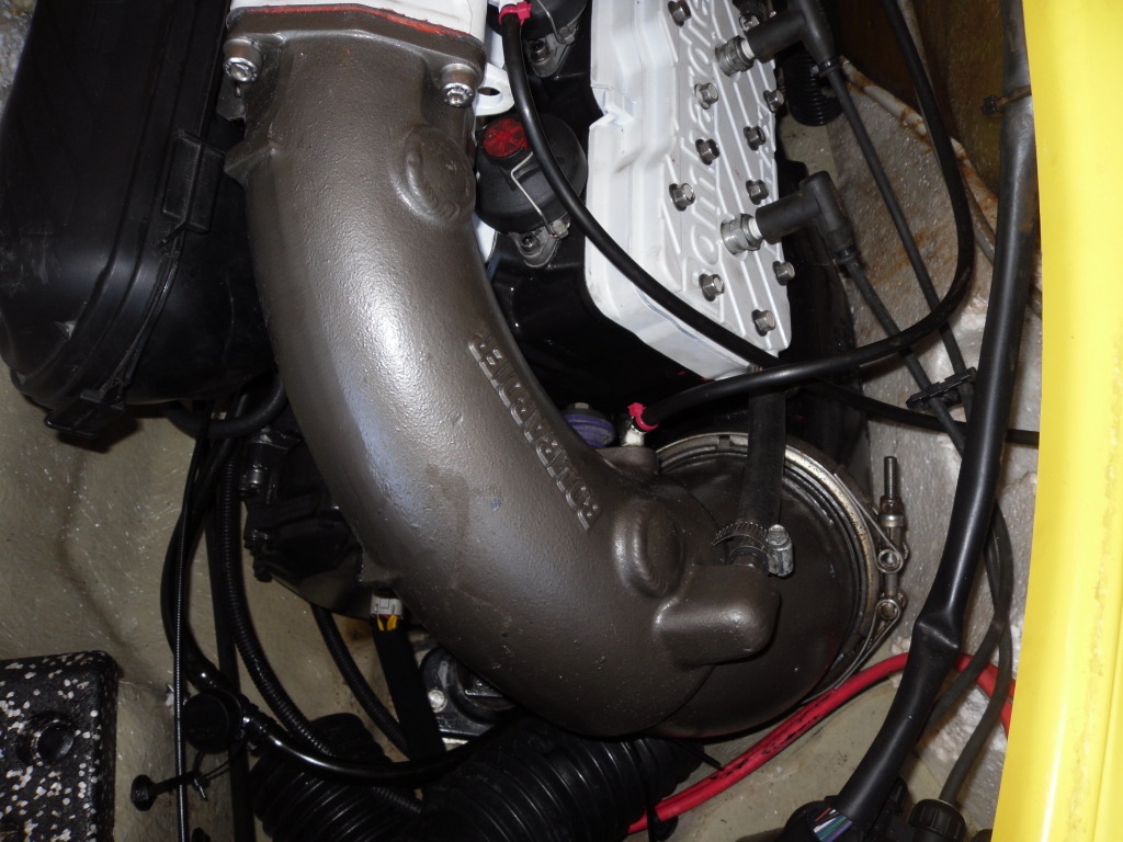

The clear on that color makes it pop. I noticed it when I painted the pipe on my 96. Now I can surely tell the difference after the clear. I don't clear the white, I lather it with the Seadoo lube and it changes to the exact almond-ish white that Seadoo used, same with the wheel silver on my silver speedster engines.
Looks nice man, great job!

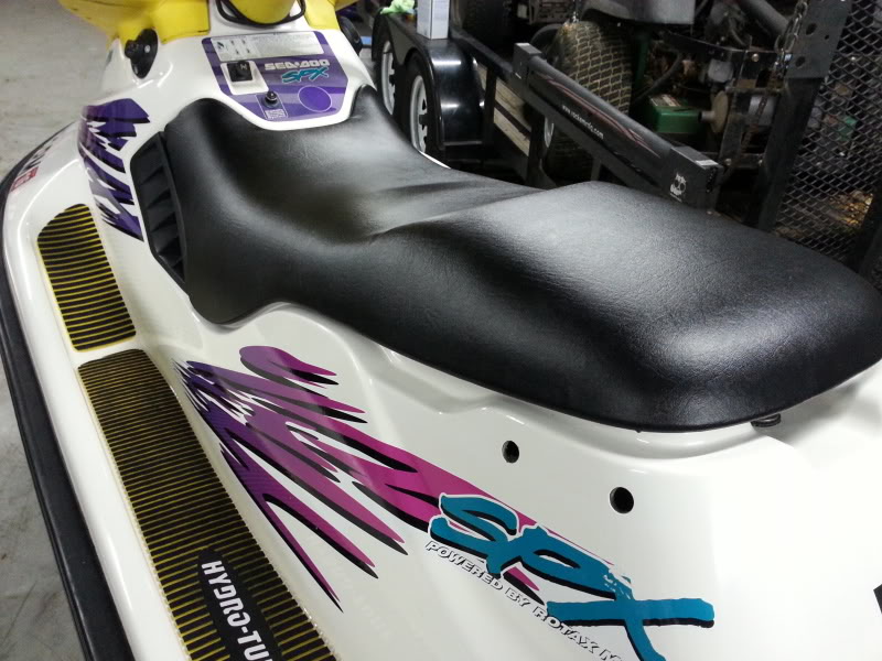

Heck ya! Thanks JSG for the visual! Can't wait to get this white top deck all finished up so I can start laying my decal scheme down and mats. Even more motivation seeing that clean 97' above!!

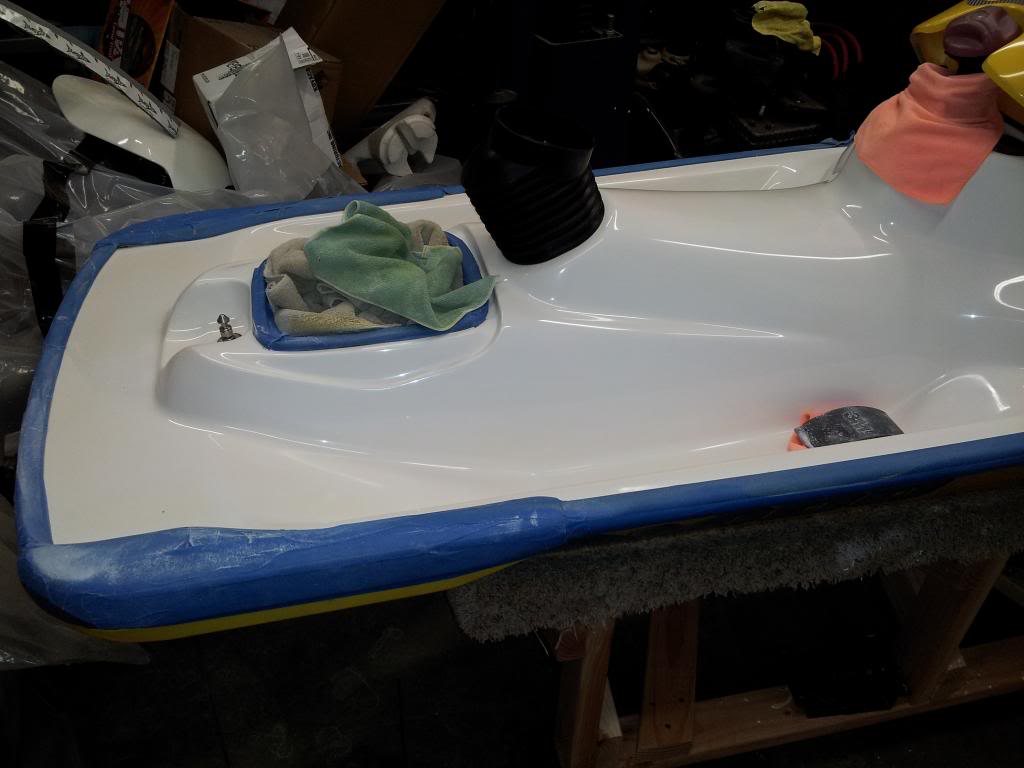

Little bummed out my powder coating buddy got sick on me :puke: so im still playing the wait game on my tuned pipe, and engine bracket. Otherwise the engine would be back in the hull already..
So, in the mean time i've been chipping away on the outside wetsanding away.. I have the bottom half completely done as stated above, but the top half is still being a complete B!TC* :cuss: What would your guys' thoughts be on painting the top deck the original white??
LOL, stick with it. Post #24 I told you it's the worst color. JSG warned me before I did it on my HX. By the time you're done getting the paint, taping off, mixing it, spraying it, cleaning up and hoping you don't scratch it you would have been done wet sanding and buffing. Trust me, once you rid the staining the buffing is the quick part. Just remember, even if you can see a little bit of staining it will be so bright in the sunlight you will blind people with how white it actually is. It's a full on commitment.
Before:
After:
Thanks Racerxxx for that confidence booster! That HX looked about the same as my SPX when i got it...
Are you finishing with 1000 then buffing? also once you get to the buffing stage are you using rubbing compound then finishing with something else?
