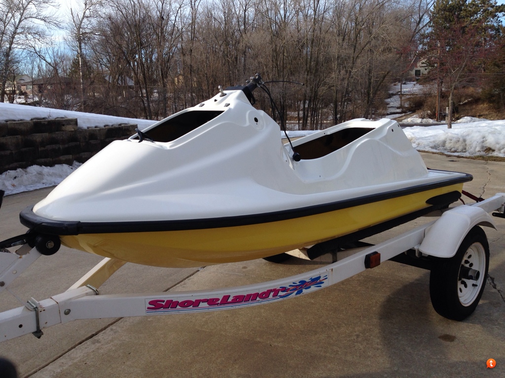

RESTO 97' SPX resto: $250 purchase
you should flip that thing and paint the bottom black. Threads like this make me seriously look for a 98/99 X4. I miss my 97 SPX, especially how pretty the motor was:

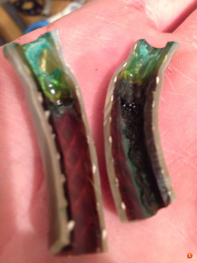

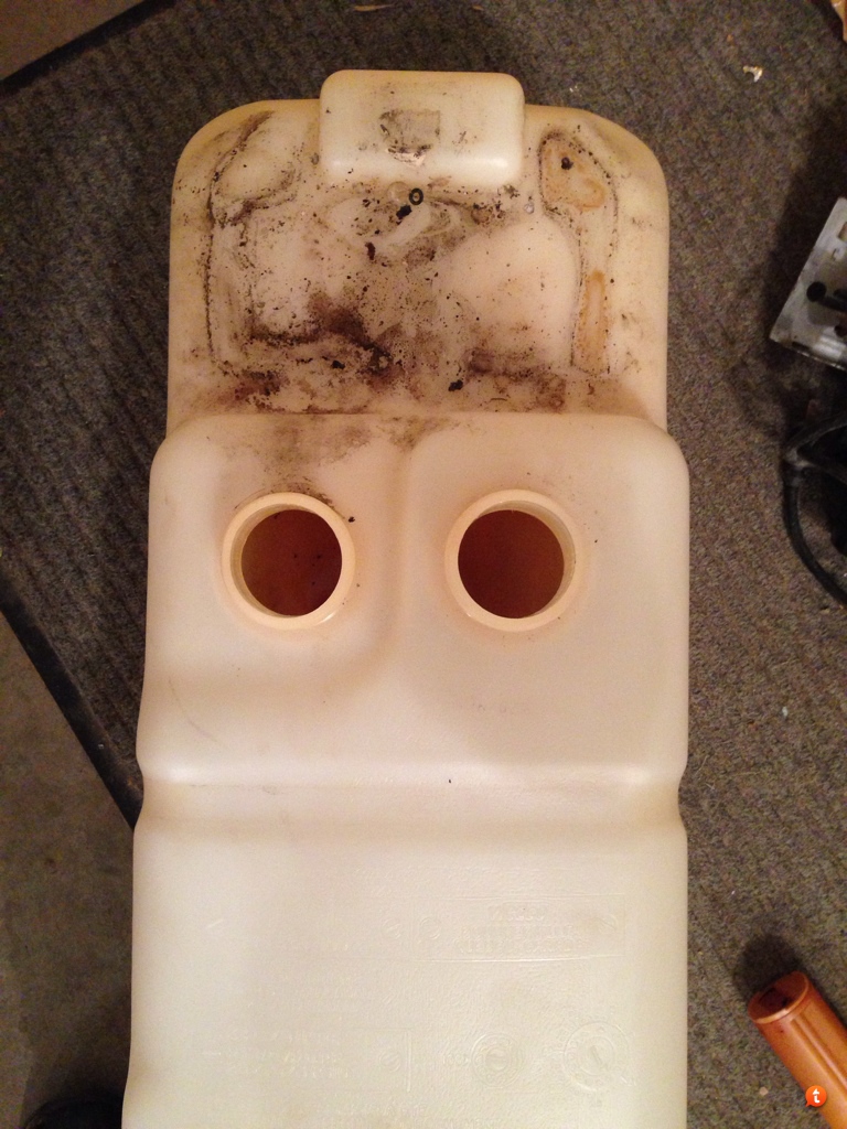

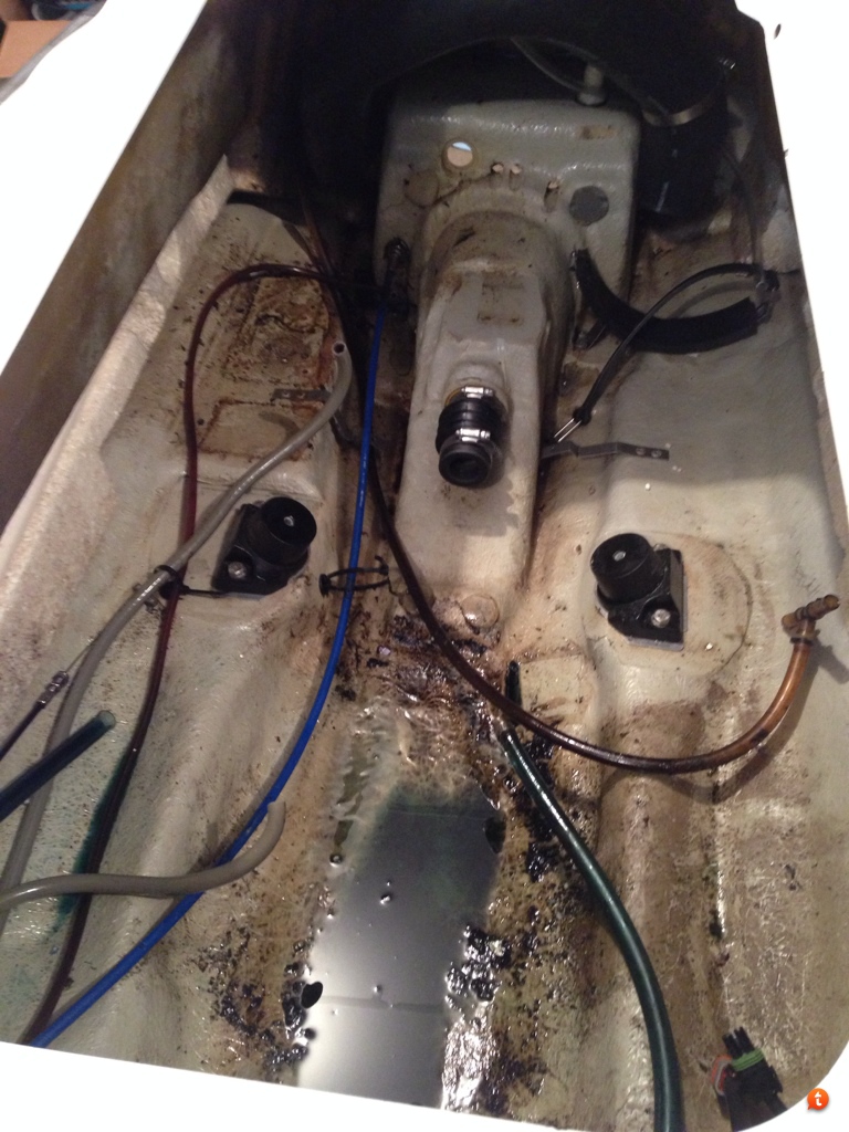

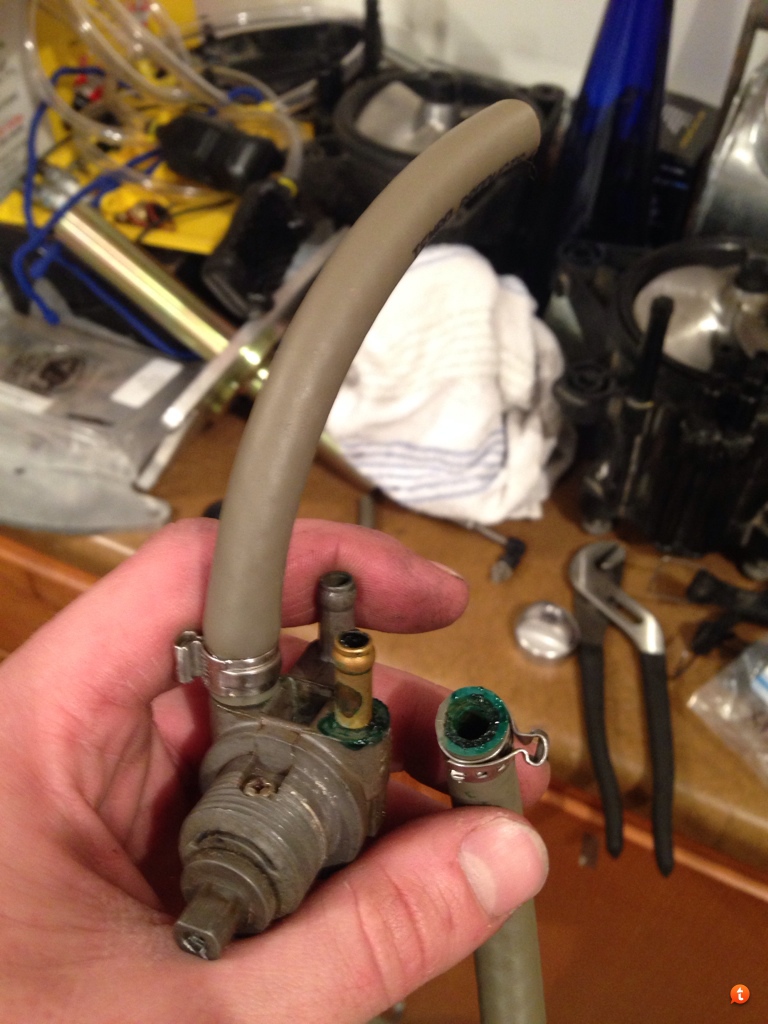

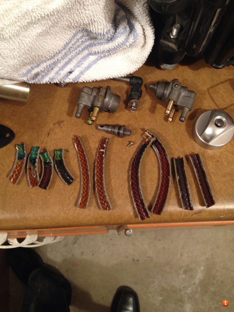

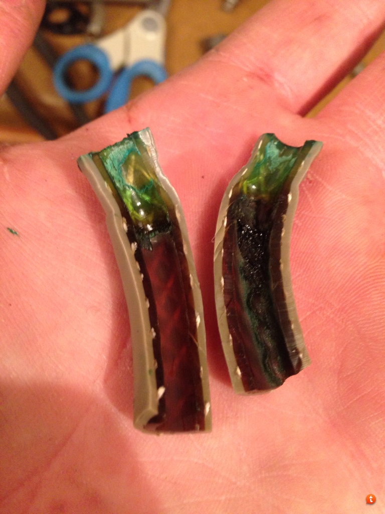

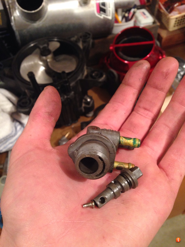

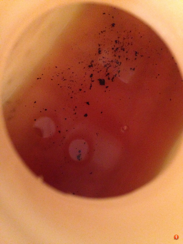

I started on the fuel system last night and found some pretty nasty stuff to say the least. But it will be completely brand new when it's all said and done. Pics below:
Look at all that crud in the tank, wow!!
^^^That boys n girls is why you change out those grey tempo fuel lines, that green goo is some nasty nasty stuff.

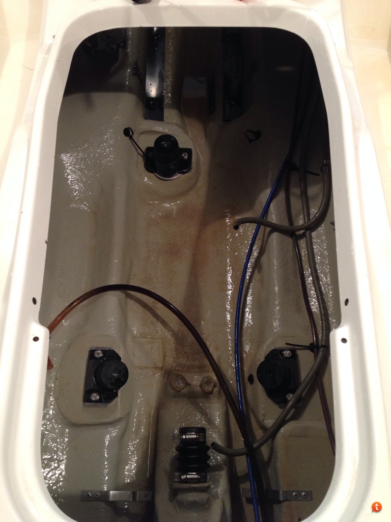

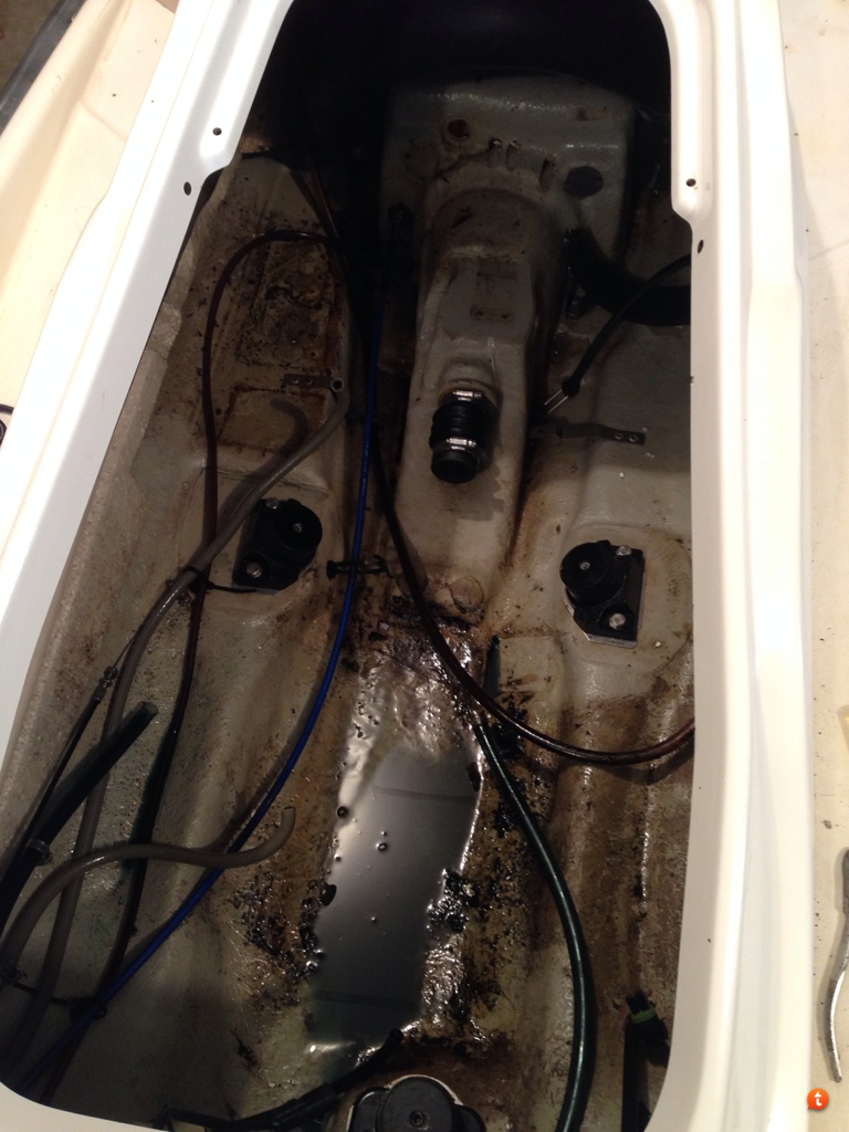

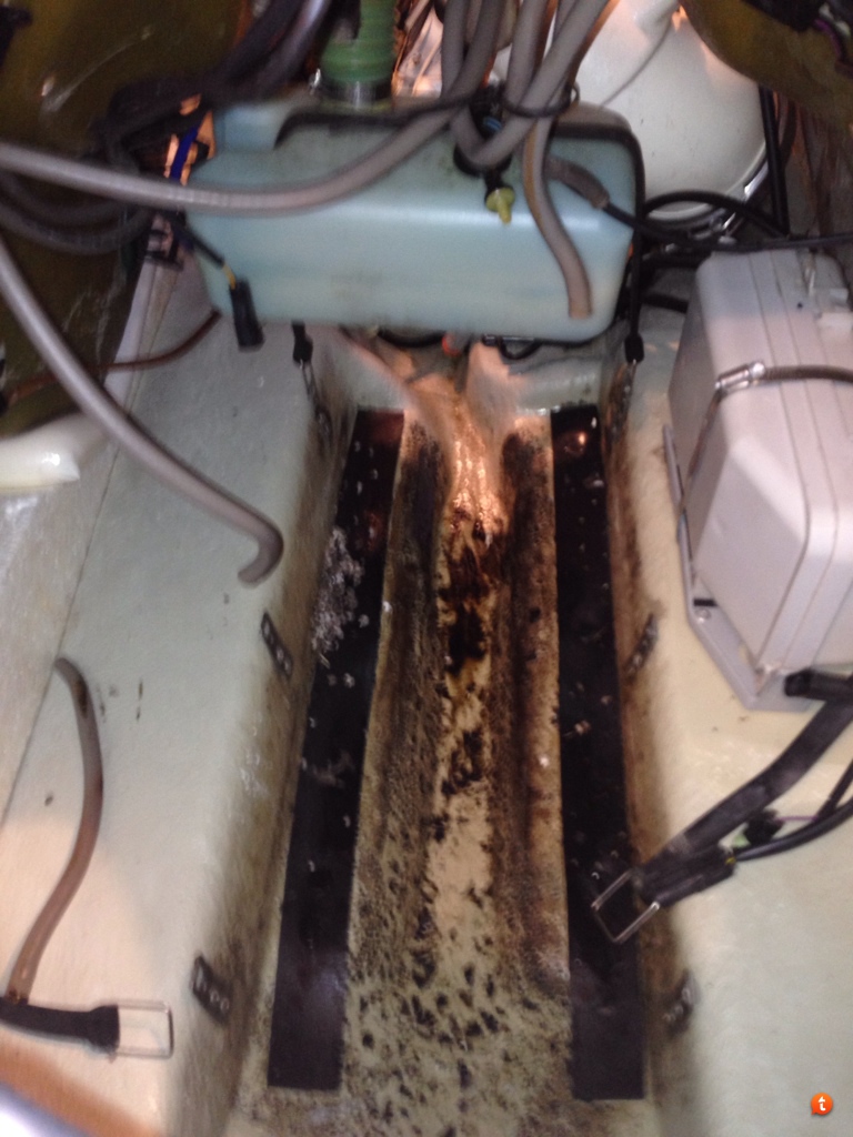

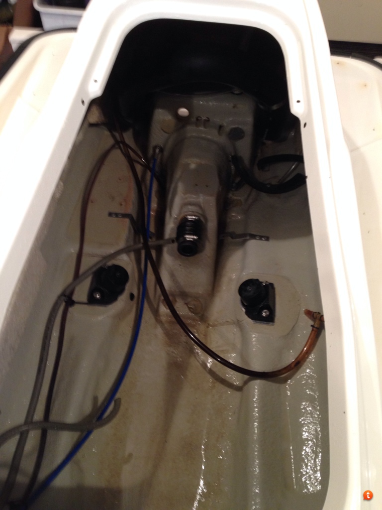

I was going to just leave the engine in and clean everything up but it just kept bothering me knowing that under the engine was disgusting, so I decided to pull the motor out today and take her up to the car wash and give the inside a douche with some super clean and scrubber brush. Not 100% perfect but a hell of alot better. My hands were frozen at the car wash after about 30 mins of scrubbing and rinsing lol
Before:
After:
Still not done wet sanding to get rid of the yellowish haze where the decals were, I've been busy making progress on other things. I will get the outside squared away soon though.

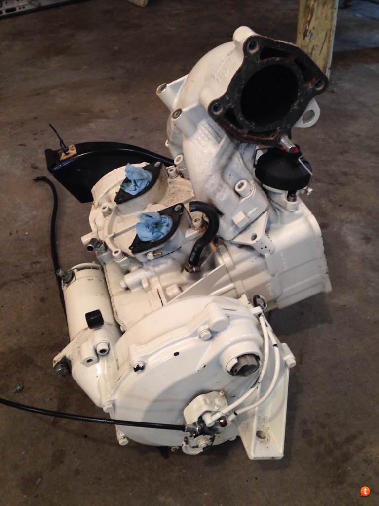

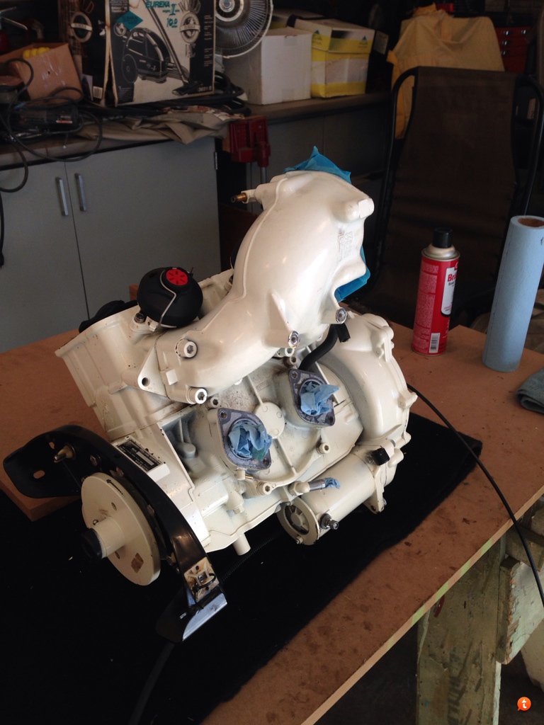

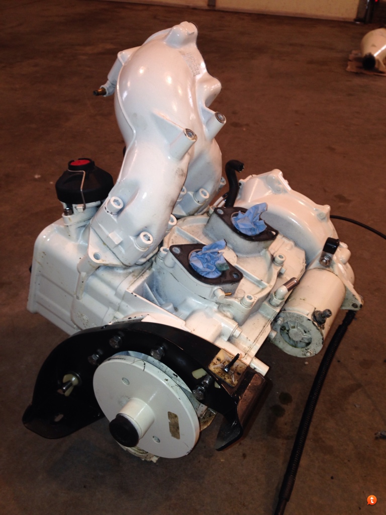

And the motor:
I can tell from the paint on the bolts and gaskets that the starter and mag housing have never been off. I wanted to atleast take the starter off to see if it was rusty inside. Took it off and was very pleased! She was perfect, no rust on starter or flywheel, so I cleaned up the mating surface and then applied some rtv around it (read this in one of minnetonkas posts) and then bolted the starter back on. No need to fix what isn't broke.

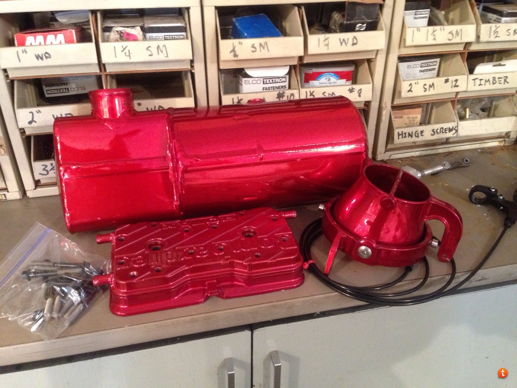

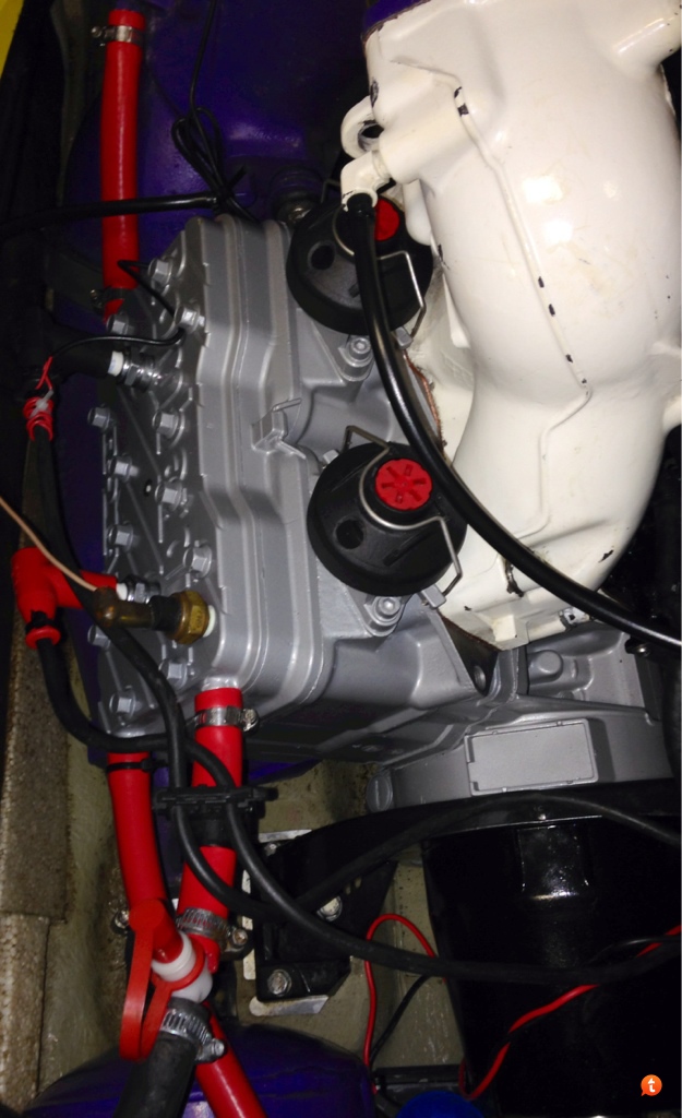

Figured I would let you guys in on my plans for the engine compartment and see what your thoughts are. Below are the pieces I had my buddy powder coat, the color is deep red. Head bolts are gloss black in the baggy you see there.
www.prismaticpowders.com/colors/PPS-4491/
That site literally has thousands of color choices with pictures of the actual color on different objects as seen in the link above. Deep red is a transparent color therefor needs a base coat to give it it's final appearance. I chose super chrome as a base coat.
I'm not a 100% sure I'm gonna use that nozzle, I mite have him strip it down and redo it black or silver...
So, with the waterbox and head red (also having him do the engine mount bracket red) I want to do the engine either black or some shade of metallic/carbon/gunmetal grey/dark grey etc..
What do you guys think? I'm thinking that the red wouldn't mix with anyting else too well..
Was considering clear braided, red braided, or black braided water lines.
Wow, your going to town on this one. Black nozzle for sure, I dont like the nozzle to look like a big pimple. Seadoo grey motor with blue and red cooling lines. Just my opinion, but I am more of a conservative, keep it original kinda of guy. Did you do the tuned pipe red as well or just the waterbox?
